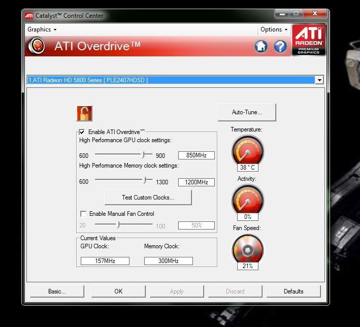

I am running crysis right now on enthusiast with full AA x8 at 50fps! amazing! Everything is running fine but like i said as soon as i reboot it will have no display and graphics fan will spin at full. The computer will post and load windows though, just no display.

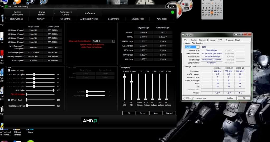

Starting to think it might be memory voltage... currently set to auto or 1.5v by default.
Upload pictures soon...
Hope this helps...
BTW i'd like to thank everyone who has helped me with this since day 1. I greatly appreciate it, beers on me if i ever meet you guys.
Just had a look and crucials site puts your ram at 1.5v so this is about right. My deafult for ddr2 is 2.1v, but I have to run at 2.2v to get mine stable across the four slots (4x1gb dimms). It could be that your board is undervolting across the 4 slots but more than likely not.
What board do you have out of interest?

Finally, what should i up my crucial ram to? You're stating 2.2v for you ddr2 so should i try 2.1v? Do i do this via bios and setting the overvoltage to 2.1v?
I wouldn't go for 2.1v through that ram, my ddr2's default is 2.1 and I overvolt by 0.1 up to 2.2v. Since your ddr3 is 1.5v as standard 2.1v would be way over the top voltage wise.
