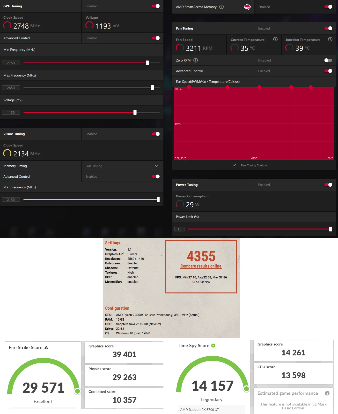

Originally whacked all the sliders to max but the driver crashed trying to load Superposition but need to test again, as you can see in the above screen I'm slowly creeping my way back up to max GPU speed in the latest benchmarks that I have run.
Voltage slider is set to 1150 but voltage seems to just lock to 1200 as soon as I set the min GPU speed to 100MHz less than the max. My gaming settings at the moment are basically the above but min GPU speed at the default 500MHz and a more suitable fan profile with zero rpm enabled.
Interested on feedback, do the scores look ok, anything about the Sapphire, 6700s or 6000 series in general worth knowing? Tips, tricks etc.

edit: 3DMark result links...
Firestrike - http://www.3dmark.com/fs/27641078
Timespy - http://www.3dmark.com/spy/27797738
