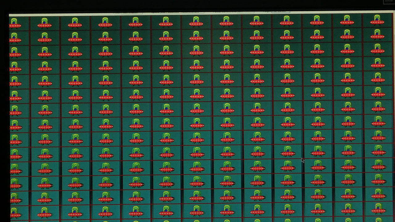

in regards to "blurring" with blur reduction mode enabled, i'm more talking about strobe cross-talk. That's related to the timing of the strobe backlight and should be evident on ANY screen which uses it to reduce motion blur. if you run a test like this one full screen with blur mode turned on, you will see at some point on the screen some ghosting images behind the moving object. the UFO should always be easy to see, and far less blurry than when you turn blur mode off, but there will be some ghosting (which is the strobe cross talk) somewhere on the screen.
Famously, on the BenQ XL2720Z blur reduction mode by default the cross talk was in the middle of the screen, which some considered problematic for gaming since thats your main point of focus. have a look at this photo from the XL2720Z by default. at the top the image is very clear. by the middle there is some ghost image/cross talk, and it gets progressively worse to the bottom. That's why BenQ then updated the firmware to allow users to adjust the strobe timing, and therefore change the position of the strobe cross talk on the screen to suit the user. you cant eliminate it compeltely, but you can move where it is most noticeable.
I'm not sure how that looks on the Eizo FG2421, it's been ages since i've had that screen with me. on the Acer XB270HU the top is very clear. by the middle of the screen there is some low cross talk /ghosting (not quite as much as in that BenQ XL2720Z example), and by the bottom it is worse still. you can't adjust the strobe timing on the XB270HU though. but i wouldn't say it was a bad implementation. not perfect, but the central area is not too bad. worth maybe testing that on your Eizo to see where the cross talk manifests itself
