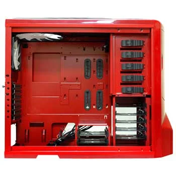

I'm also trying to figure out my placement in my phantom full tower (original). The HDD cages are riveted in so I think I will have to have it sucking in the cpu exhaust at the back (or I could get an AIO for the cpu and exhaust that out the roof).
The alternative is a bit unorthodox, and would involve using the side panel 120mm fan mounts that cool the HDD bays, and then exhausting those out the other side. Going 3D with my cooling!
I have the same case full tower phantom. I drilled out the rivets with a dremel, the cages all come out really easily. If you want to put them back in it would only takes some bolts/nuts/washers.
