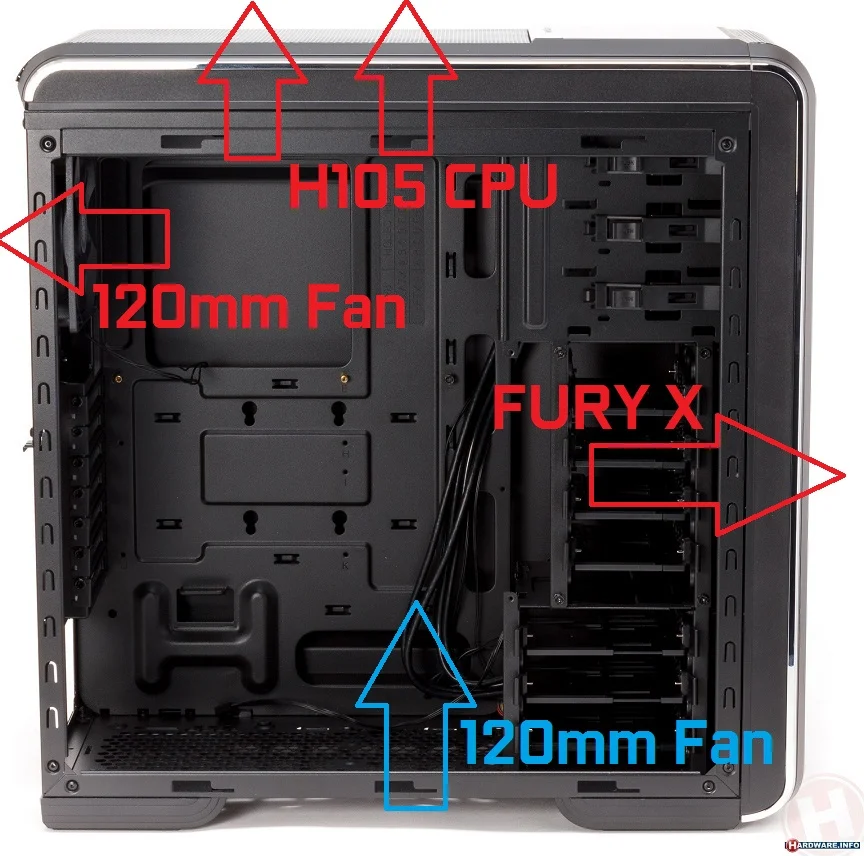

Would this cooling setup work?

I have similar, but i will just install the Fury X at the back, and put intake fans at the lower front and the bottom
I'd reverse that top left 120 to pull air IN to the case, not exhausting. The hot air from the fury has already exited, use the top 120 to supply fresh air to the top rad.
The way you have it seems like there will be a lot of pressure, and not enough cool air.
Have the H105 as intakes (assuming you have a dust filter at the top)
Have the 120mm fan at the back as your exhaust, if you can fit a 140mm do that.
Have the FuryX as intakes at the front (assuming that you have a dust filter)
Don't need to have a 120mm intake at the bottom, serves no purpose.
Just my 2p
