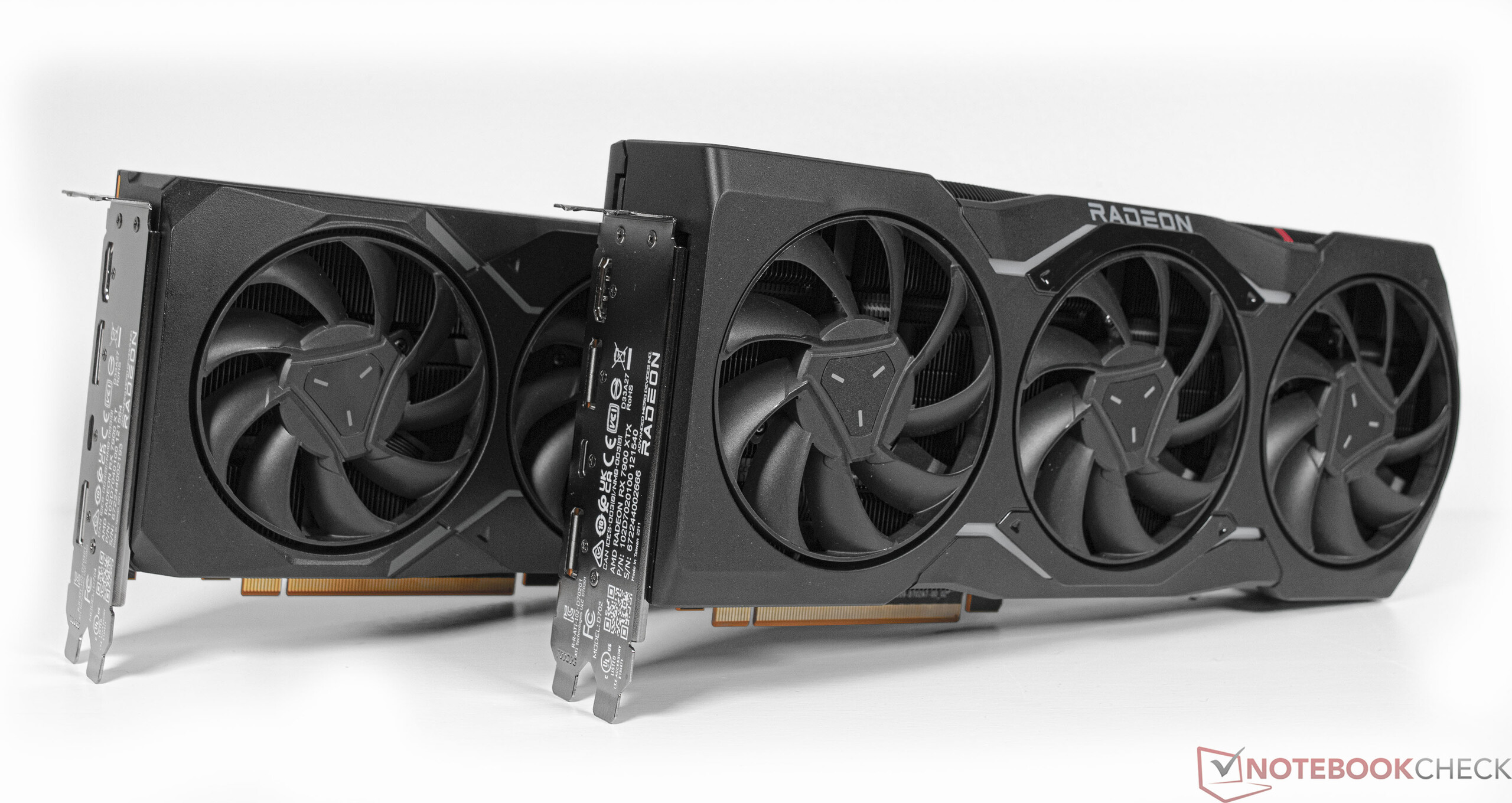

Fair enough.Junction temperature is the highest temperature of a semiconductor (GPU hot spot, not entire package) on a card.
Don't confuse junction temperature with GPU temperature, two very different things and pretty much all cards will reach 100c plus on junction/VRM/hotspot, but typically a card won't sit and remain at 110c limit it will be brief or not at all in normal use, but of course if the cooler is faulty (lack of water in vapor chamber) then the card is not able to remove heat effectively or quickly enough from the GPU because vapor chamber is not working, at which point the card see's temps at 110c quickly and not reducing so throttles hard. A card with a working vapor chamber should only be reaching 110c is stressed heavily and it should still take some time. In regular gaming scenario it should not hit 110c or if it does will be short and/or a minor throttle to within spec will solve it.
