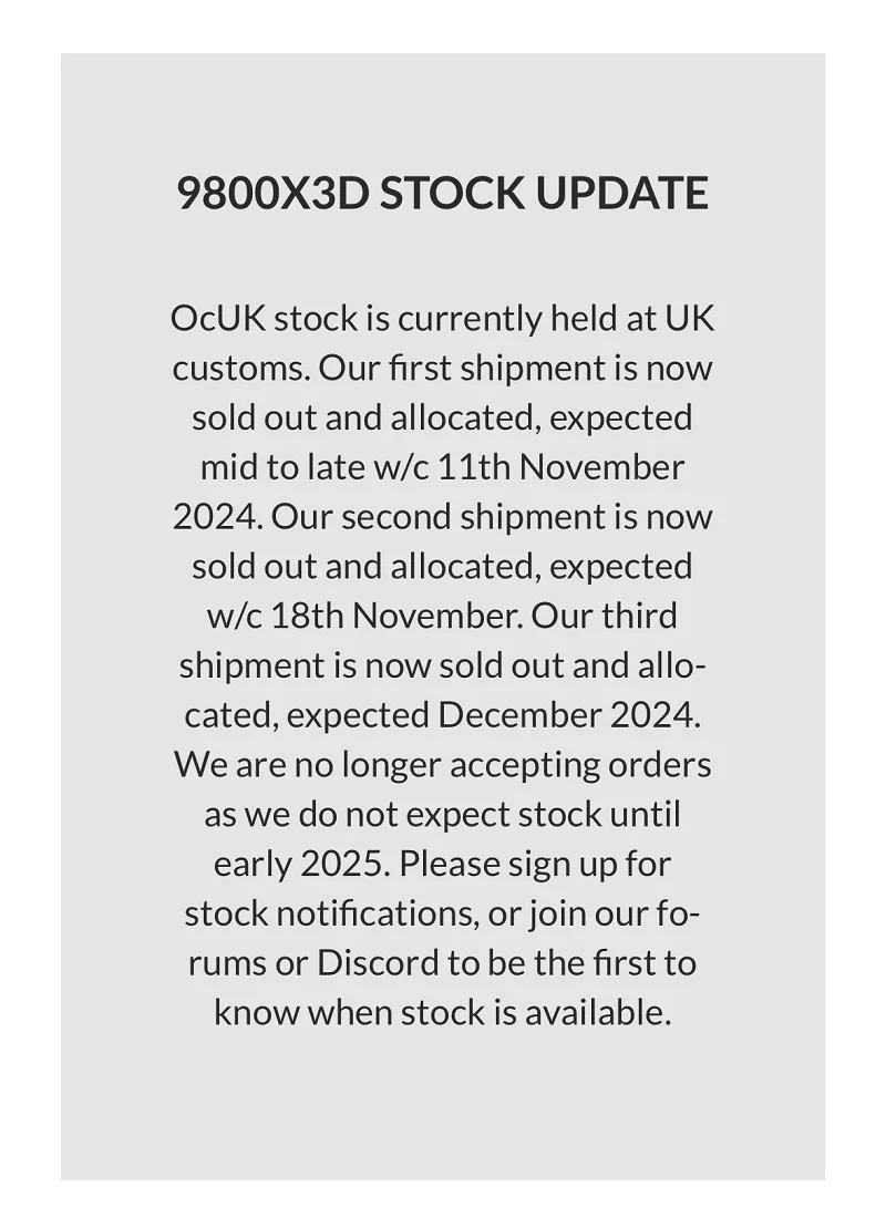

I posted this on the other 9800X3D thread (taken from the OCUK site)..
I don’t care how often Steve or any other tech bro tell me “real world” doesn’t count. I’m not wasting money on a new CPU if it isn’t giving me real world performance improvement TODAY.
Edit: before someone tries to tell me “you obviously don’t get it”. I do get it, lower settings shows CPU overhead. But for real world it’s far better to get on an upgrade cycle every 3 or preferably 4 generations. That way the benefits are actually realised rather n real world gaming.
