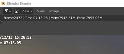

10 runs of Cinebench R20 back to back then straight into https://gooseberry.blender.org/gooseberry-production-benchmark-file/ - if it passes that it's stable - although it'll prob highlight cooling issues before stability :)

You need Blender installed. Then you open the file, click render from the top or right.
Max temp for TR3 is 95c. The old 68c was the temp PBO tries to maintain on old gen thread ripper - it's no longer relevant.
Nice benchmark. I got a max of 4.5GHz with an overall average (by eye) of 3.93GHz all-core. Rendered in 7 mins 13 seconds (while doing other stuff, I was using it to test temps primarily), which is mighty impressive considering the Intel Xeon 56 core takes more than double that time. It hit a max of 83oC peak momentarily, but averaged 78oC (on air). @AMDPower I'll be interested to see how your Dark Rock Pro compares to my Noctua - I was undecided between them.
You can grab a portable version of Blender here, just unpack it and run the blender.exe and then open the benchmark file and hit F12 to render.
thanks gents for the help. Ran blender and everything seems ok, no crashes.
