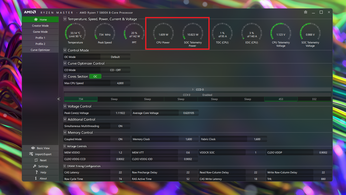

Dunno mate, literally just randomly taken now, with 6 Chrome tabs, Spotify playing ABBA Dancing Queen, Thunderbird Email Client open and i'm in the Discord Voice Channel.
What's that about 12 watts? less than 2 for the CPU.
I haven't even tweeked it, updated my BIOS last night and need to reapply my settings.
I didn't know your 5800x was a 7950x suddenly though. You only have to Google 7950x to see multiple reviews showing idle is up around 25-30w.
Note my 5950x idles at best at 28w no matter what I do with it.
Admittedly i don't own a Ryzen 700 series, i would not have expected the idle or low power state to double and more over my older generation.
I googled it and found an Ars Techica claiming the idle power consumption is 20 to 30 watts..... yes that is very very high, in the same line they make the point that the 13900K Idles at below 10 watts, they also go on to say that this is better than the previous generation, IE the 5000 series, so my CPU is supposed to idle at what, 40 -50 Watts? This is where i start to get a little suspect of Ars Technica. That's half my MT Cinebench run.
I've done a lot of tweaking to this CPU over the years using HWInfo64 to monitor voltages, Temperatures and power consumption to see the effect of my tweaking, the screenshot i put up is what i expected, its also running at 33c with all my fans in a 0 RPM state, including the CPU cooler.
I might have a good chip, but i don't see how that makes a difference from about 10 to 40 or more?

It's PPT you should be looking at for total CPU power consumption, 20% of 142w is 28.4w which looks normal for a 5800x under low load.
