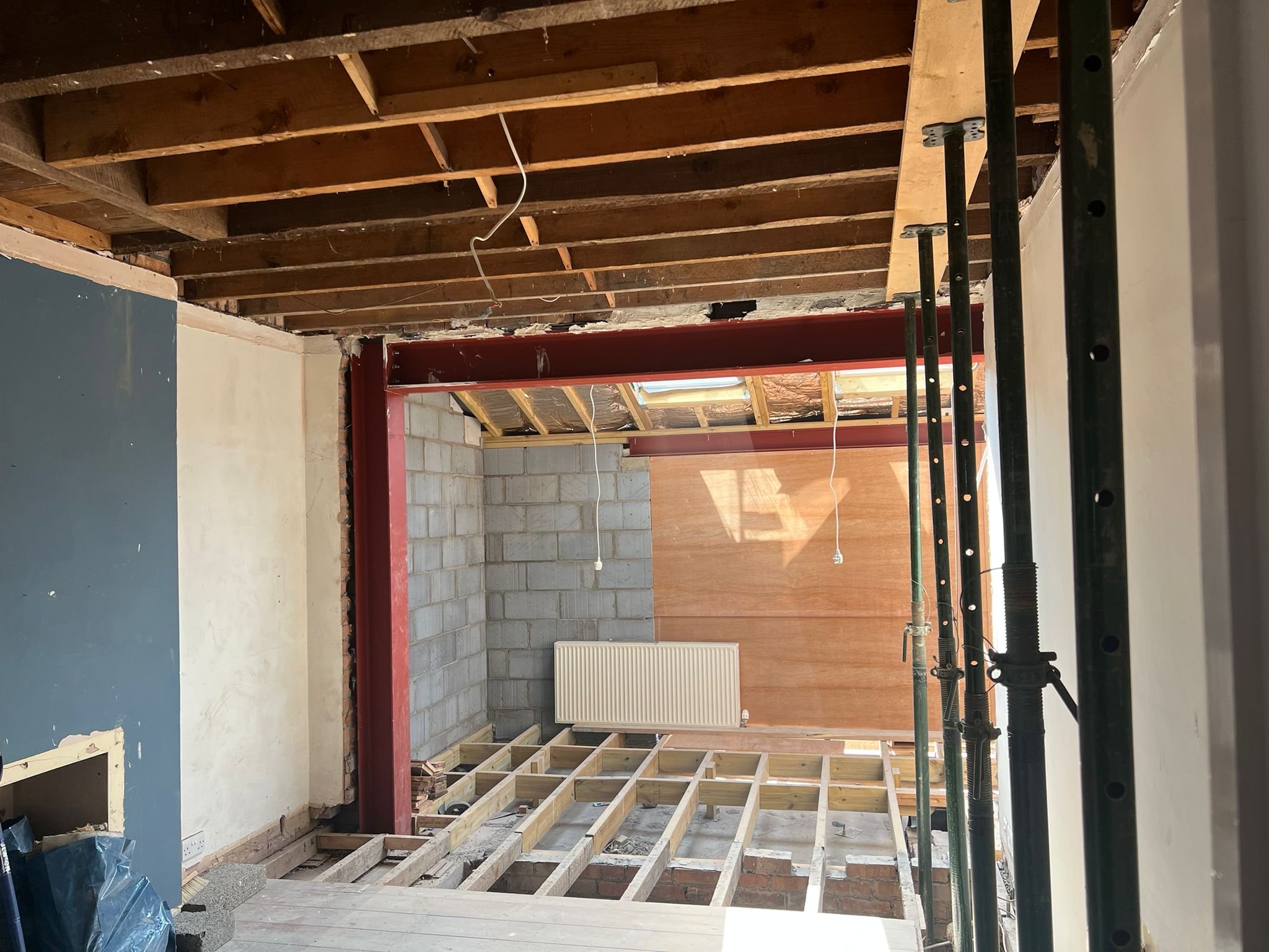

End of week 6, and a fair bit of progress has been made.
Here's the dining room after the plywood partition came down between the new bit and the old bit. The plugs hanging down are the Velux windows.
This is the old kitchen area, minus the oven, and cabinets that were on that partition wall. Most of that wall came down later in the week.
Gap where the bi-folds will go.
Here's a dodgy iPhone panoramic of the space after the partition wall came down. It'll be partly built up again with stud walling to create the utility room, but most of it is staying down for good.
You can see the new steel in place that forms part of the T-shape as well. That got drilled on site with a mag drill. Very cool.
By the end of the week, we've had first fix lighting and switches installed, created a channel in the concrete floor for the new waste pipe, and filled some holes in the solid flooring with concrete.
We've also discovered a leak in our shower tray is coming down in to part of the room, so have to re-seal the tray, and consider ourselves lucky that we discovered it at this point!!!
Next week some more first fix stuff goes in, and then that chimney breast you can see will come out, along with the one in the bedroom above, and the attic.
Then we'll be looking at putting flooring down and plasterboarding, maybe even some plaster. I guess we'll see how quickly it moves along.
