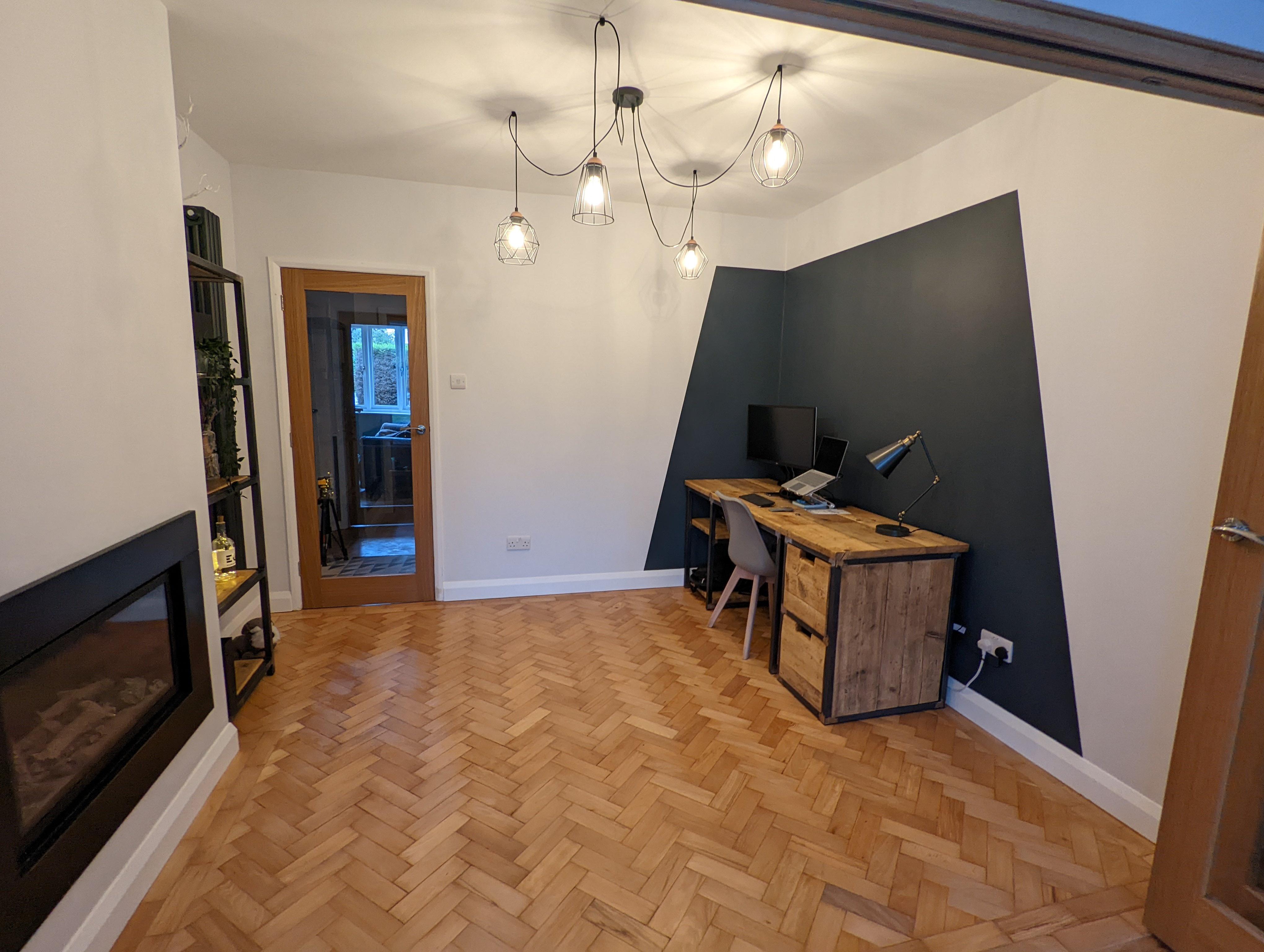

@Buffman, is this an electric fire? How good/realistic does it look when running? I’m considering getting one for the snug for ambience only (i.e. not heat), as part of a refit to the room (which used to be a kitchen - needs completely gutting and starting again).
Some great looking extensions here!
No, mines a gazco studio 1 gas fire with a granite surround.
I find electric fires look incredibly fake.
Thanks for replying. That is the concern! I was hoping to find a realistic one but even the water vapour ones I’ve seen leave plenty to be desired. It’s looking like a fire-free snug, sadly.
