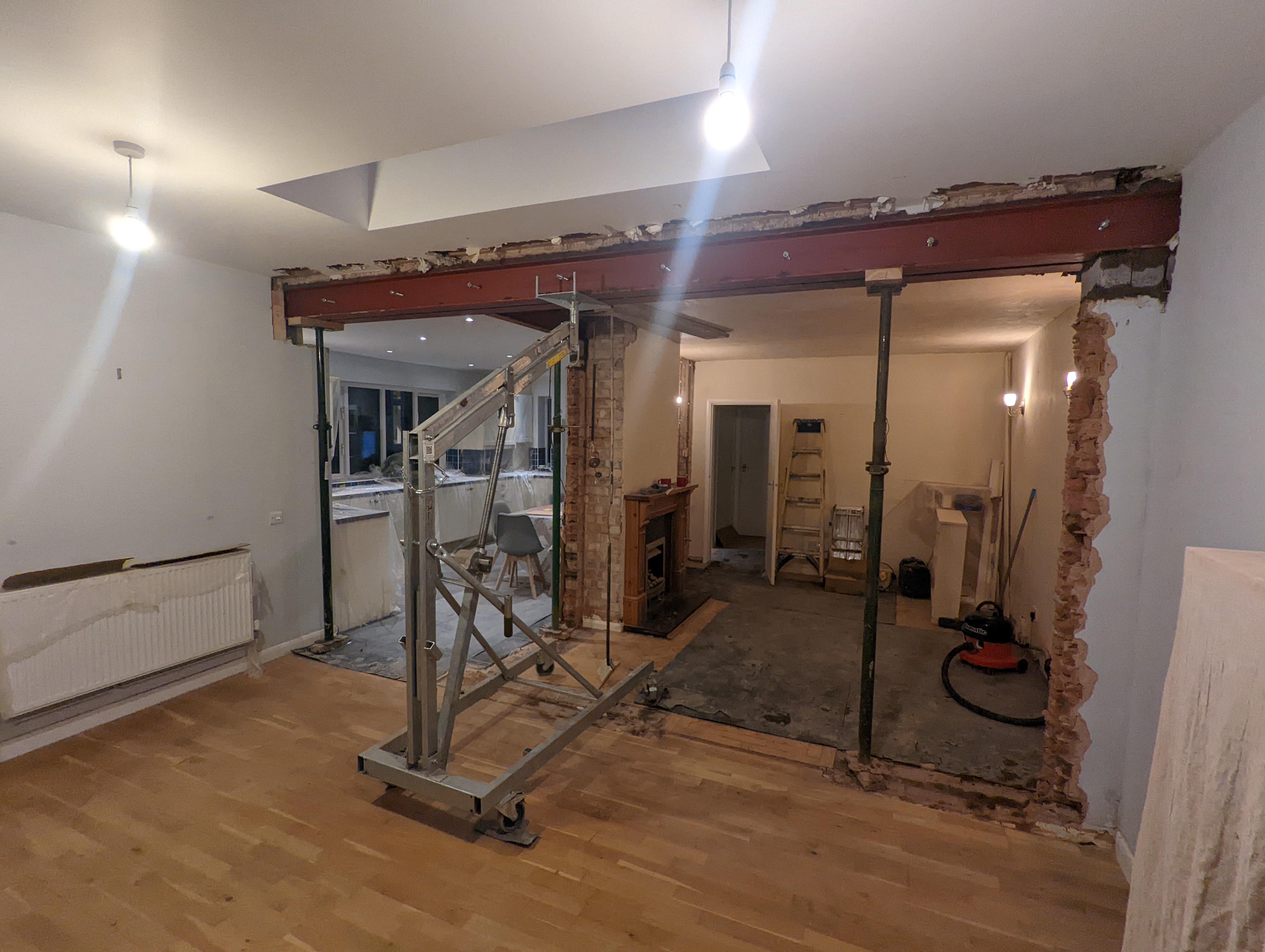

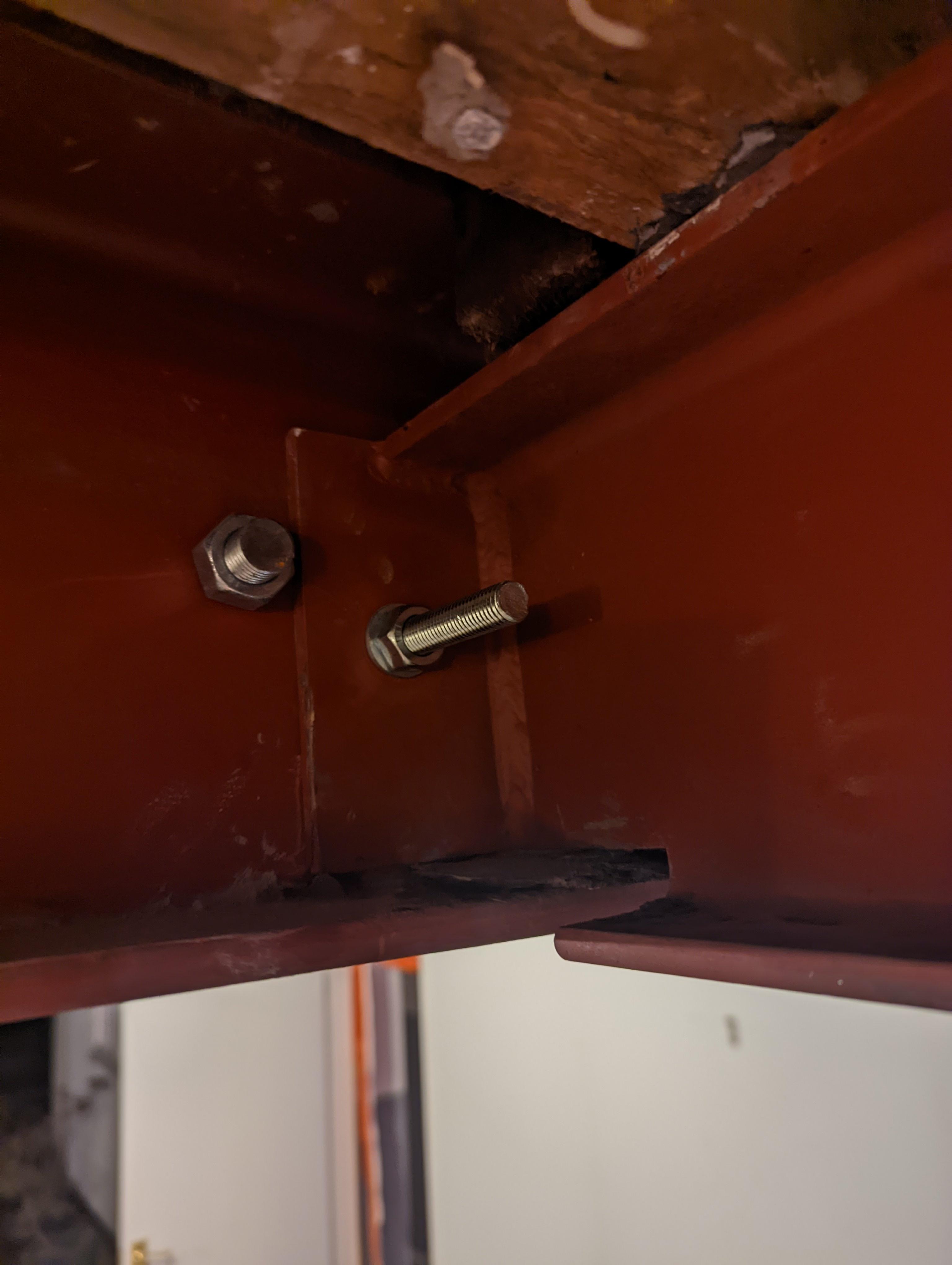

Looks good! 2 bolts for that span does seem a bit mad. My structural engineer specced 4 but then my builder got it wrong and put 2 in.... Oh well not too much of a span for me and structural engineer said it would be OK.

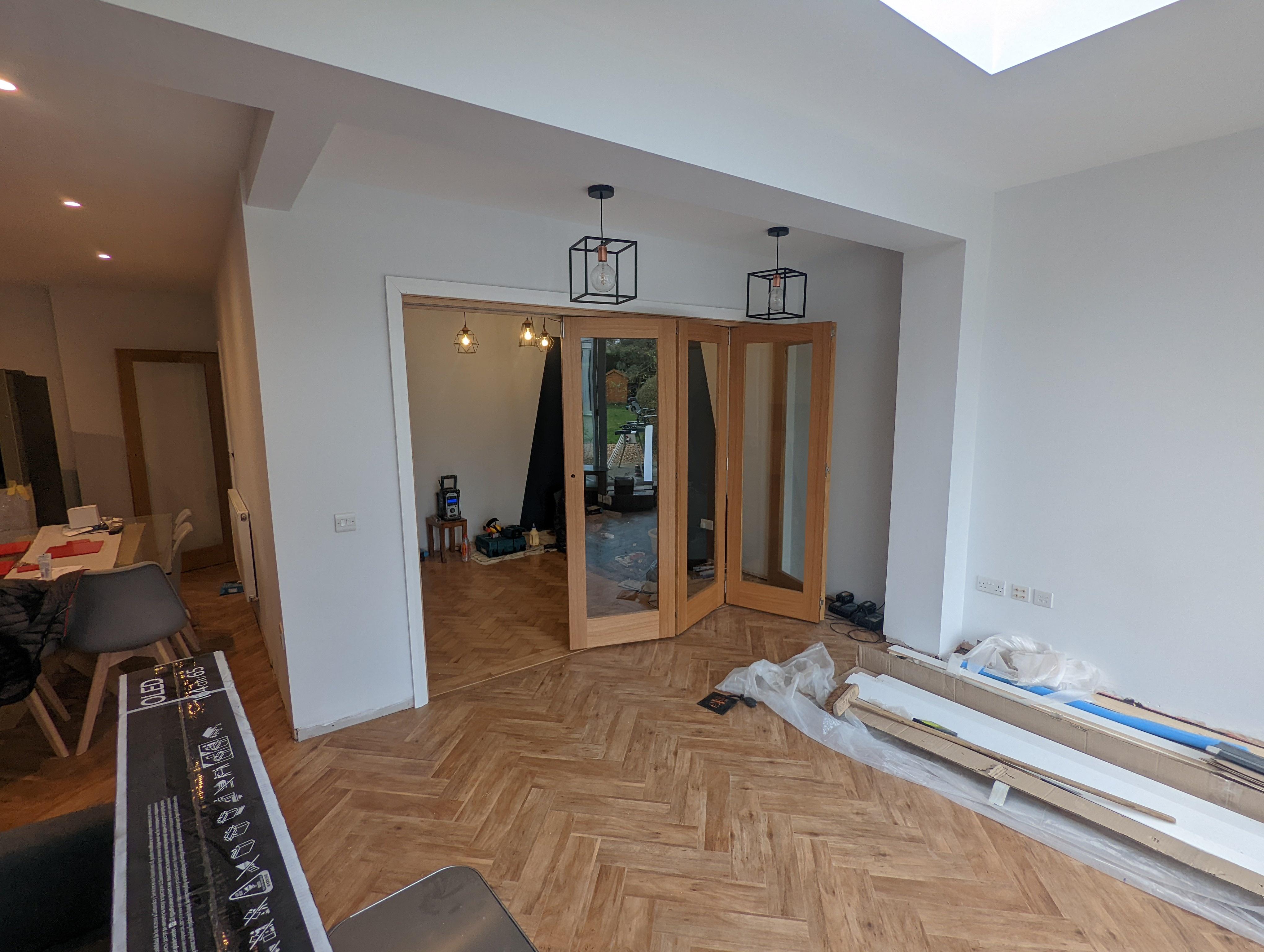

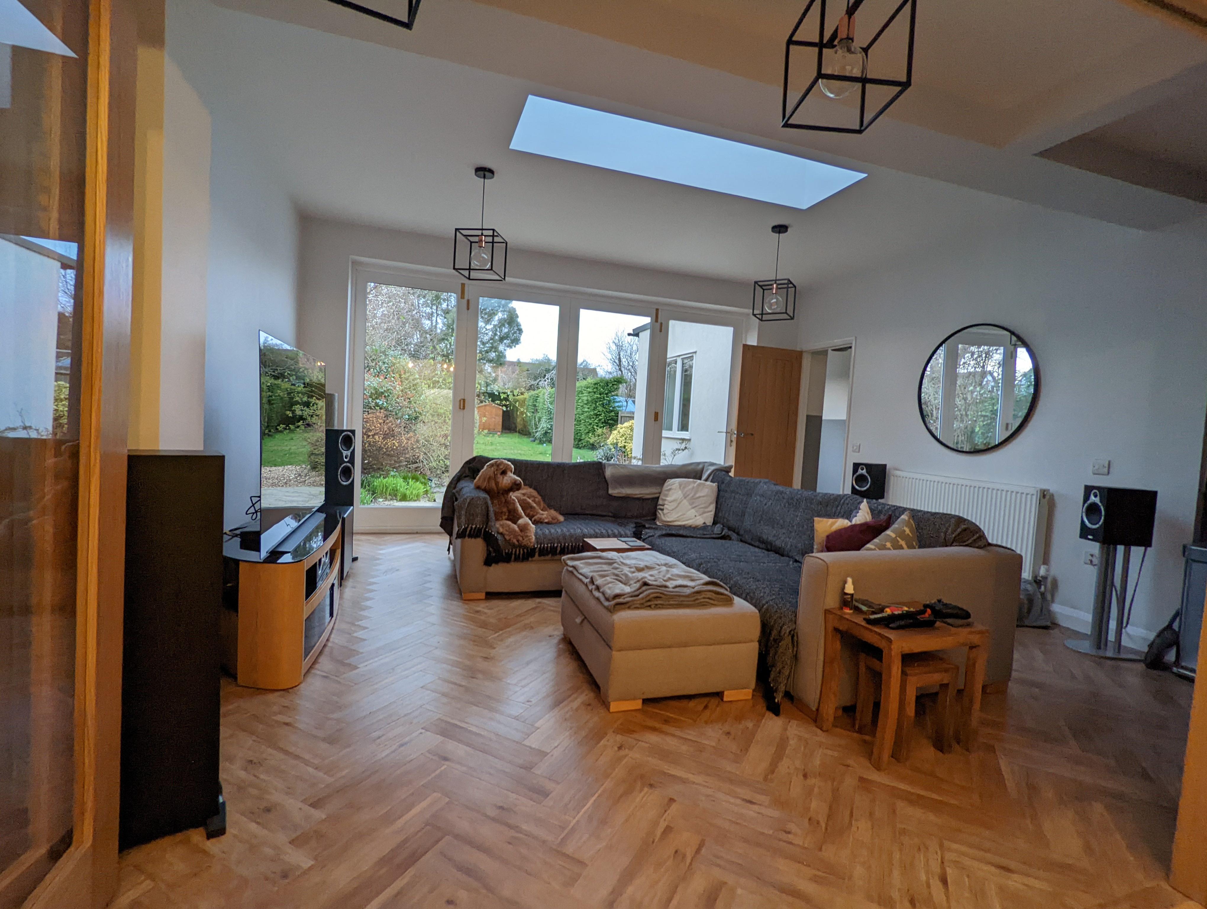

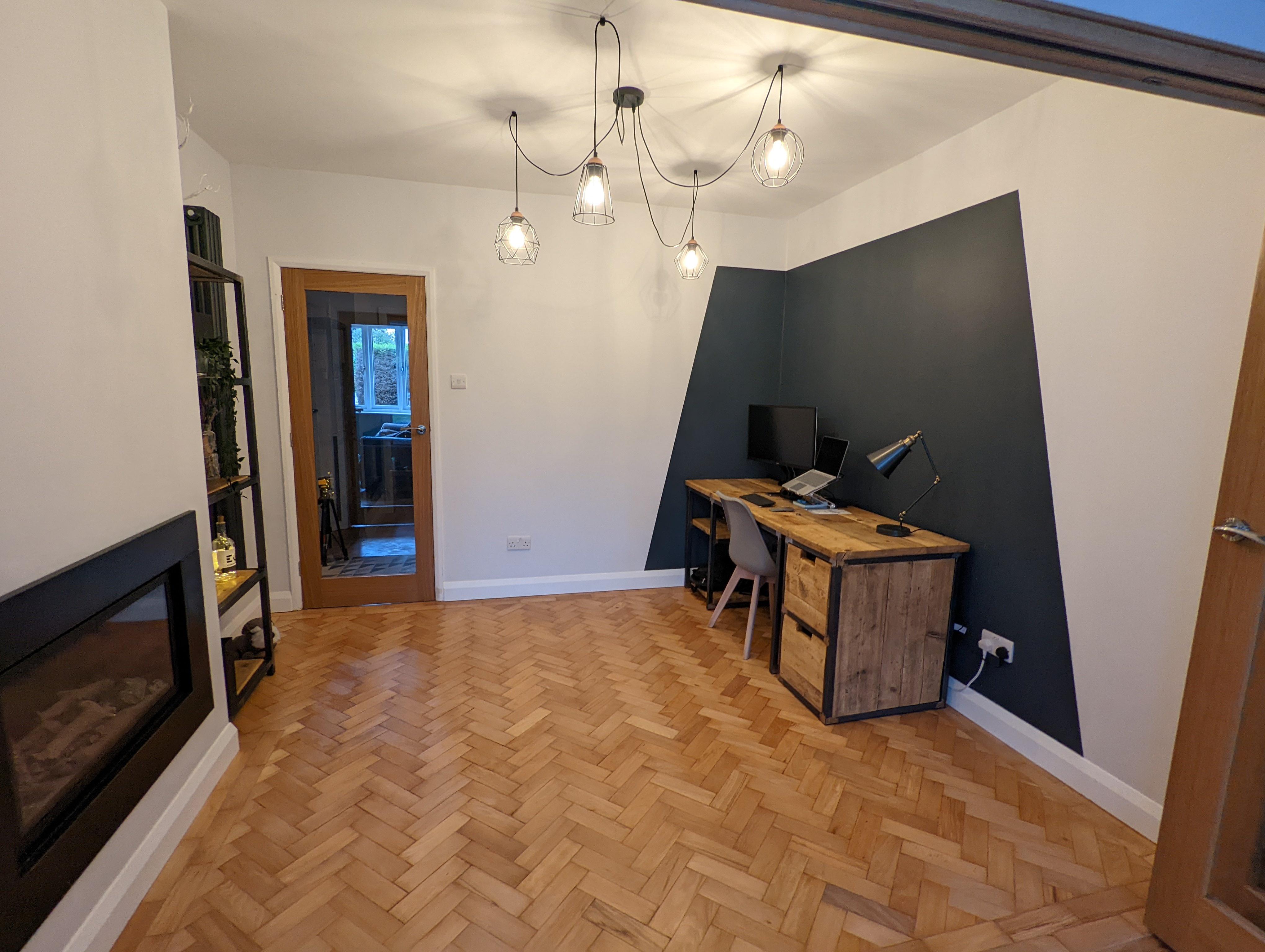

Some pics below if interested.
Office space made smaller
do you sleep well at night?
i don't know how well i would, knowing that the beam is at half its intended strength :cry:
Its what they call in engineering redundancy in a connection. I'm not concerned and there's only a 1.3m or so span into a fireplace.
The engineer confirmed it was suitable so hey. I've seen worse for sure.
That’s lovely. Nice and airy. Looks like you had plenty of garden to extend in to too!

Looking good so far, I do like the idea of the LEDs on the steels
North Somerset.
I have started looking at LED strips and intumescent paint for the steels. Quite an exciting prospect. Wouldn’t have thought of it before this thread!
I would have thought they would have built the extension in line with the side of the property so there would be no pillars between the old property and new extension but I suppose it comes down to money. Still looks good though.
May not be possible due to the structure and the size of the steels required (even if it could be done) would also be (I'm assuming) extremely expensive
