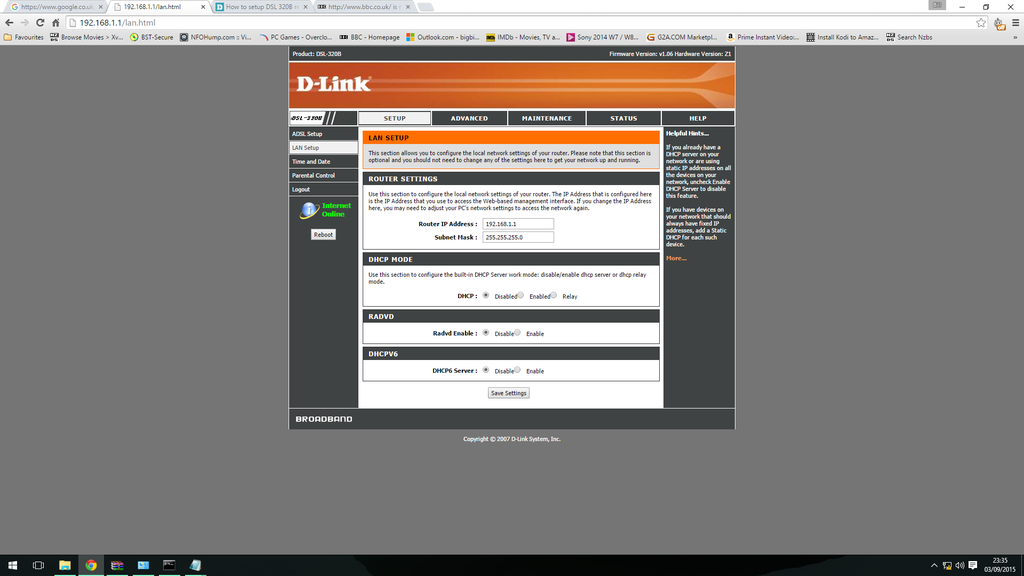

Very close to giving up trying to get my D-link modem work with this ASUS , another 2 hours of my life wasted tonight
Followed instructions above, only info I did not have was to what details to put for WAN IP.
Anyway, unless anyone can see any setting Ive got wrong (photos below), then Im out !!

Set WAN connection Type on router @automatic ip
no authentication, as your modem will be doing it.
If the modem is doing all the authenticating (username, password etc) do I actually need to set it up us a normal PPoA/PPoE connection (not 'bridge') ?

On the ASUS Router side I would give it a factory reset as all your settings are a mess and then set it up again but this time you need to enable one of your LAN ports as a WAN port, if I remember rightly it was somewhere in the Dual WAN vicinity but I do not have one any more to advise on that part.
