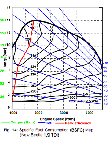

[different engines on 3 series 328 vs 340 obviously have different optimal peak efficiency curves.
I had though this was an interesting read on a vag engine where folks have a power map,
visualizing how you make the same power with different rpm and fuel consumption
