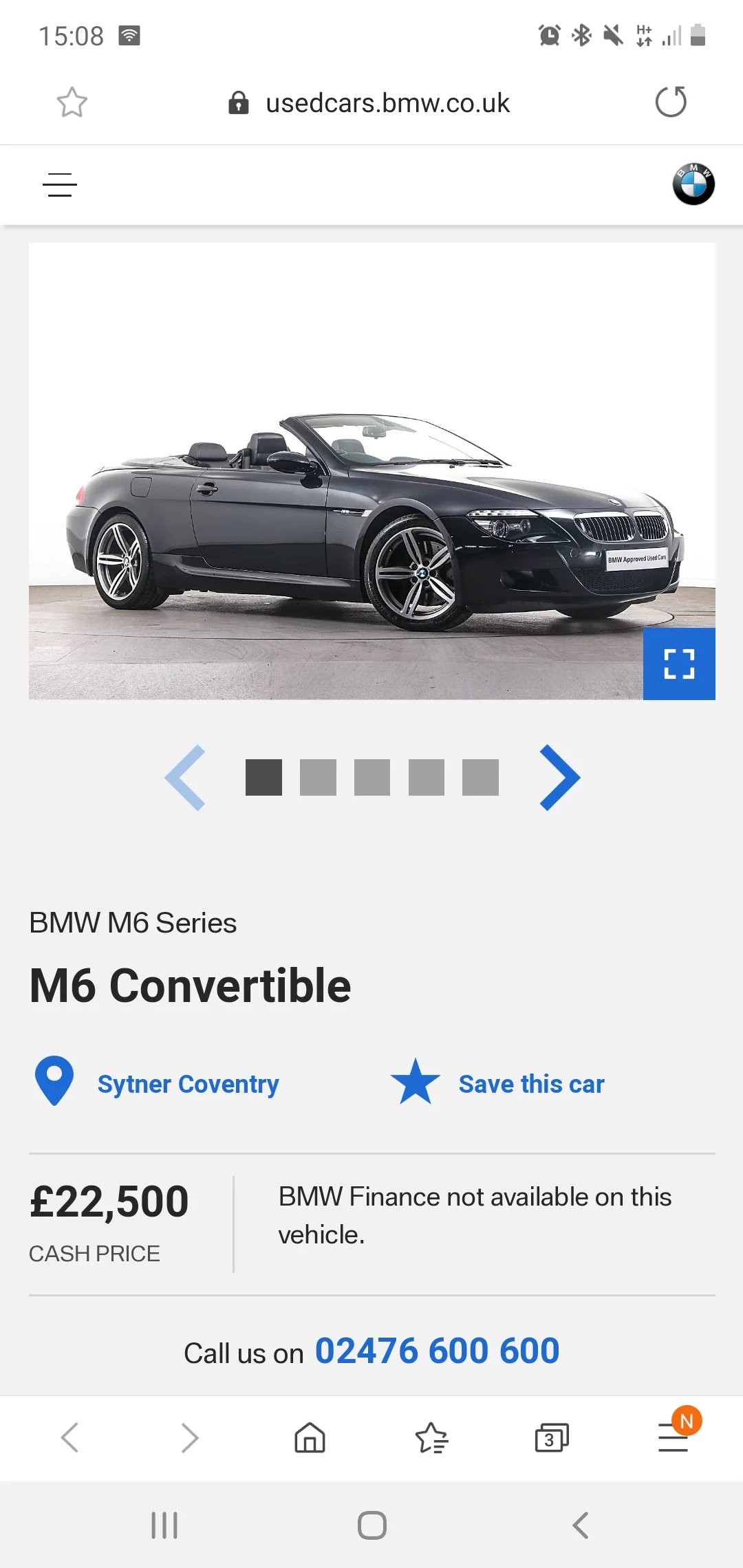

if you're looking at 60k ones whats the battery situation on them, warranty, replacements etc? I would love one as I love the look of them but I bought a M6 V10 instead for long term keeps :D
8 year warranty but I should think not too expensive to replace anyway.
I had an m6 V8 at the same time but did not like it too much

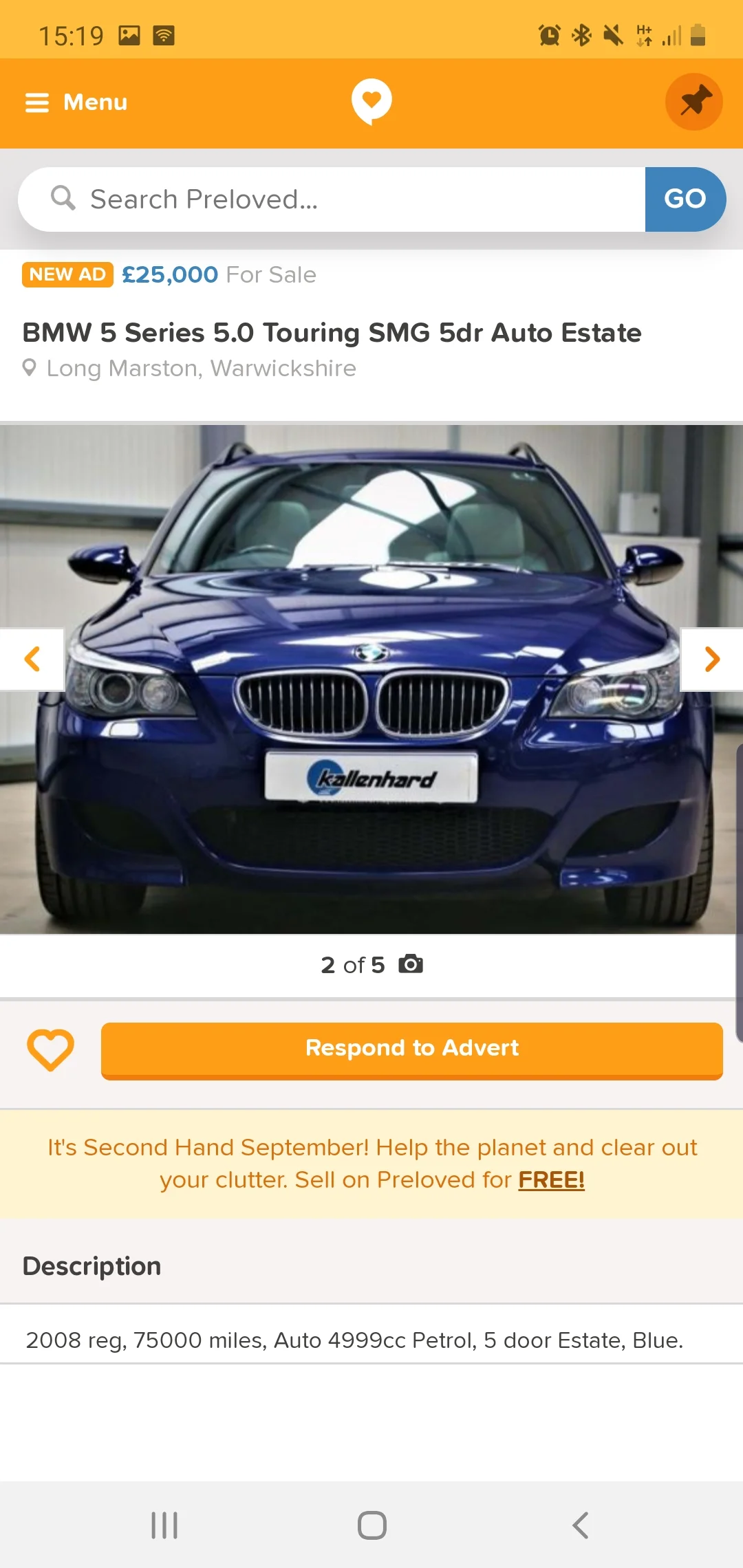

Smart answer is to spend half that on an appreciating V10, an investment in the last of a breed whilst still possible.
Something like this but better spec, lower mileage etc.
I'd love to throw an E61 M5 in a shed for retirement.
Now that bmw have shifted most of the stock prices are climbing a little.
you can still get a decent one for £45k which in my view is a bargain.
