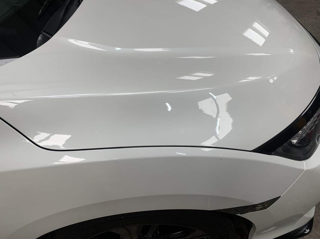

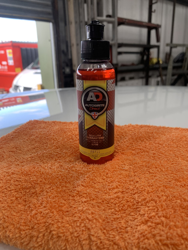

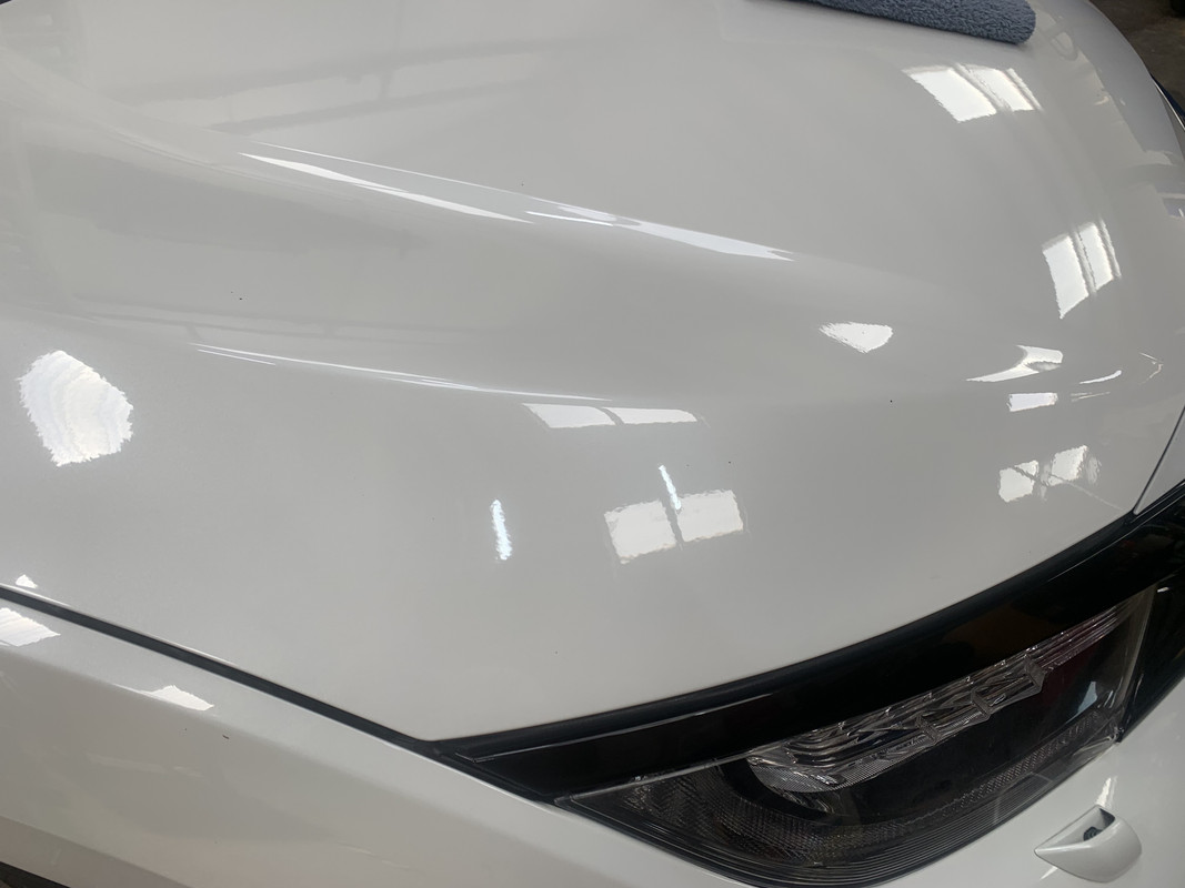

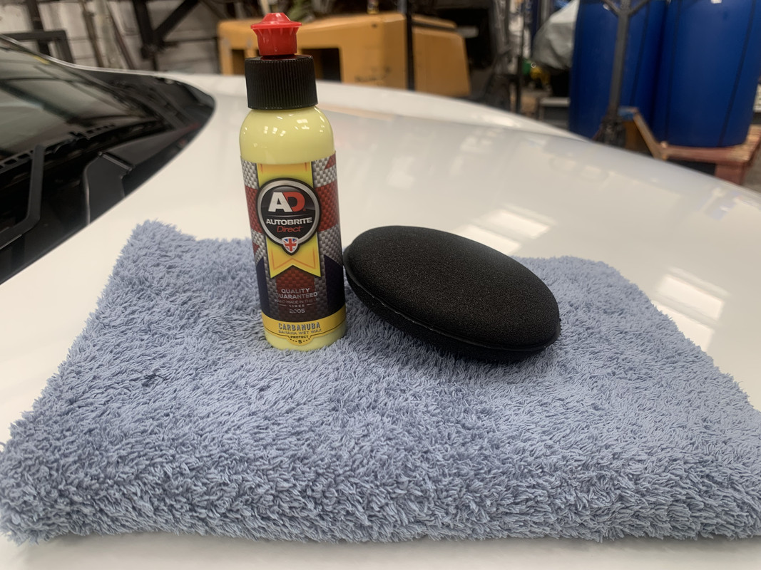

So I had another busy day today, after cleaning and decontaminating the car yesterday it was time to seal and wax the car.
Weapons of choice we’re Autobrite Abyss sealant and Autobrite Carbanuba wax.
Extremely economical I mean seriously that little bottle is going to last me years. Makes the paintwork very glossy too.
Then on to the wax. Normally I would be using my trusty Collinite but today I decided to try out the wax from the Autobrite sample pack.
Again made the paintwork super smooth and glossy. Good stuff.

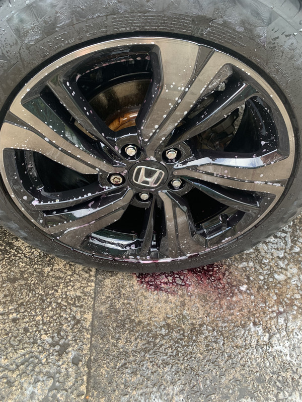

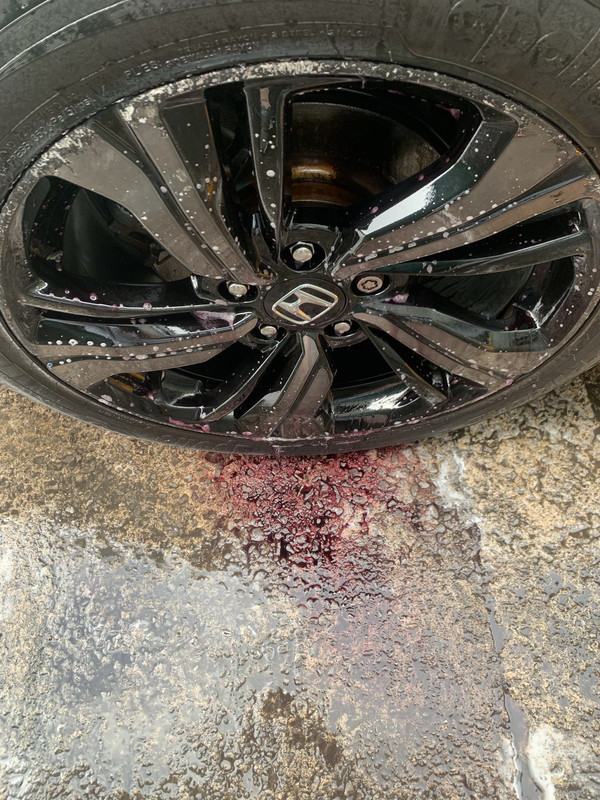

Bilt Hamber Auto wheel is some seriously good stuff.
I cleaned this wheel yesterday using some other wheel cleaner, then today I decided to use some Bilt Hamber and this is what happened.
