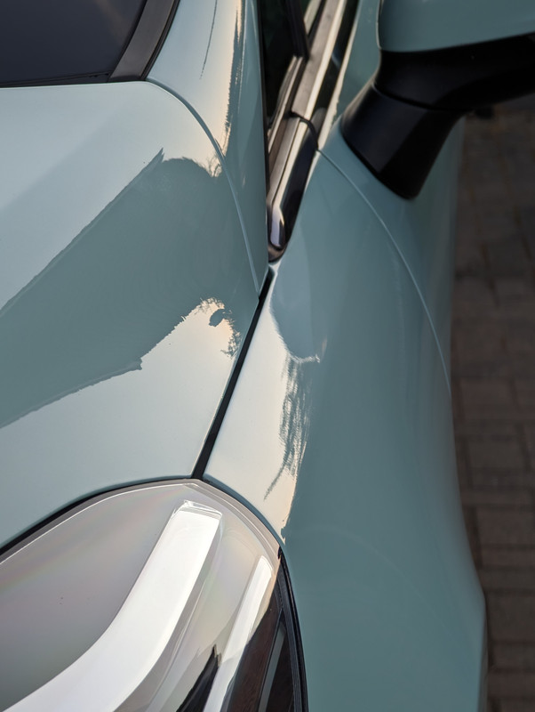

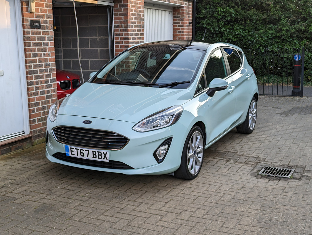

Did a full machine polish on the other half's fiesta at the weekend - what a job it was in the sun.
About 5 hours work, and that was with the clay bar and decontamination been done a couple of weeks before.
  1. Snow foam (for above reason)
  2. Wash (inc Surfex HD for wheels & tyres)
  3. Dry
  4. Single stage cut & finish with Scholl Concepts S20 Black & Lake Country Manufacturing HDO Blue Foam pad (killer combo IMO - amazing cutting ability for a single stage). Did the headlights with it too and they came up REALLY well.
  5. Panel wipe
  6. Finished with Rupes Uno Advanced and Koch Chemie Purple pad
  7. Tyre dressing with poor boy natural look to finish it off.
