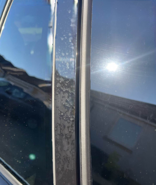

Looks like acid etching from the rain to me, or calcium (limescale).
I’ve had it on all cars with black trim.
Does it disappear when you run water over it?
Not sure if it disappears when water is ran over it, will check, cheers.
Strange, none of the other Shadowline trim on the car has this on it :confused:

Clever detailing gurus............any idea what this is and how I can get rid of it? G21 M340i nearside rear shadowline door/window trim. Looks like chemical damage to me, maybe? Snow foam or wash etc allowed to bake on for longer than it should?
I use AG Polar Blast, Polar Wash and then usually finish off with Koch Chemie Protector Wax. I'm usually very careful about application and don't leave any of the products to dwell too long. And I always towel dry the car when I'm done, including those black trim parts. I've tried 3M Finesse-It on it and it didn't do much to remove it.
Try using water spot remover to remove the mineral deposits
I have some Isopropyl rubbing alcohol here, would that help or cause further damage?
I wouldn’t personally, as I’m not confident on the problem. If the plastic has chemical damage, IPA may dry it out further.
I’d be surprised if a good mechanical polish can’t get it out. Doing it by hand may not be enough though
Cheers, guys. I'll give it a go with a small DA polisher and see what happens.
Anyone know if that piece of trim can be removed and replaced, or is it an integral part of the door/window frame?

Sometimes a bit of heat can resolve that , failing that I've found quick detail spray removes/hides it.

[edit] - Ahh, I missed the 3M Finesse-It application..
My go to max cut compound by hand is the G3 Paint Renovator, it seems to do a stellar job at cutting by hand, some of the compounds are hopeless unless machine polishing, but from your description it sounds more than a mere surface stain.. You will need to slowly go more abrasive, even wet sanded, before the worse case of lacquer damage, in which case, a wrap might be cheaper..
If it's gloss black plastic trim, maybe Plast-Rx is worth a shot, that's going to cut and polish nicely..
