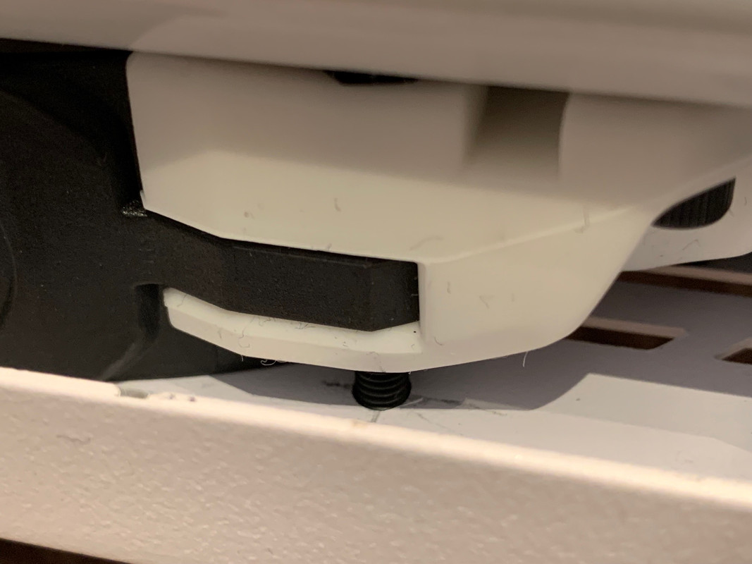

Ok, solved the "hold down the rad" conundrum, quite simple in the end. Yes, thanks to Mr.Drill again (my case feels like it's more holes than metal right now... :) )
Have drilled a few holes in the base and fed through some screws which engage with the Varder fan rubber mount holes and into the fan's "chassis". So this connects the radiator into the floor, and holds it against the brackets I installed previously. It's so minimal you can hardly see it, but it works well I think.
Yep wouldn't even notice those
The pencil marks are more visible lol
Really coming together now
Cant wait to see more pictures as it progresses

Hi all, I am considering ways of fixing a push pull 60mm radiator directly to the base surface of a Lian Li 011D XL. Ie, without the dedicated fan mounting bracket. I know it’s probably foolish, so I’m only considering it….
Ideally it would be done in a non-destructive way but this doesn’t seem feasible. I don’t think there are products out there than can do this.
If I were to mechanically fix it, this would mean drilling holes in the chassis, either to line up with the fan hole spacings, or, to fit some form of bracket to restrain the rad and fans combo. But again, am unaware of any products that can do this.
This is all because I stubbornly wanted to use 60mm push pull in the base beneath a gpu riser. I know it’s probably too much of a long shot and I should just use a 45mm rad on the Lian Li dedicated fan mounting frame that inserts into the bottom of the chassis.
However I thought I might pick your brains before I resign myself to the inevitable! Cheers guys :)
