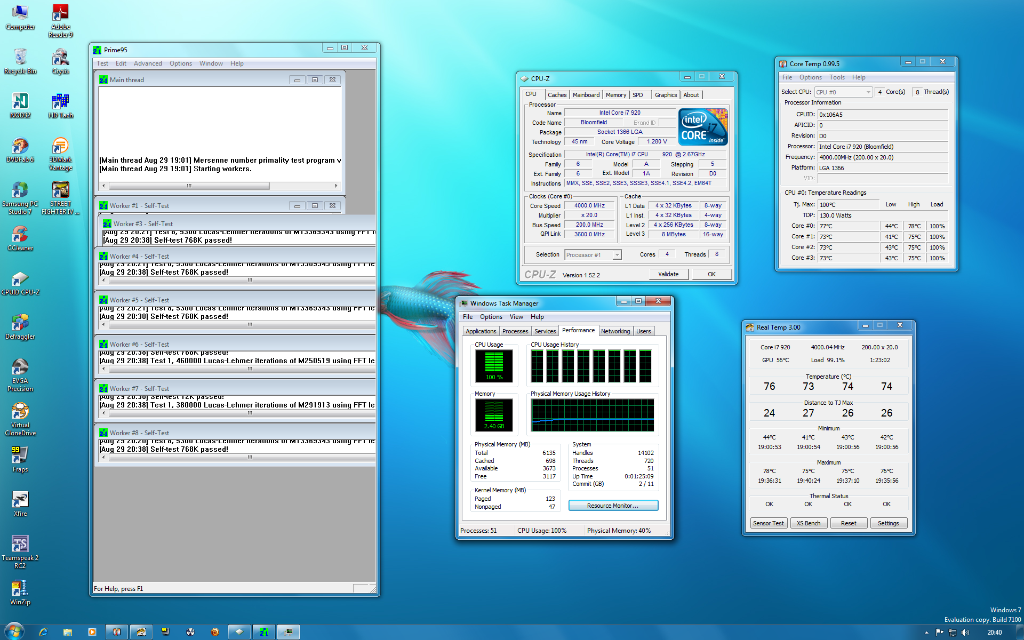

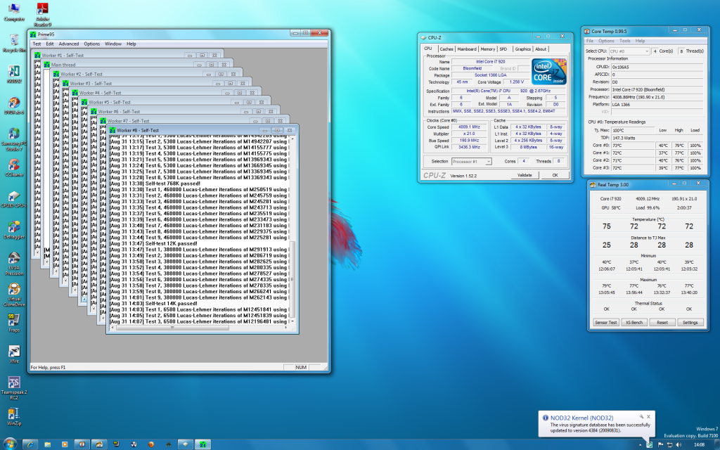

You seem to have some really nice temps,May i ask what case you using? how loud is the hydro with push /pull fans,what type fans and rpm are they set to?
also can you post screenie with prime for longer? i assume you've got ht and turbo on?
regards zia
HT is on, Turbo is on.
here is 2 hour prime95 blend test, 26c ambient, 29c case temp.
