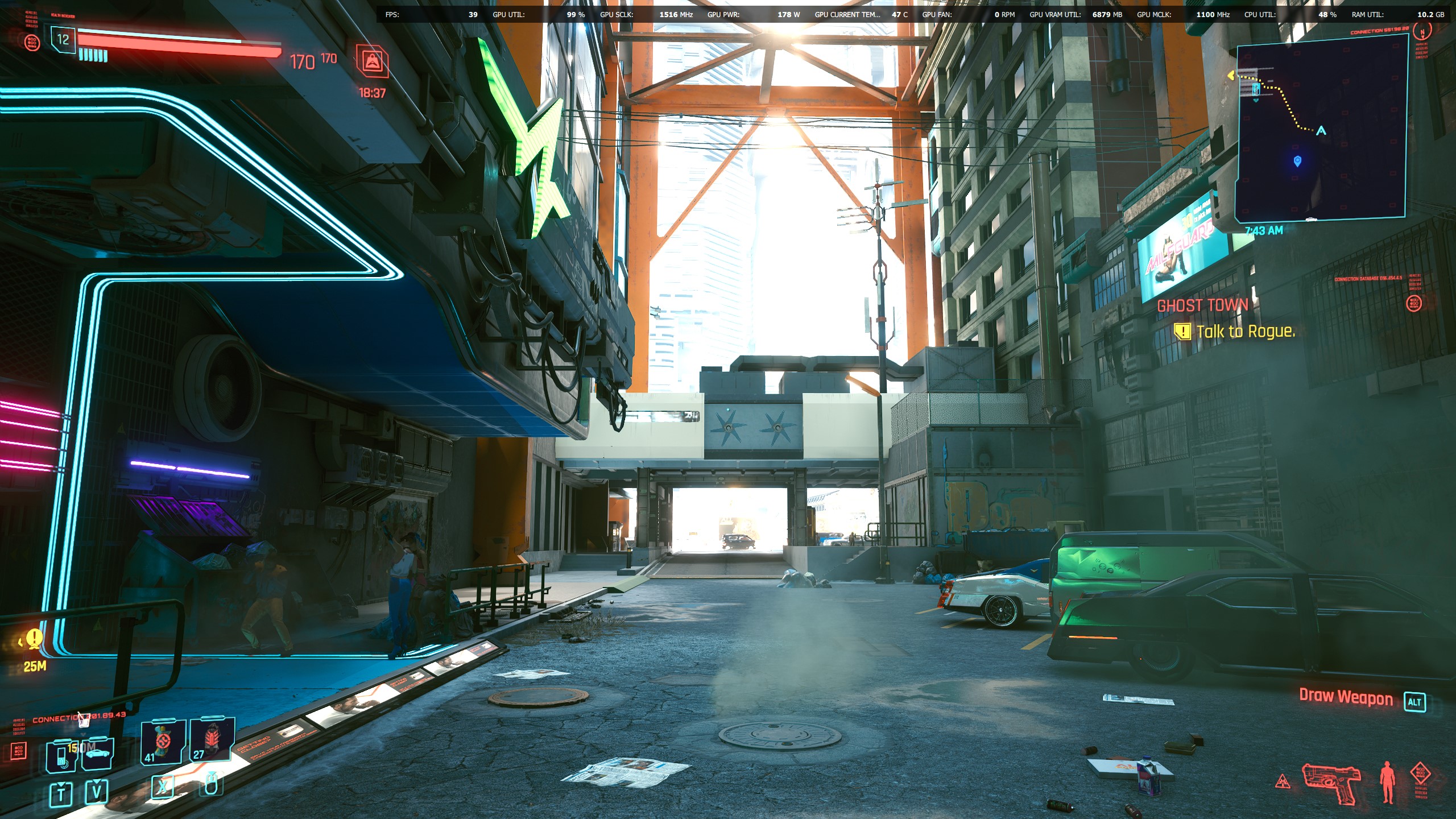

I have settled on just this
EDIT: 150 is too high here too. driving around a while results in missing assets
[Streaming]
DistanceBoost = 150.000000
before/afterin the spoiler this is outside afterlife
I don't know why but default for me is terrible. I find it hard to believe other people are seeing to the extent I'm seeing in game so must be just my system or how the engine is detecting it.
With the streaming distance if you push it too far there the balance gets messed up and stuff disappear s completely as it has some sort of base priority regardless of distance.
[Streaming]
[Streaming]
