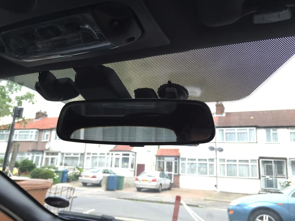

Not that intrusive really.
I do like how this dash cam is not intrusive at all in the cab ! :) :cool:
