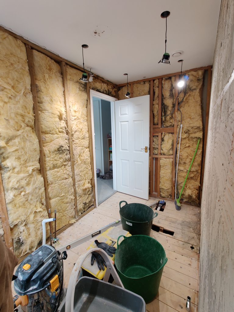

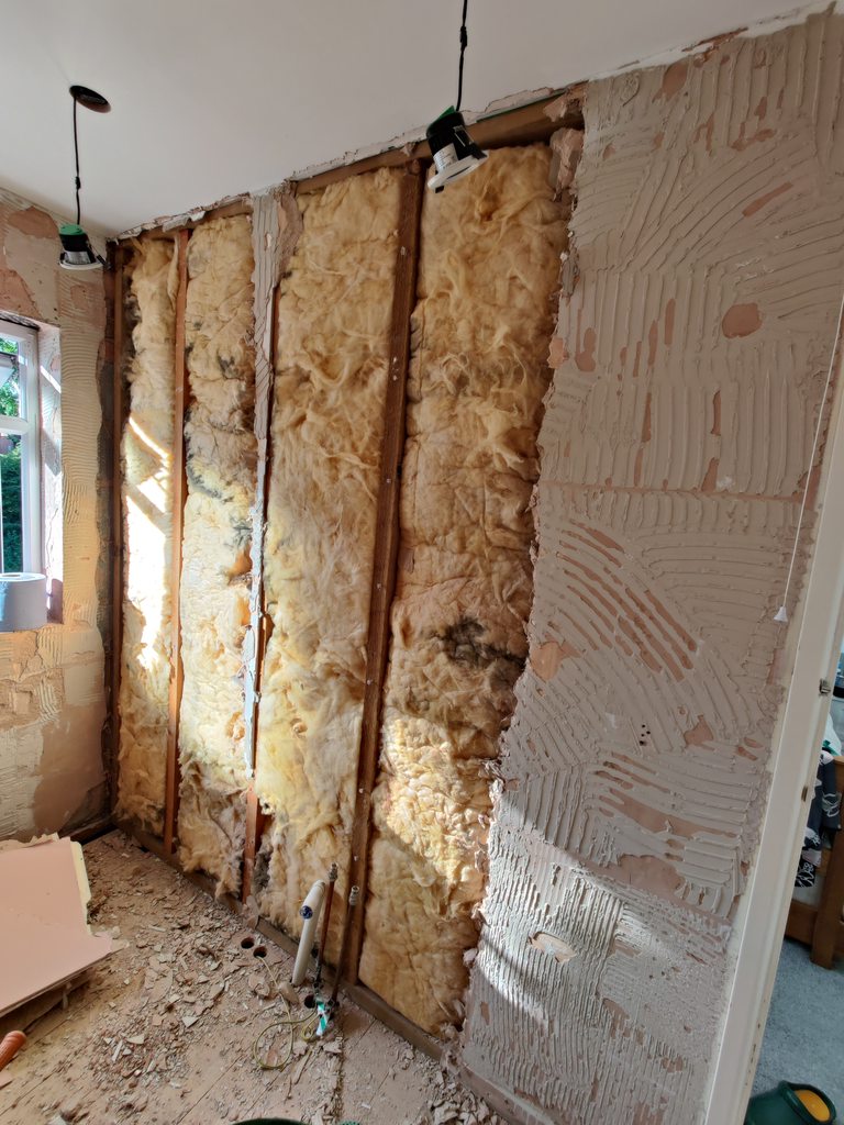

Reckon I can leave this insulation in situ rather than replace it? It seems ok and there'll be foam boards going on this wall, but there's a bedroom behind this wall.

The insulation is pretty much what you’d find in any new build / extension / loft conversion. It’s all we have in ours. I specced different plasterboard that had (apparently) some better acoustic properties - but if it’s ok - I wouldn’t bother changing it. Others may disagree - especially with PIR board being pretty inexpensive now - but you’re gonna have boards - assume 12mm? Tile adhesive and then tiles - so you’ve probably got the best part of 30mm before the rock wool.
See what others think obvs!
You don't need to insulate better if it's between rooms. If it's for acoustics rockwool sound insulation will perform minorly better acoustically but you may be unable to tell the difference.
Yes the boards will be 12mm polymer/ cement coated polystyrene type boards.
Sounds like consensus is that the existing should be ok, which is great because the materials have already cost me a fortune on this. You can take see why even average bathrooms are £££.
