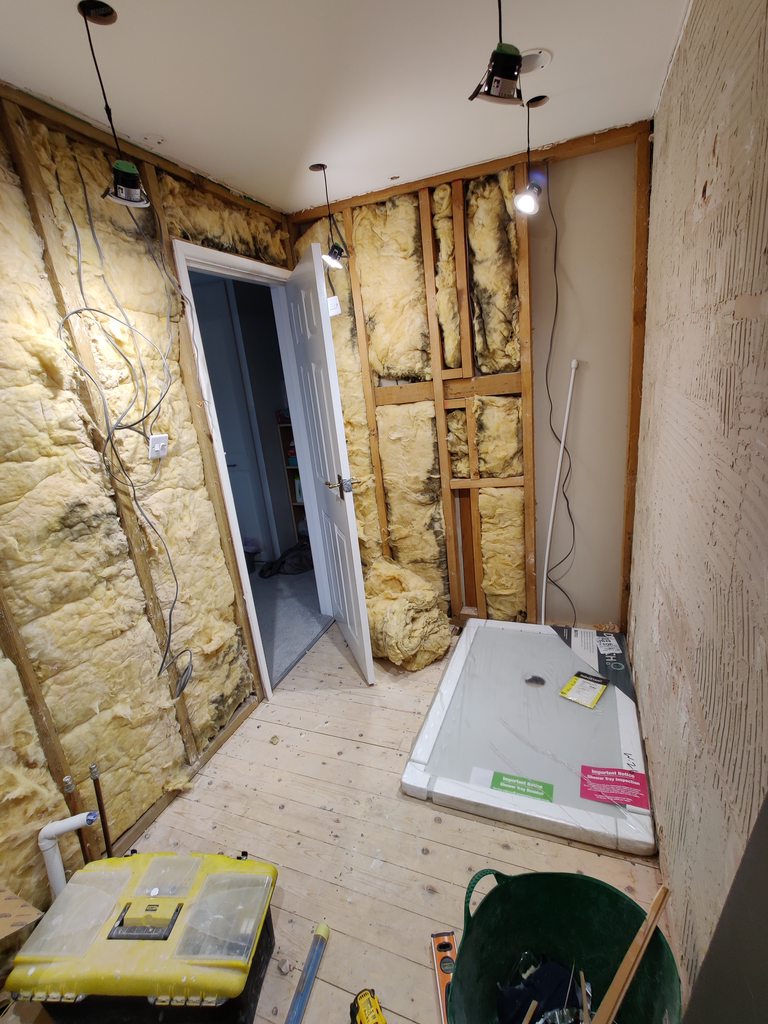

My process will be primer, 10mm XPS / cement back board, glued and screwed and covered with SLC.Good progress - thanks for posting the updates.
Are you going to put thin plywood sheets on the floor?
Are you gonna use tile adhesive for the boards or some CT1 type stuff??My process will be primer, 10mm XPS / cement back board, glued and screwed and covered with SLC.
I'm using S2 rapid set tile adhesive, Ultra Tilefix brand, for both the foam boards and the floor tiles.Are you gonna use tile adhesive for the boards or some CT1 type stuff??
Goodo - sounds like you’re following the manufacturers instructions!!I'm using S2 rapid set tile adhesive, Ultra Tilefix brand, for both the foam boards and the floor tiles.
Then I'm going to screw it in with wedi-style round washers before the adhesive goes off to make sure it follows the contour of the floor boards, and then correct level with SLC.
If any floor tiles crack after everything I'm doing to prevent that then I'm going to throw myself out of the window, as I've had experience of cracked tiles and grout from poor installation and have researched extensively about how to avoid it.

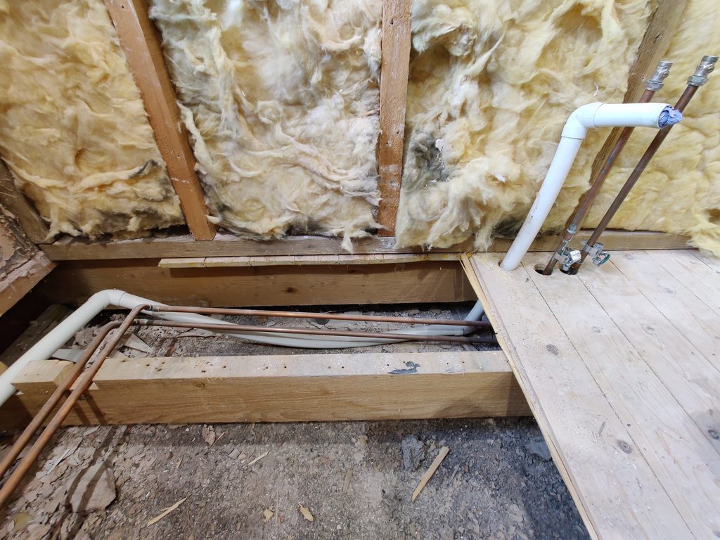

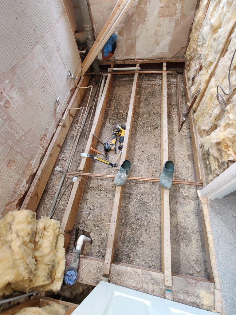

Well I've ended up removing the entire sub floor (~18mm T&G boards) today, partly to make the plumbing easier (or possible really) and partly because the floor was just not strong enough for a bathroom floor.
I'm glad I did because I found a few more appalling examples of lazy / incompetent work...waste pipes going upwards, unsupported pipes, unsecured joists wobbling about, LOTS of building waste left there, no insulation.
I'm fitting 18mm structural ply in its place across the whole floor once I've braced everything.
Have a look at this diamond. That pipe was the basin drain and we now know why it was draining slowly .
Removing this was disgusting, loads of smelly sludge stuck at the bottom.
Yes that's the plan, put all pipes (water, waste, heating) into stud wall or chased into bricks.To quote the Welsh social media building inspector: Shocking.
At least you've now got the perfect opportunity to take that waste and perhaps hot and cold feed into the wall, which will make for a nice finish and better fixing.
