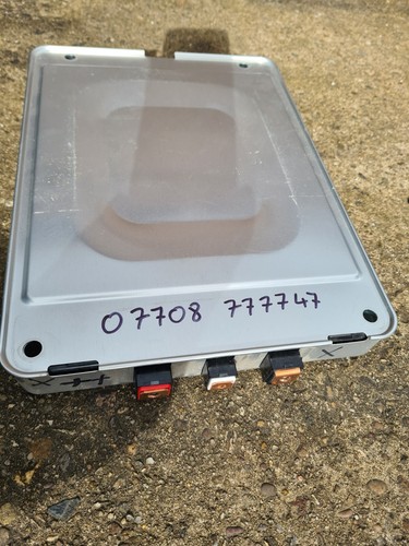

Just because you don't know how to do something, doesn't mean it's not possible or even relatively difficult. There's loads of ways to re-use Leaf cells to create packs with different voltages that are more useful to for home storage.
You don't even need a Leaf - you could just buy the individual cells (or, sell them)

my design (better not steal it), works for any model:
