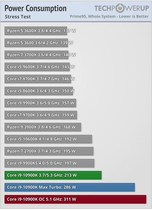

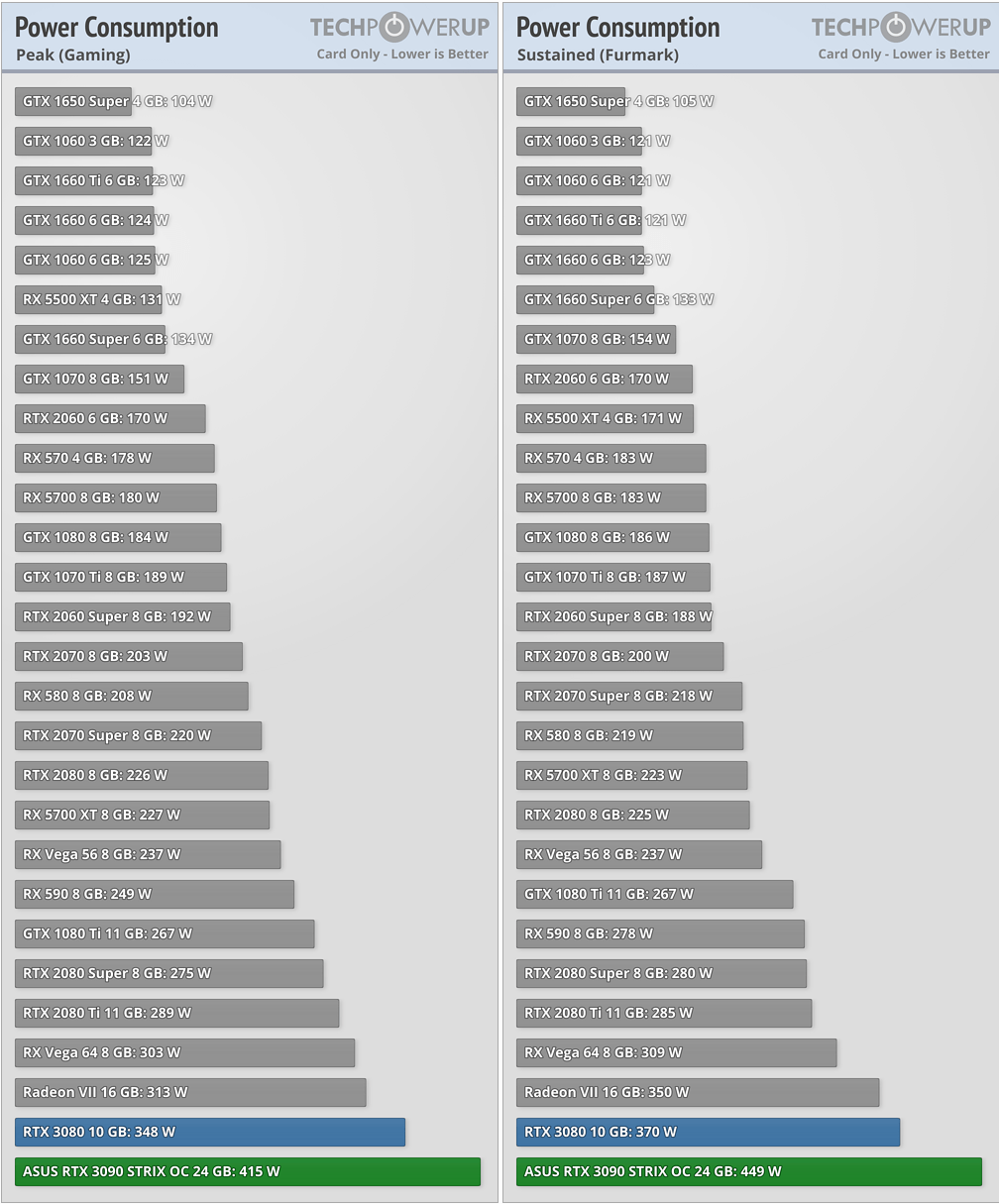

3090s can pull well over 400 watts on their own, add in a power hungry 10900k and you are getting very close to the limit.

The Asus Strix OC they used is straight out of the box, if it is overclocked to maximum it will use even more power.

Equally your PSU numbers won't show the transient amps which in this case is the issue and even those don't come up in the numbers. You'll see upwards of 450W JUST from the GPU at peaks.
