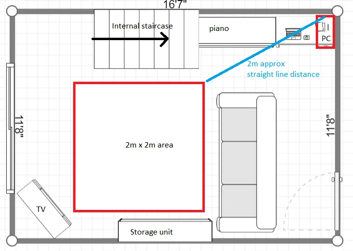

Its a 5m cable right? Practically how far does that allow you to be away from your pc, given that I guess you can't run it taught?
I have a nice square 2m x 2m area available in my living room but that area's corner is 2m away from the back of my PC in a straight line.
May be OK, I assume there does exist either an extension or a longer cable (unplugging from headset end is harder than at the PC end). I am a good 2 metres away from the PC I reckon.
Also you will be reasonably in the centre of the play area most of the time, I don't think you would need to get your head into the furthest away corner, it's more to give your arms room to swing.
I actually play with my play area facing away from my PC as that's where the cable is coming from anyway.
I don't think 5m gives a great deal of leeway on the face of it.
2m from back of PC to corner of play area.
The centre of the 2x2 play area would be a further 1.4m on the diagonal.
Then I am 1.8m tall so cable has to come up from ground by that amount.
Assuming a vertically dangling and loose cable is preferred rather than one stretched taught off the ground, then that total is already 5.2m.
With a floor straight line distance into the far corner of my play area, and my height of 1.8m, that gives a triangle of base 4.8m, side 1.8m and therefore a perfectly taught length of 5.1m.
Feels a bit borderline.

My current setup is kind of temporary, but I have my PC behind a desk, the cables run from the back of the PC, then over the desk (70CM high), then they run up to my head from there.
It's approx a metre from the back of the PC to the desk, then about 2M more to where my head would reasonably be at all times, so I am not stretching the limits of the cable and could go a fair distance further.
Perhaps a pic of your setup and people here can chime in if it would work or not?
I see, looks like it would work, even better if the pc was on the left next to the piano instead of the corner.
An idea: get a 5m long bit of string and check how the length is when tied to something at the back of the pc.
