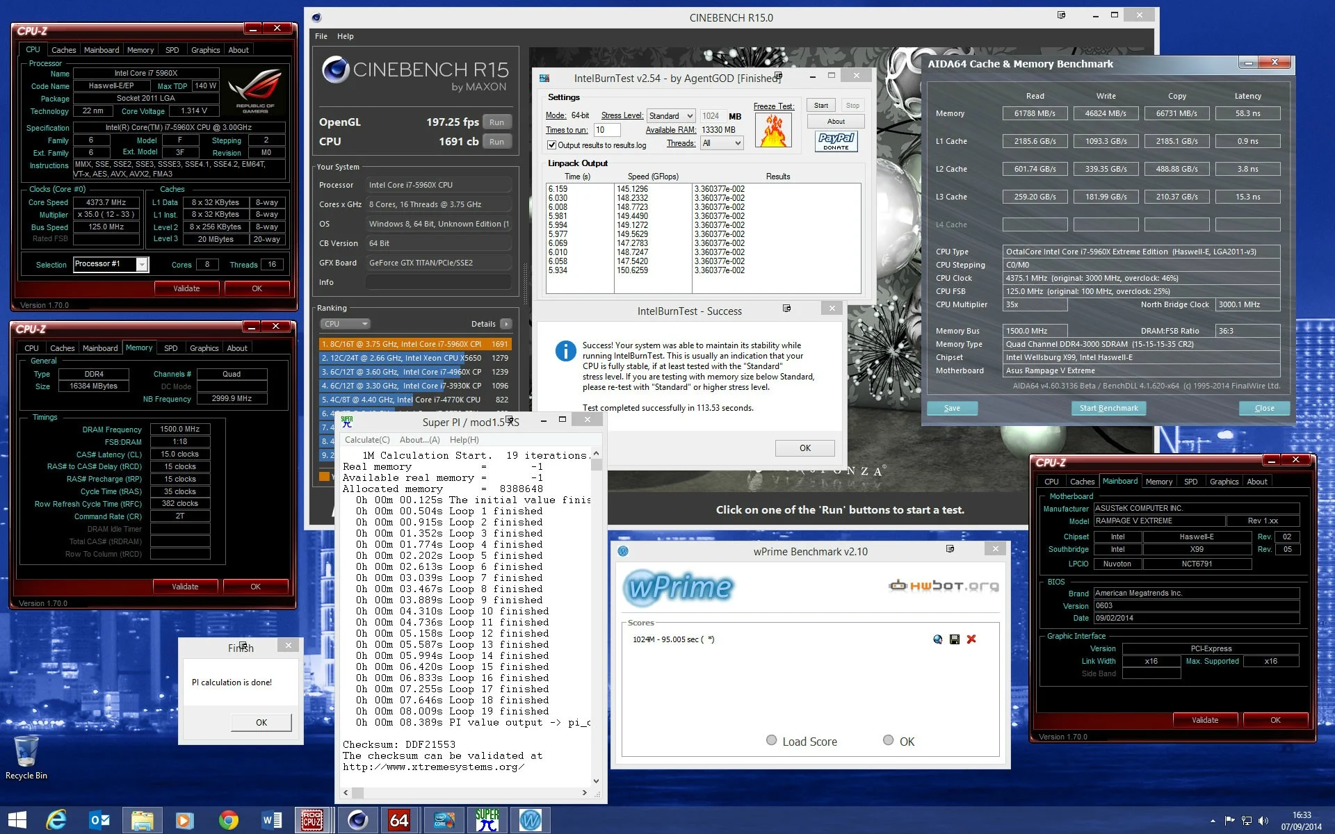

First play with i5960X with 16GB G.Skill DDR4 3000MHz memory for a quick overclock:
