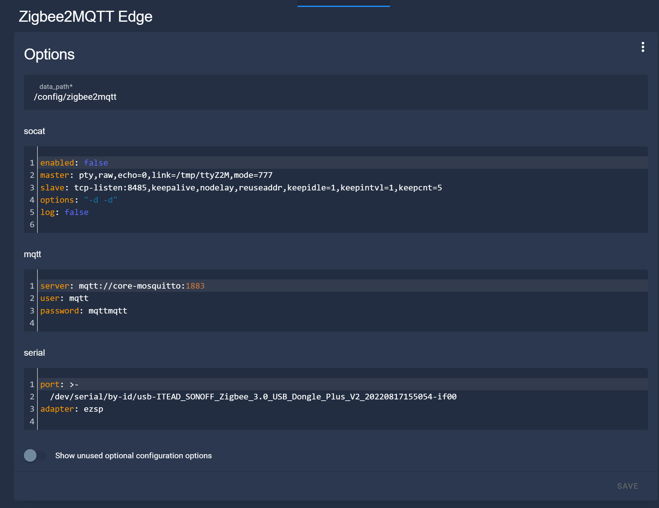

Anyone have any idea why half my config is constantly missing?
I've got the USB sonoff bridge plugged in but can't seem to set it up correctly
@katie279 @andy_mk3 if you have any ideas as I know you have these?

Yeah I've followed a few tutorials
That config in the image is about 1/3 of the length it should be and misses a load of parameters - copy and pasting in the 'correct' config doesn't work either, the add-on just crashes :/
No worries if you can't help, I may post an issue on the z2m github
@ShivP which exact Sonoff stick do you have? There's a Dongle 'E' and a 'P' version.
Mine is the later 'E' version and this is my config below. Not you need to get the serial location from Settings > System > Hardware > All Hardware. Also if you have the 'E' version it's a good idea to run Zigbee2MQTT Edge.
Cool, thanks. Annoyingly I've ended up with the 'P' version but could return to get the newer E as I understand it's a bit better

Thanks @andy_mk3 all working now :)
