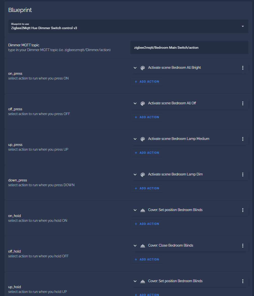

It's definitely not as easy no. But there's blueprints for the hue controls and stuff to make life a lot easier. Plus you can make the hue dimmers control anything you want, like blinds, bathroom extractor fan etc :D
Hmm, that is tempting then. Can you do stuff like the "hue" button on the remote cycling through scenes?
Yeah that's definitely possible, although may require some manual tuning to make it work. Someone will have done it on the HA forums either way :D Can also have things like turning on lights/scenes for a room from the button change for the time of day, I do this with my bathroom lights, so after 11pm the lights will turn on dimmed from the switch, but during the day/evening they will be full brightness, although I will eventually be going back to a motion sensor in the bathroom.
