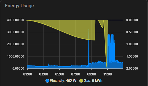

Thanks for the link. Still cannot get it to invert underneath the electricity, as it is now treated as a separate yaxis. Perhaps it can't be done in the way I want it. Hohum.You need to add another y-axis that's inverted, then it can have its own scale I believe.

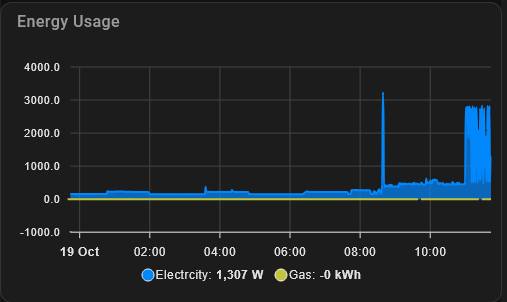

The yaml is incorrect, Quite a bit of what it spat out is in the wrong sections. BUT I did already try a variation on this. It produces this.Hmm ok.
Give the below a try. No idea if it'll work, it's what Chat GPT spat out
YAML:type: custom:apexcharts-card update_interval: 2s header: show: true title: Energy Usage graph_span: 12h apex_config: chart: height: 250px width: 500px grid: show: true strokeDashArray: 0 borderColor: "#444444" position: back xaxis: lines: show: true yaxis: - show: true title: text: "Electricity" forceNiceScale: true - show: true opposite: true title: text: "Gas" forceNiceScale: true reversed: true # <-- this inverts the y-axis itself series: - entity: sensor.electricity color: 0388fc name: Electricity yaxis_id: 0 # Use first y-axis - entity: sensor.gas color: c2c43f name: Gas yaxis_id: 1 # Use second (inverted) y-axis all_series_config: stroke_width: 2 type: area

I'm struggling to understand how to modify an apexchart y-axis unit size for a series entity which is inverted.
This is a simple energy usage chart, showing both electricity and gas.
Is there a way to change the y-axis scale for the inverted gas usage? I suspect I need to modify the following section but I'll be damned if I can work out how.
Any pointers?
Cheers!
I'll give it a whirl but I may just settle for separate graphs.What about making a helper through the UI which inverts the gas sensor value?
It should be fairly straightforward - create a template sensor called sensor.gas_invert or similar and add a bit of yaml along the lines of {{ states(‘sensor.gas’) | float*(-1) }}I'll give it a whirl but I may just settle for separate graphs.
This and multiply it by 1000 and it'll fit with the electricity scale.What about making a helper through the UI which inverts the gas sensor value?
Thanks. I'm still tinkering and finding my feet with this. Cheers.This and multiply it by 1000 and it'll fit with the electricity scale.
