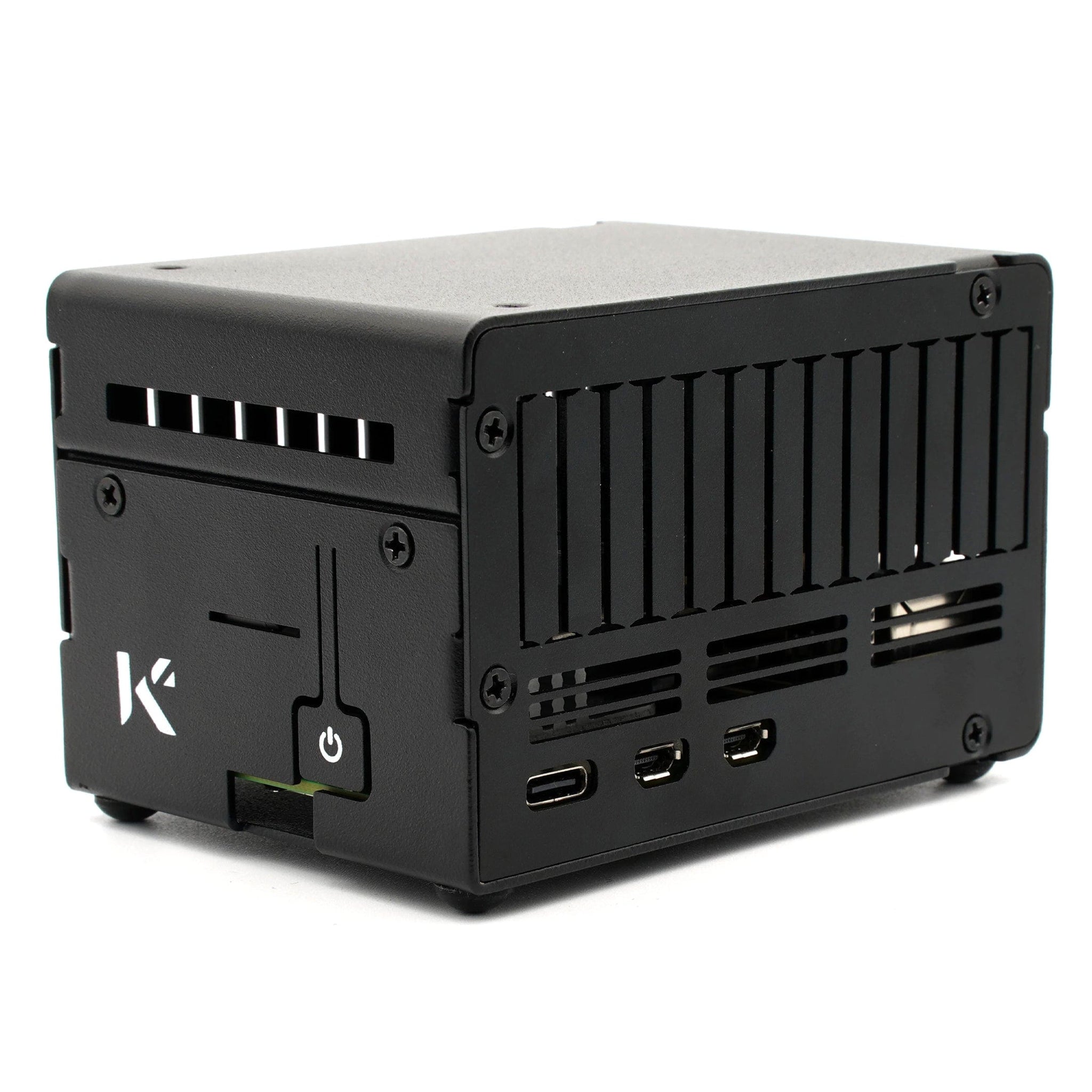

Can someone check these parts are correct for running Home Assistant, using POE and an m.2.
Plus a Home Assistant Connect ZBT-1, they don't have any stock. That will let me ditch the Hue bridge if I understand correctly and run everything locally?
Cheap m.2 as well.
Cheap m.2 as well.
That looks fine to me.
Yes, the ZBT-1 will allow you to ditch the Hue Bridge*
*Some third party hue stuff can be problematic, but first party stuff works fine... I also connect my Samsung smarthings plugs directly via Zigbee for local control.
Great, thanks. Managed to order the ZBT-1 seems most places are out of stock.
Doesn't look too difficult installing everything, looks like I first need to install Pi OS on an SD card, then use imager to install HAOS onto the M.2, then configure to boot from that.
Personally, if you are spending that much of buy an N100 or N150 based mini PC that will come with 16gb of Ram and an 500gn SSD for £130.
I picked up a Trigkey N150 unit from a large well known retailer for that much a few weeks ago. Prices are not that low currently unless you buy direct from china but you know they’ll be all discounted come Black Friday.
@robj20 I agree with @b0rn2sk8 in that a mini PC will be better. RPis are great but because they’re modular the costs can outstrip an equivalent mini PC and they’re not necessarily better than the mini PC.
Whatever you get, you MUST put your zigbee dongle on an extension cable as USB somehow interferes massively with the Zigbee signal.
If you already have a PC or Mac then download the HAOS image and use Etcher or similar to burn it to the an SD card or USB drive so you can install it to your NVME drive
Better is subjective, I specifically want to power it via POE and keeping power consumption low is a priority as well.
I did think of just running it on my current NUC that does Plex but I also want key things separate.
An N100/N150 is usually ~6w idle power consumption.
That said it won’t be powered by POE.
If you have an existing NUC, just run it on there in a VM ( not docker), using existing hardware is the best kind of low power consumption.
We've covered all this when it was first suggested, I don't want to learn how docker or VM ware works, I also hugely prefer separate devices. Otherwise I'd just carry on using my NAS to do Homeassistant.
The choice came down to a Home Assistant Green or a Raspberry pi. Then I wanted it powered by Poe so it can go in a much better position without me needing to add mains.
