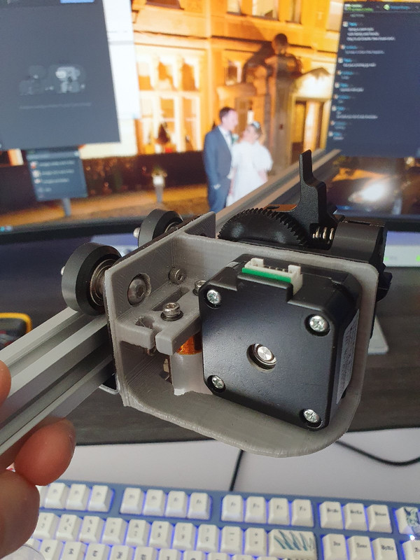

Im currently building a DIY and most of the stuff has been coming in from china and taking 3 or so weeks to get here. I bought some extrusion and some other bits off of ebay from uk sellers. Fun little project, I have not been steaming through it but I recon my new little printer is about 80% done now. Hopefully finish it in the next few weeks. Still waiting on some of the electronics and for me to finish the rest of the cad work.
Put together the X carriage for my scratch build printer using an ender 3 mount, printed parts, titan aero clone and also bl touch. Looks ok so far might have to make some small changes:
