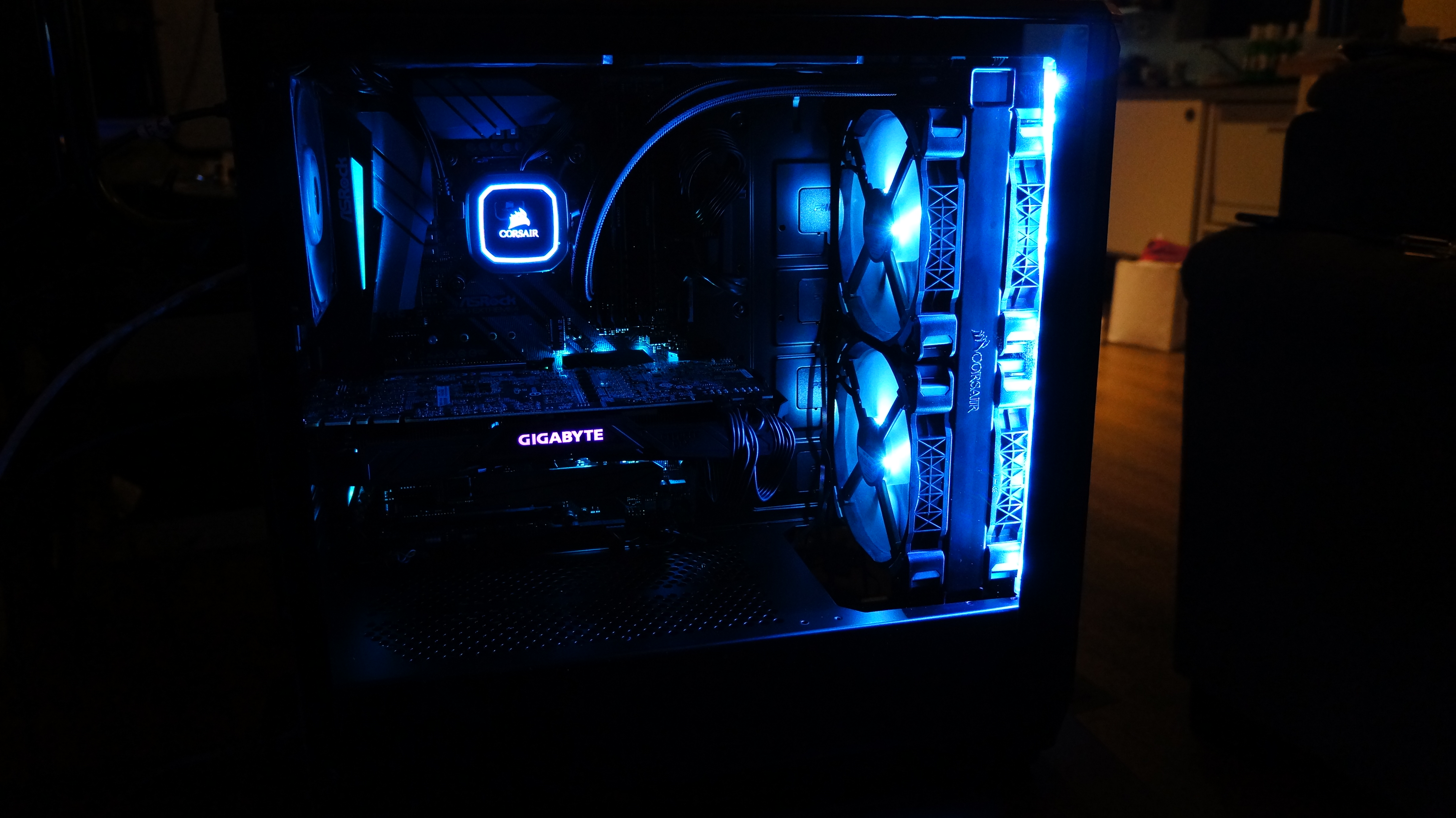

I just added another 2 x 140mm Corsair ML pro fans to my H115i Platinum.
So 4x Fans (push/ Pull) small FFT running all at 450 rpm silent mode.
Knocked off around 4c :D Running prime small FFT :eek::p

Dude thats running Small FFT in prime....Not Cinebench totally silent :p
Cinebench I get temps of 62 ish...
4 x 140 ML Pro and 3 x 120mm Gentle Typhoons :D
Back plate for the 1080ti on order :)
Ok sorry for being dumb.. new to this oc stuff, you have 4 fans attached to that rad, what’s the setup? Push / pull, all intake or exhaust? Silly question but will 4 on one rad do a much better job than two? Might get another two then
