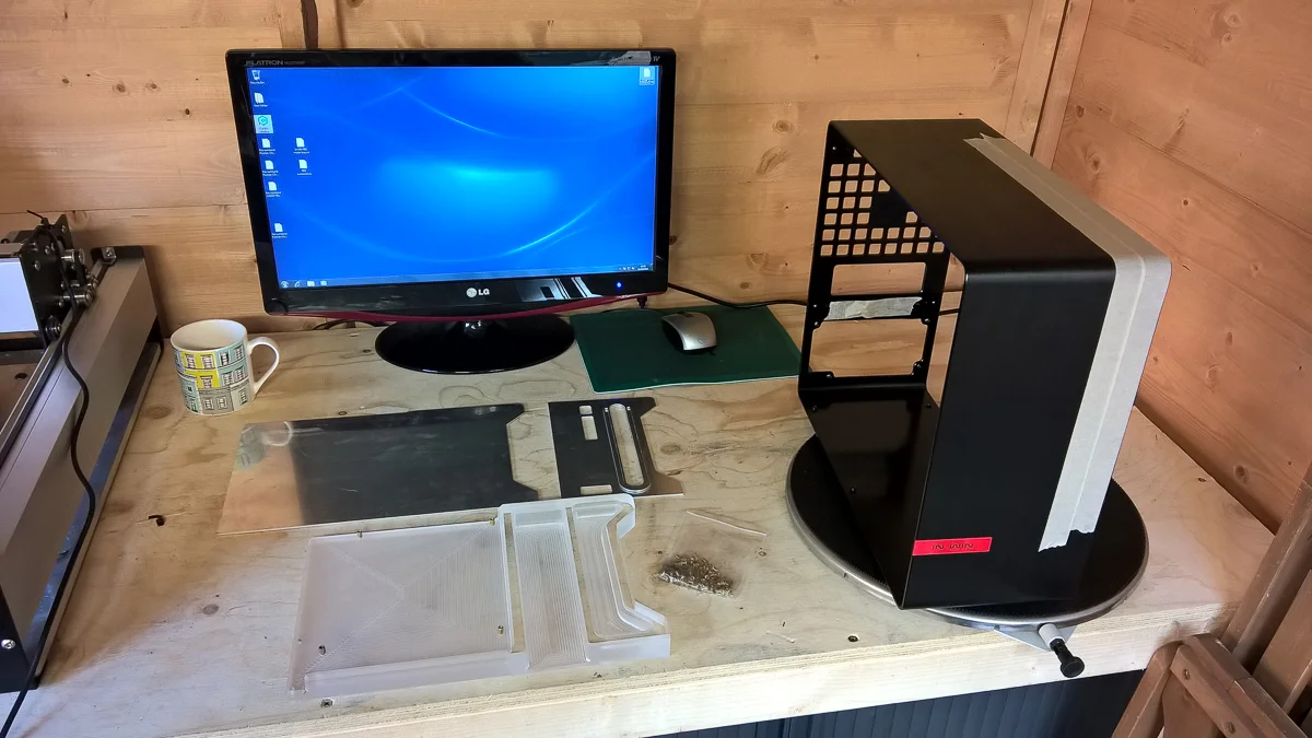

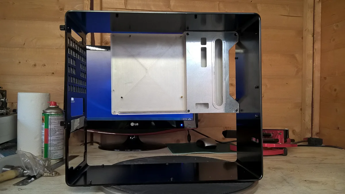

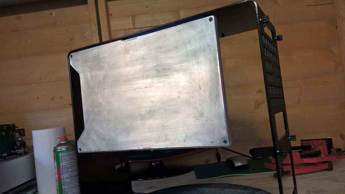

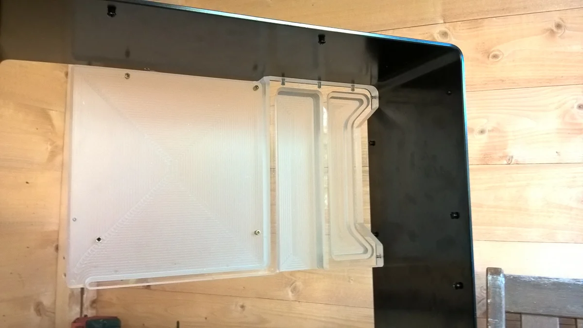

Today was all about getting the tray and vanity panels mounted.

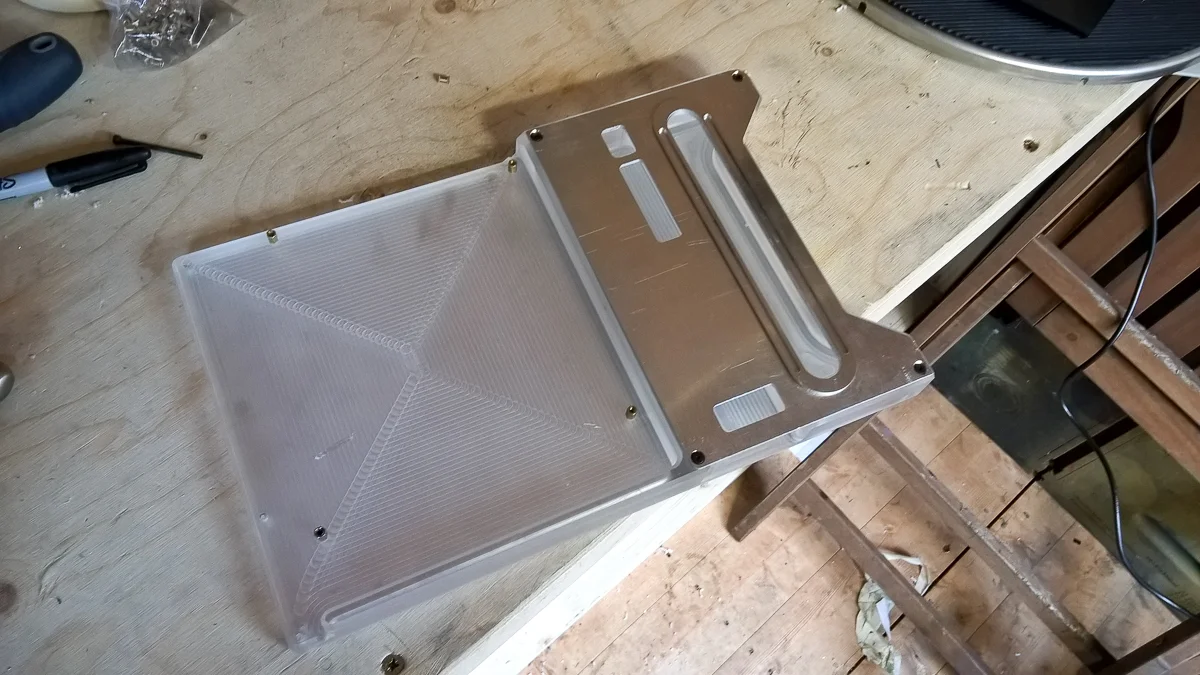

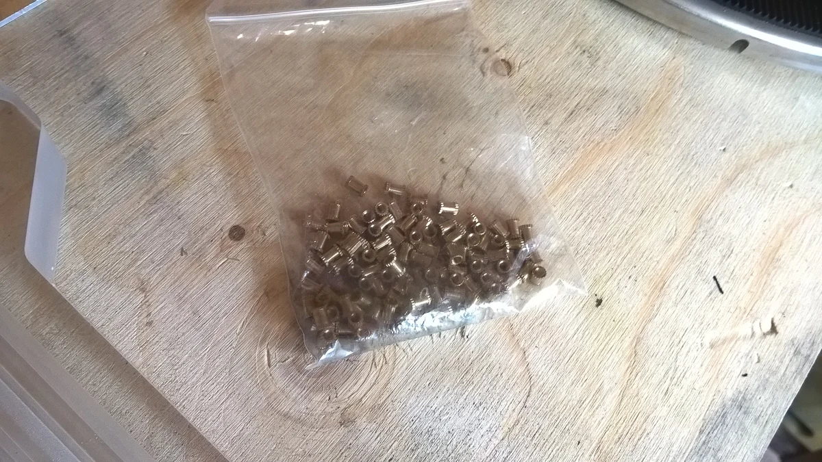

We start with how im going to anchor the acrylic,normally i would tap the acrylic but this presents a very real problem of potential breakage so I looked to another way.
I used these instead.
Drill a 3.5mm hole and I used my trusty soldering iron to heatpress the inserts into place,now I have a breakproof thread that wont wear out!

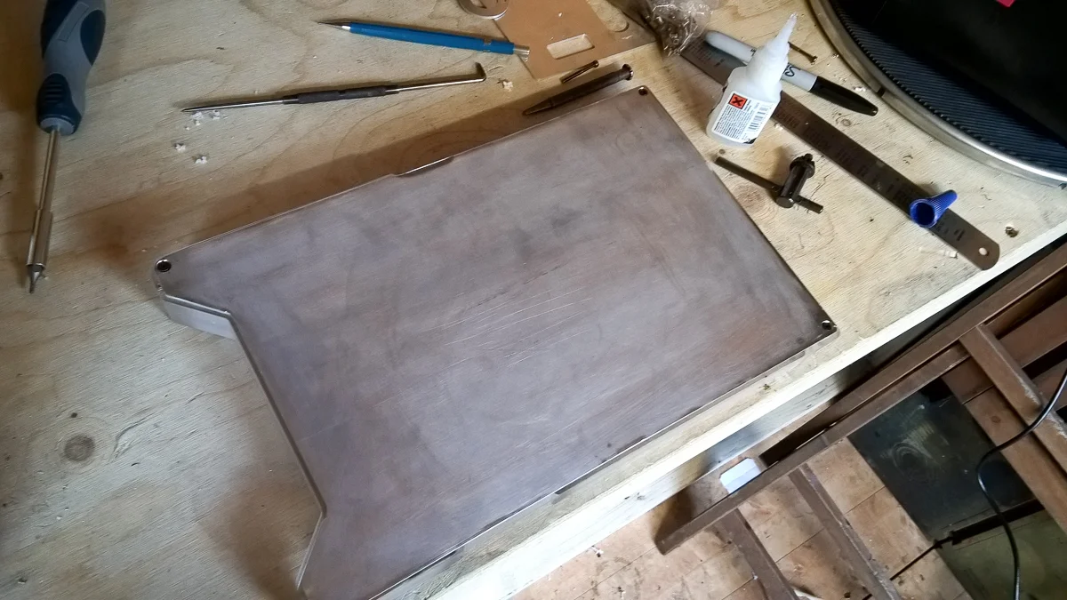

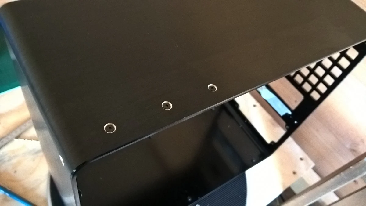

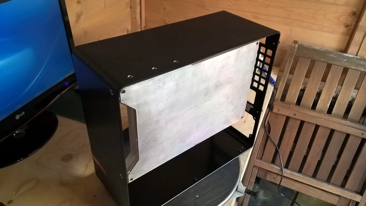

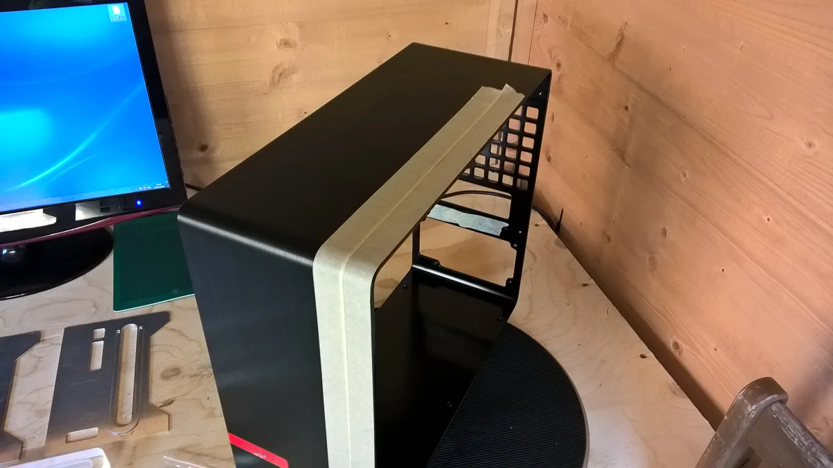

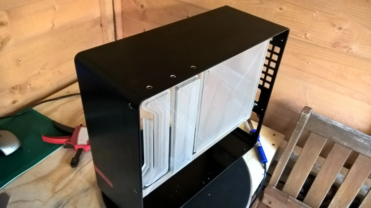

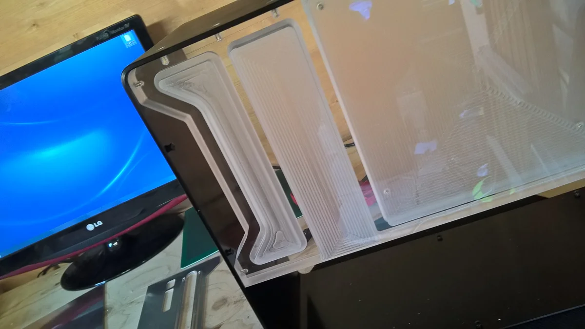

Im drilling thru the case to mount the tray,I gave the holes a nice deep countersink to aid the filler by giving it some room to grab when it comes time to backfill.

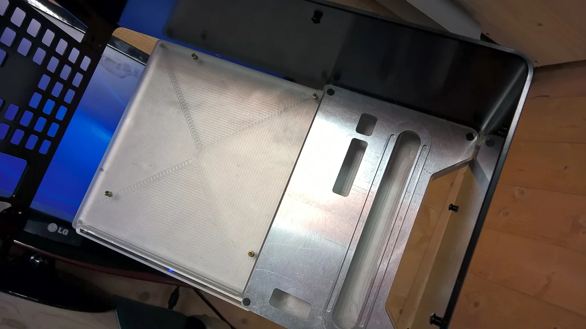

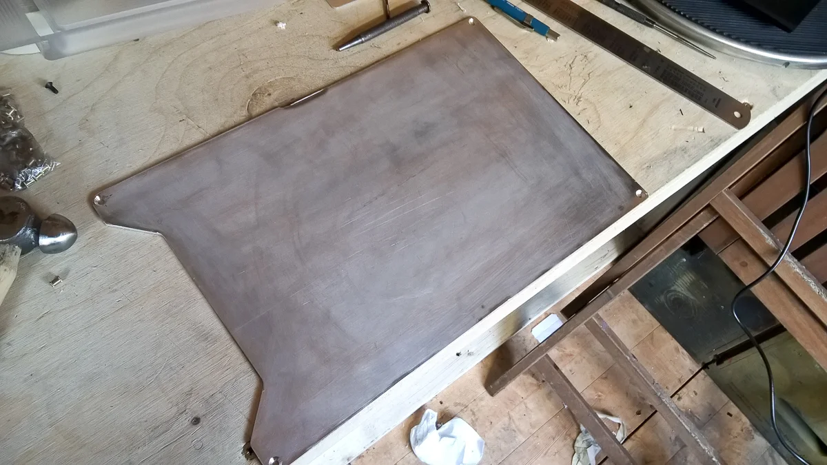

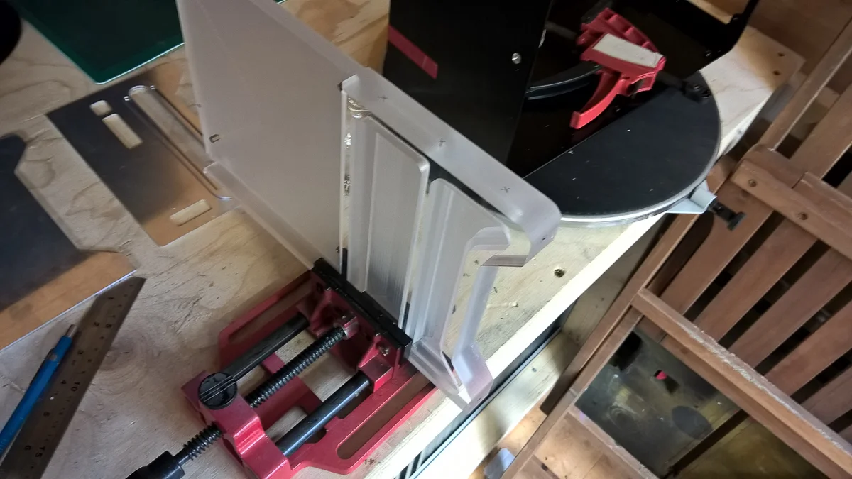

I offered up the tray to the fresh holes and just marked the hole centers on the acrylic for drilling
6mm deep as required by the inserts.
Success!

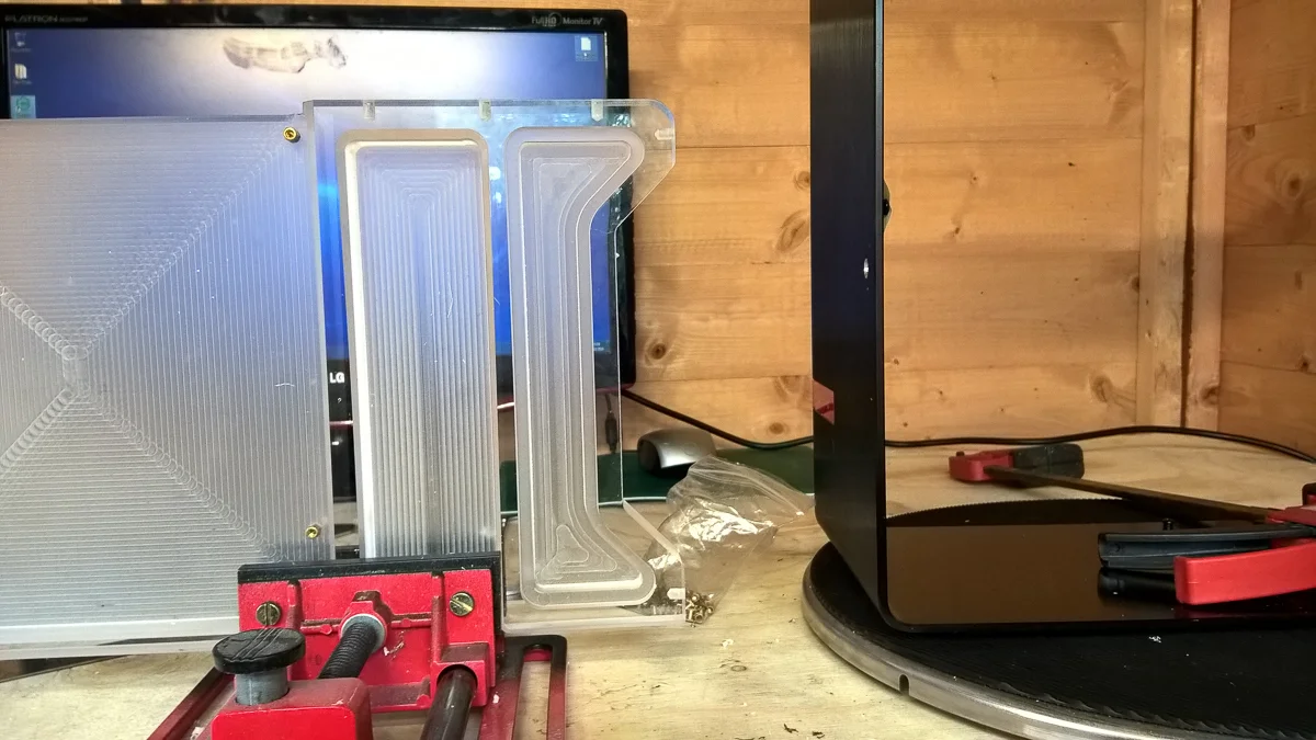

Now to drill and countersink the panels,again with a deeper than usual countersink to allow for paint ,if its done to size now then the screws will certainly be proud come the refit.
Then I did the other side...

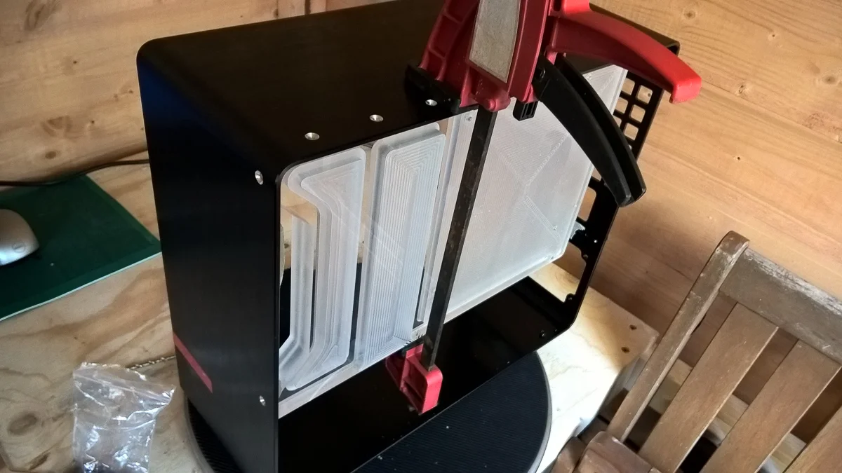

Remount the panel and it looks pretty good I think.

Great stuff as usual! Are you concerned about all of the weight being supported by just the corner? If you're essentially melting those inserts into the acrylic is there some risk they could become loose and fall out?
The midplate is doing all the heavy lifting,these are just to hold everything in place.
They are designed not to pull out,the acrylic melts around it and holds it fast,the knurling is quite deep.
