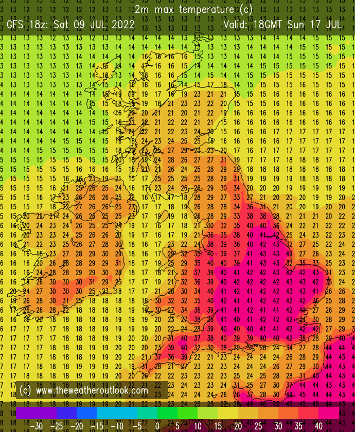

Let's hope this doesn't come off:
Every run is trending that way and the min temps aren't far behind... other models seem to be following though the BBC is going against.
I've not looked at what those who actually know what they are talking about are saying yet but the setup leading to it seems to be dragging considerable heat up from the south where temperatures are breaking records so...
EDIT: Though it looks like there will be a fair bit of breeze which will hopefully offset the brutality of it.
