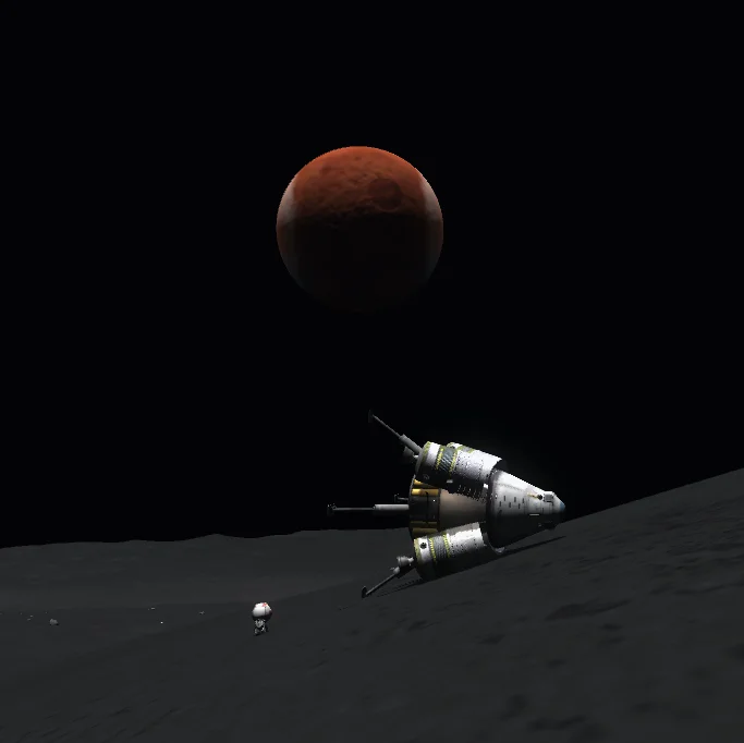

Well this managed to get me into orbit around the Mun, off to Minimus for EVA and then home... No need for massive rockets.
