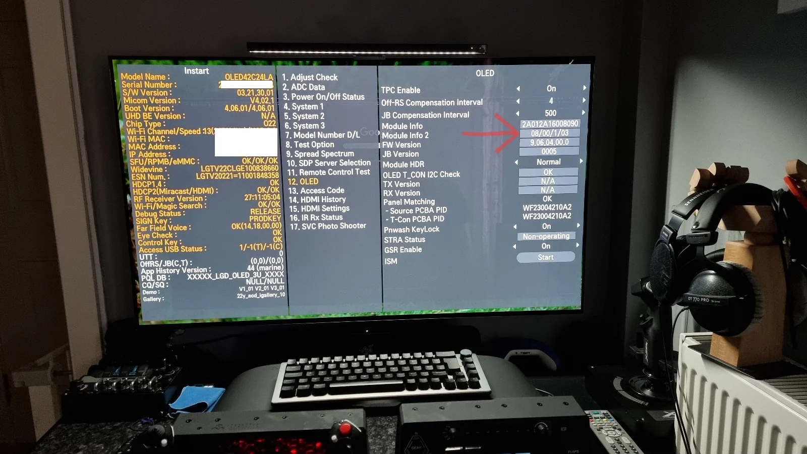

It arrived! Installed, updated software and striaght into the service menu.
Also as others have mentioned, it seems true about the pixel refresh only saying 10mins and not an hour.
(Thing is, in the 15 months of having the C1 48", I've never used it. Only the 5min screen refresher that pops up now and again.)
Looks like we have the WBE/EX panel, manufacture date: 07/2022

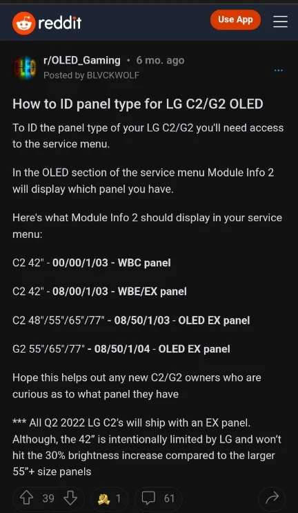

Probably going to have 100s of future post asking which panel is inside, just ignore service codes, blue tints, pink tints, barcodes, stickers, manufacturer dates. Just re-link to this post.
Check under General>OLED Care>OLED Panel Care>Pixel Cleaning> then read the bit on top with pixel cleaning (might be different per TV and model)
If it reads 60 minutes you have the older panel (WBC and WBE), if it says 10 minutes then its the newer panel(OLED.EX)
Not that there is any real major difference still. I believe from 2023 most LG TVs will be on the OLED.EX panel so hopefully these questions reduce.

How confident are we of that info btw? My panel was March 2022, but says 10 minutes. Doesn't the data of manufacturer of my panel suggest it's an older one?
Feels reliable for now, several others are referring back to that post too and those guys calibrate their OLEDs and know so much about the OLED technology, its like their married to their OLED.
The guy that posted that info is within the 'loop' as to say.
For now since that info is the most up to date (posted november 2022) so go with what that guy suggest regarding pixel refresher scan timings its just more easier to I.D the panels for now, I would ignore build or manufacturer dates. If it is incorrect ill re-edit the post and update the info.

I thought WBE panels were OLED.EX? Just different names for the same thing? Nevermind, just found out EX panels are just a slightly modded WBE panel with the same pink tint.
Are there people with more recent build date C2 42's with a 60min pixel refresh known to anyone?
Given that March builds are coming with 10mins pixel refresh time suggests that it's a software update that enables the quicker pixel refresh or older panels prior to March that have a 60min refresh time maybe?
Not heard of seen anyone with an C2 42 with 60 minute pixel refresh, not got my February unit anymore but my July 42C2 has 10 minute pixel refresher on it.
This post here and here explains LG moved to the OLED.EX panel after WBC/WBE with a newer T-Conn hardware units and removed the sensors that took 60 minutes to run. So from what I can understand of it all, LG had WBCs, WBEs, then OLED.EX panels. So not quite just a software update, but removing older hardware and putting a newer hardware chipset inside.
Guess it still does not really matter the 42C2 OLED.EX panel can't push the brightness improvements with the newer panel OLED.EX panel anyhow, so whatever is underneath it all produces the same picture quality.
