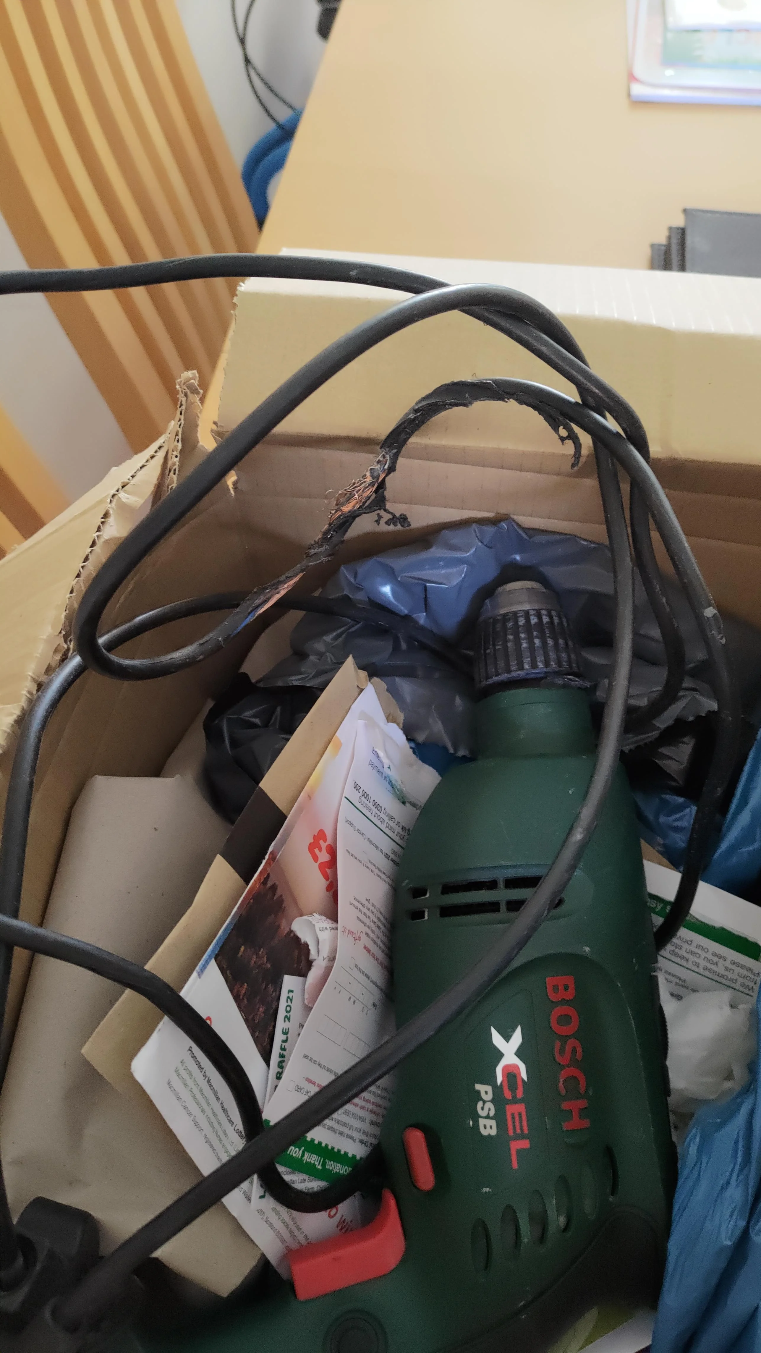

A moment's silence for "Barry". Who had a dodgy "Always on" button, and broke two of my toes with a 4x2 before taking off like a helicopter and smashing me in the stomach before going bang and taking out all of the house fuses.

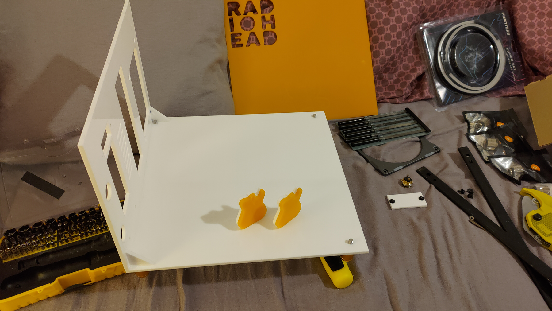

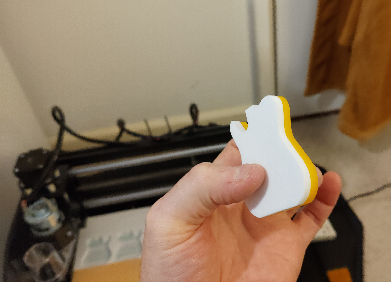

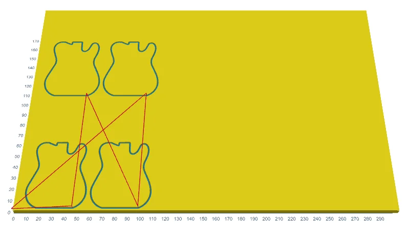

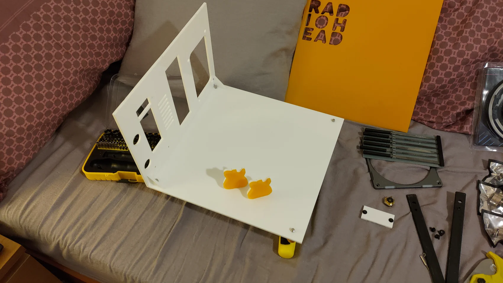

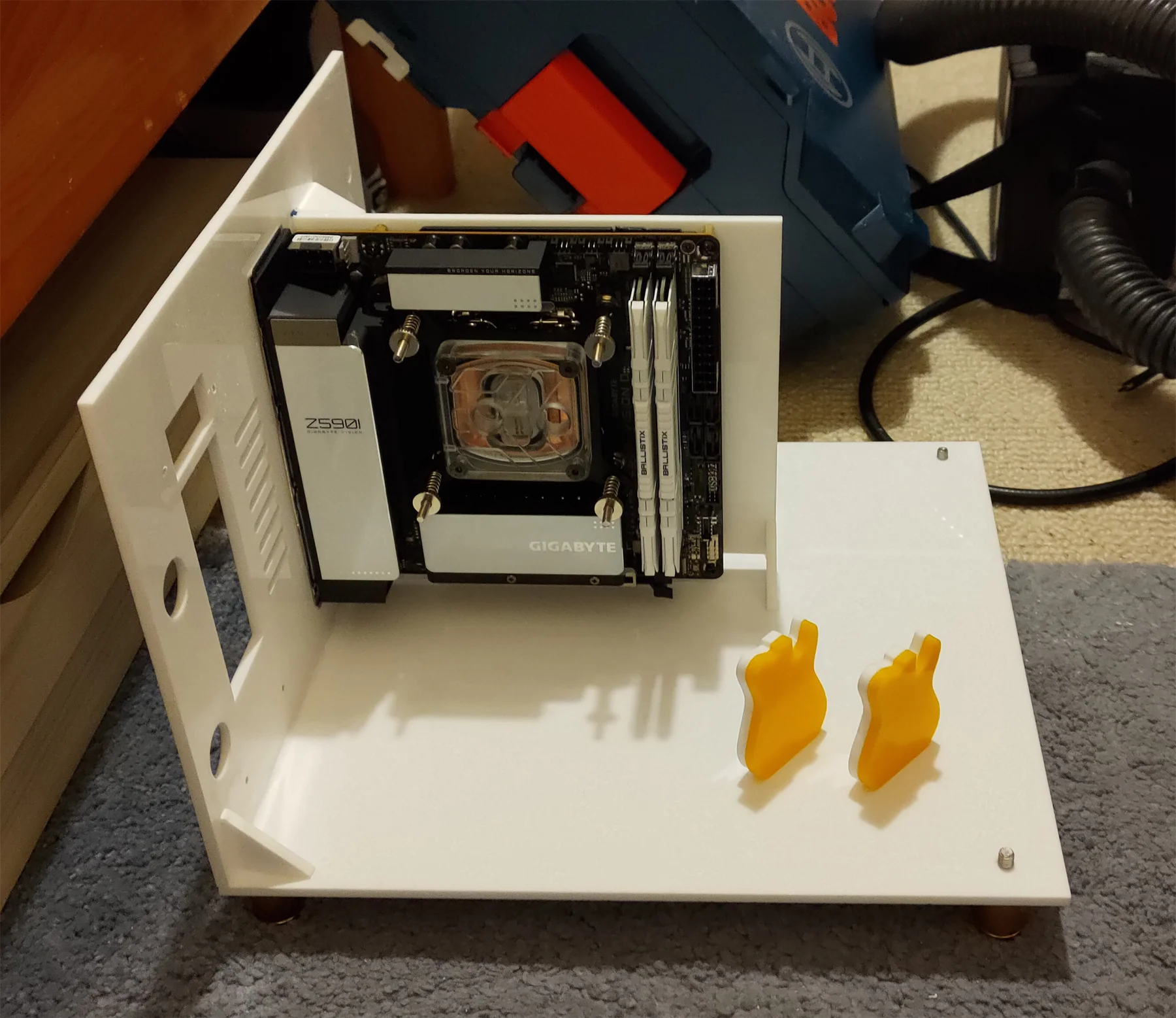

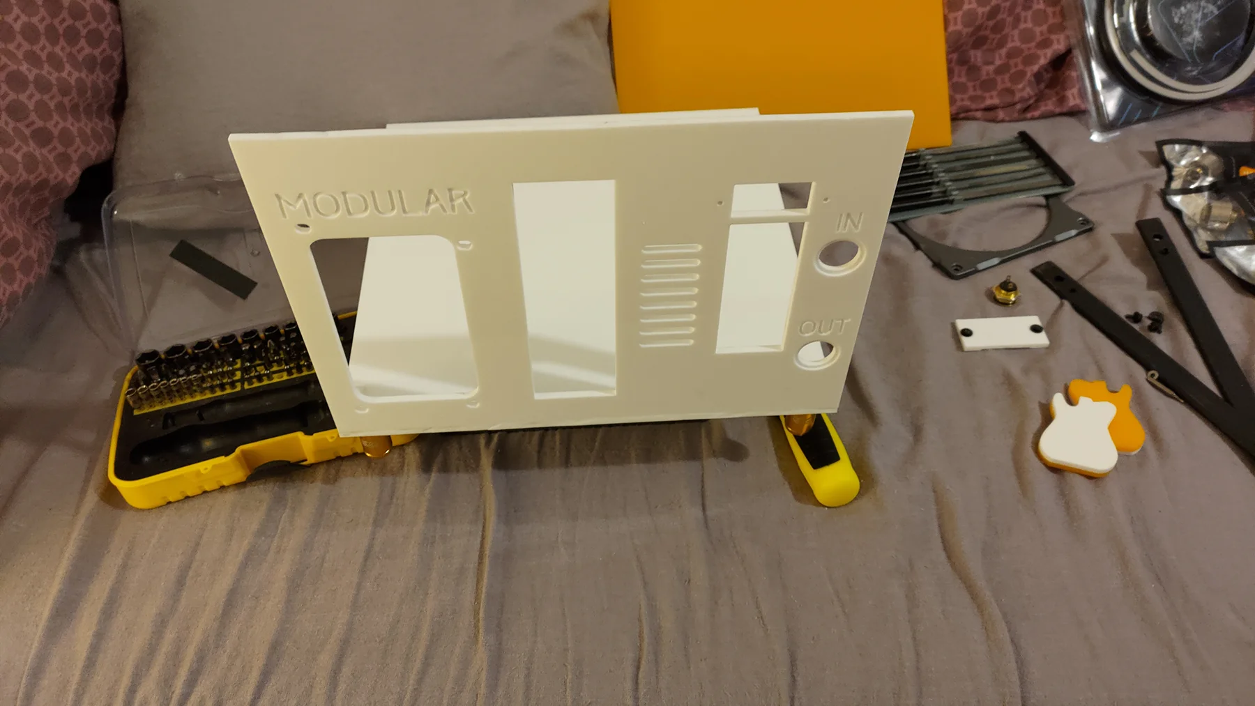

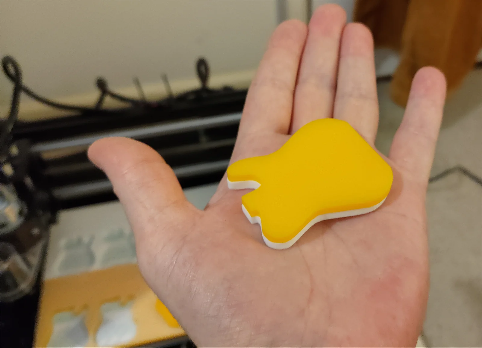

So, today's mini mission was the GPU supports that I spent too long designing. Thom Yorke plays a telecaster, so telecaster it was.
Only I loaded the acrylic like this.
Few more minutes needed in filing, as I soon learned just how little super glue is needed after sticking one to my fingers.

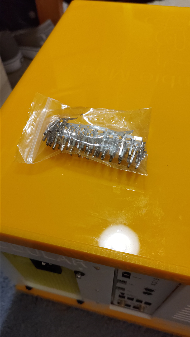

The mythical postman actually showed up with some stuff I have been waiting nearly a month for, too. Including the 100 M2 bolts I bought.

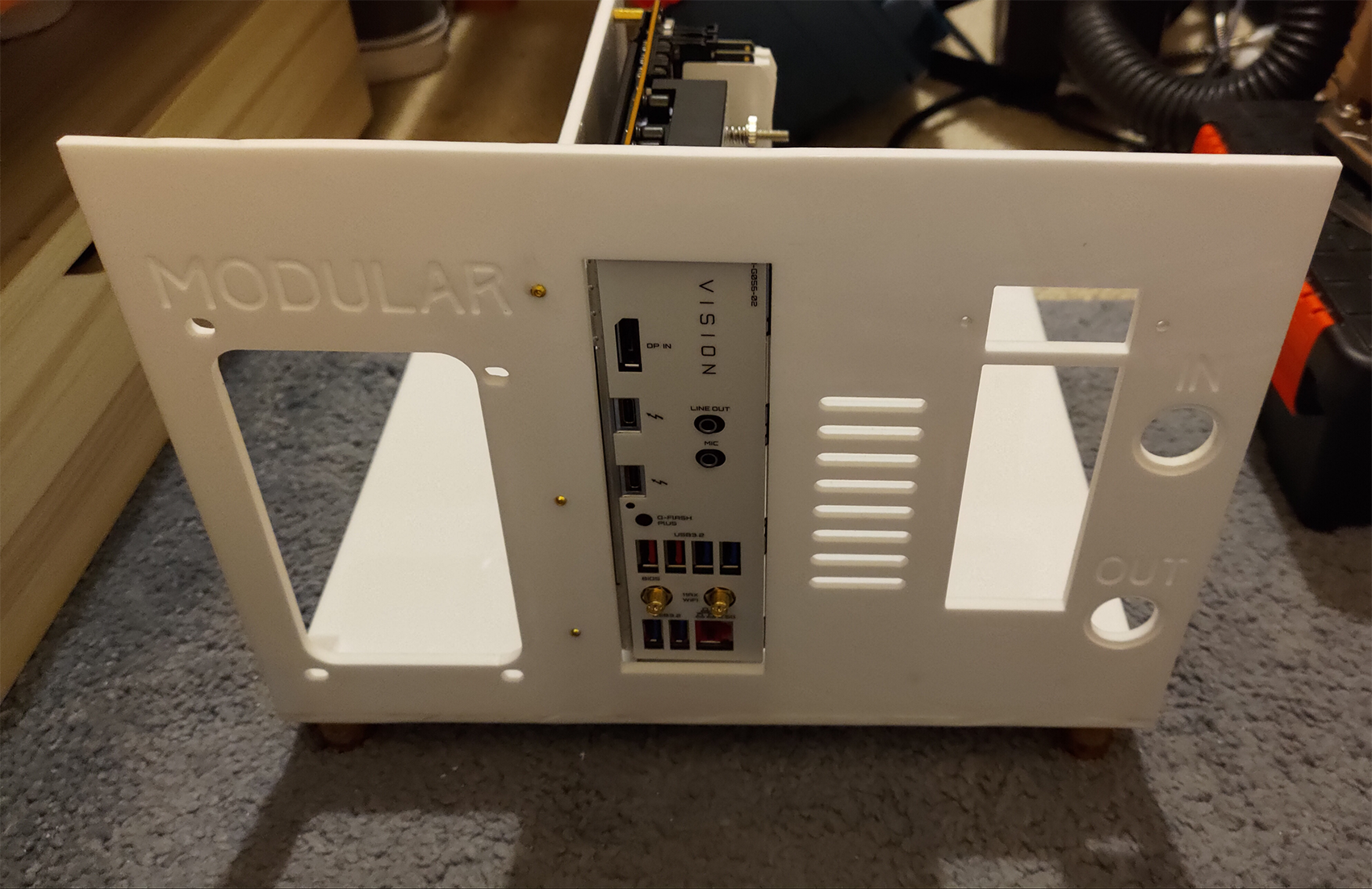

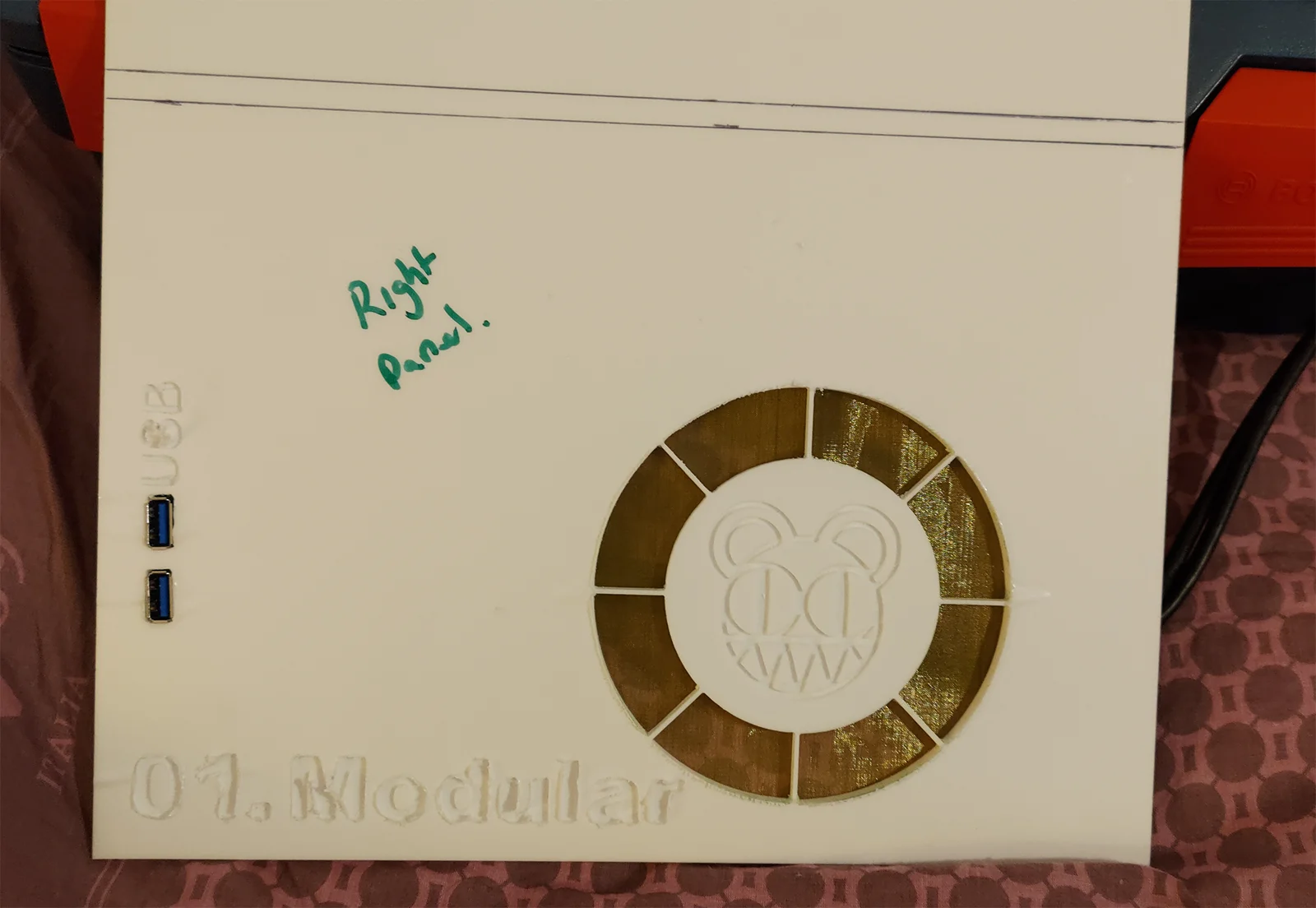

And the B side of today, the PSU side/vent thingermebob.
Brass mesh finer than human hair, superglue, activator and white tape.

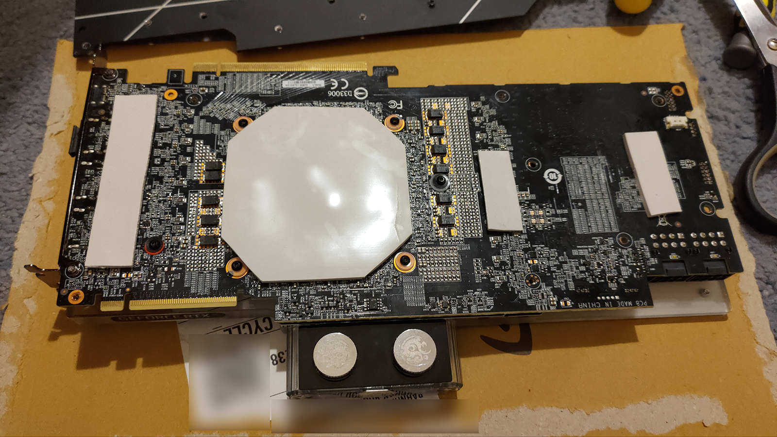

Update 27 - "If it still works I will be amazed".
I have hated every step of this. It better still work :/

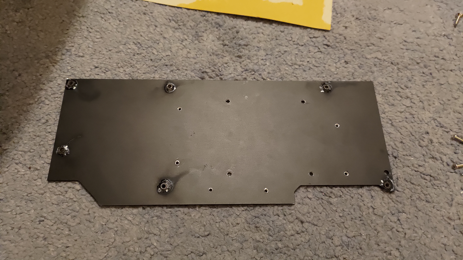

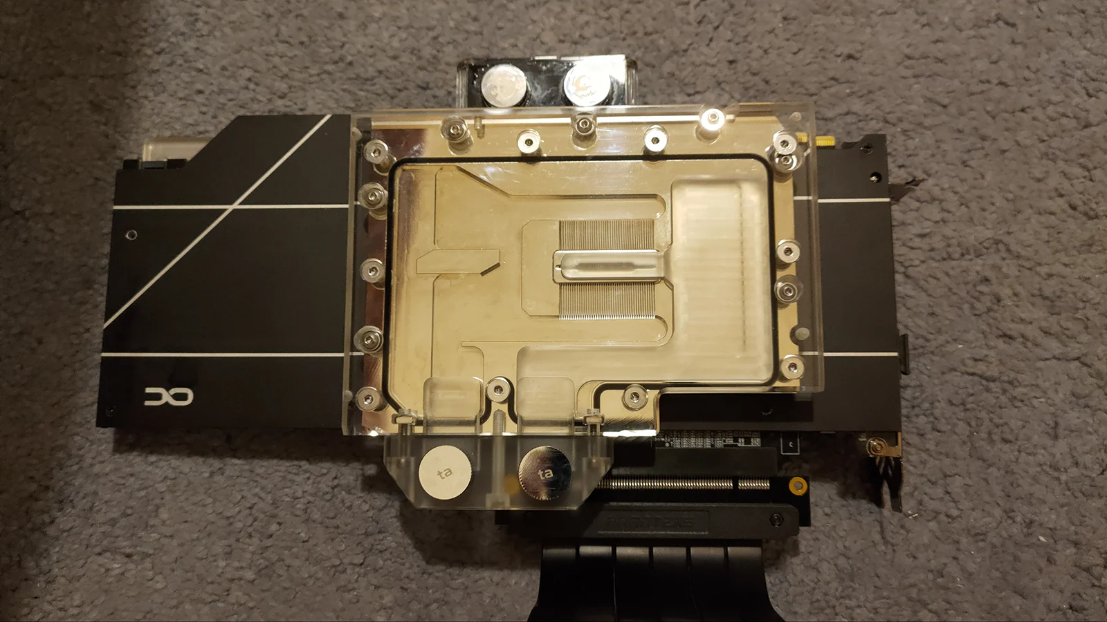

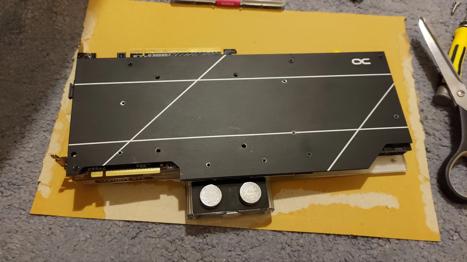

Those are 2.5mm thick nuts (M3) super glued to the back.
2.5mm thermal pads.
All padded up, thermal pasted and sorted.

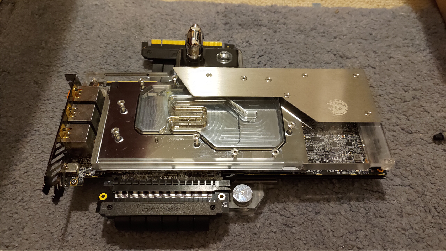

I then wasted about 30 minutes removing every nut from the block, only to find it won't come off. The alternative was too soul destroying (taking apart three hours of work) so see if you can figure it out. Amazingly just slushing some 99% isoprop in there cleaned all but the green stain. Good thing I am using yellow coolant really.
Worth a check of the acrylic part of the block as IPA can cause it to craze and even crack. It seems to be a cause of argument whether this is instant or after days of exposure. Worth a good rinse out with water just in case though!
I'm done caring mate. Seriously. It has been such a pain in the balls it can GTFO. It should only crack if it's extruded, and it doesn't appear to be.

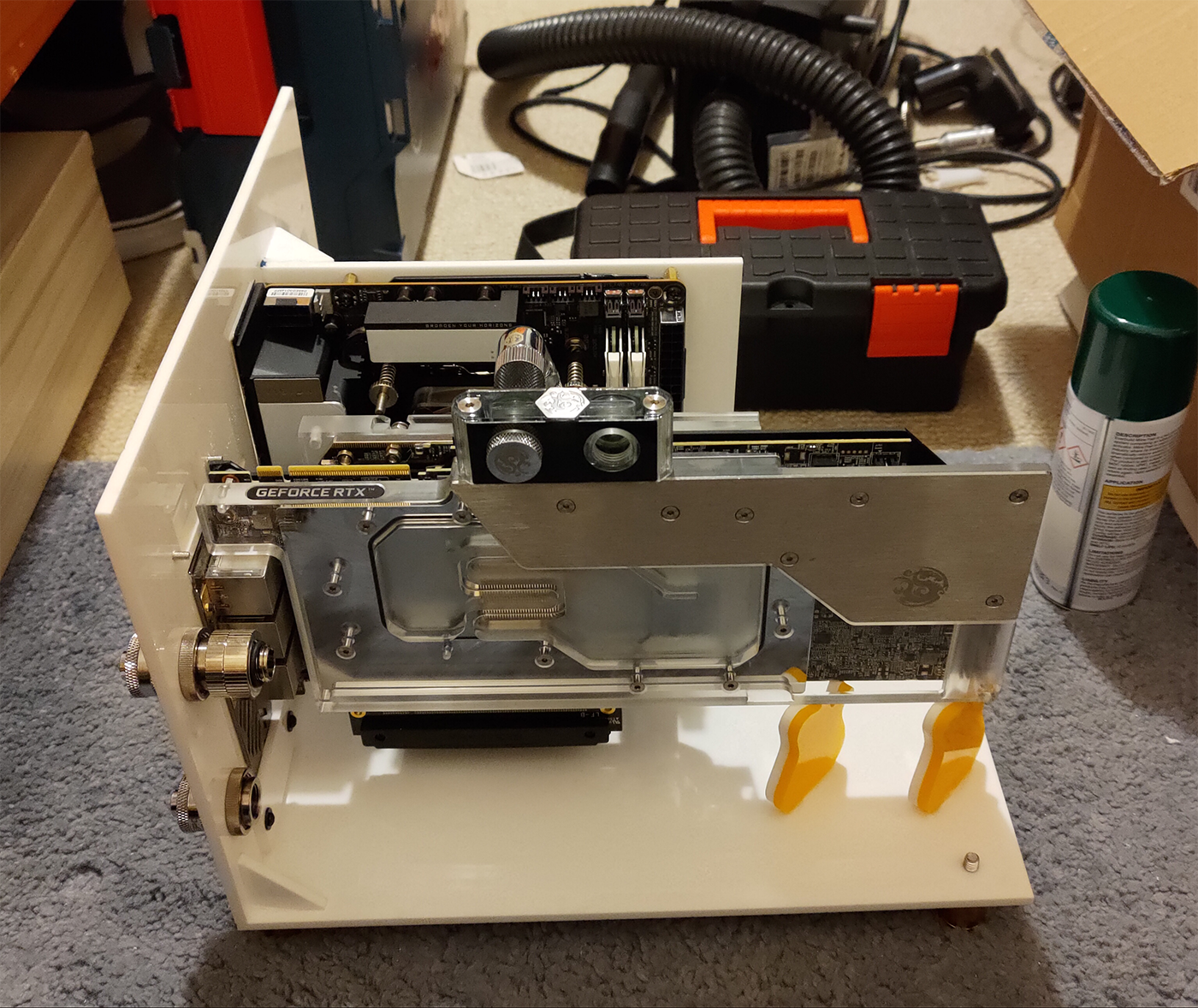

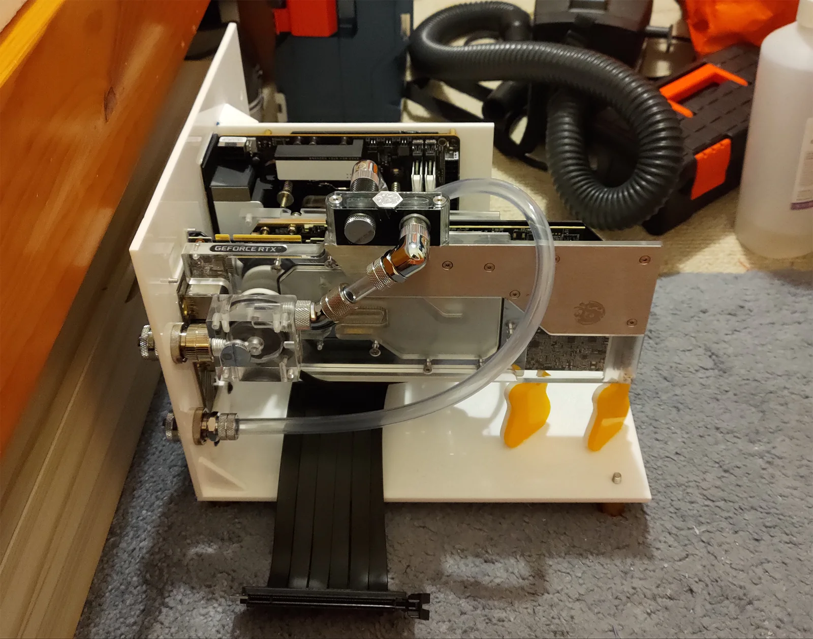

Why does everything of theirs seem to just be janky rubbish? So I fitted the GPU and stuck down the supports.

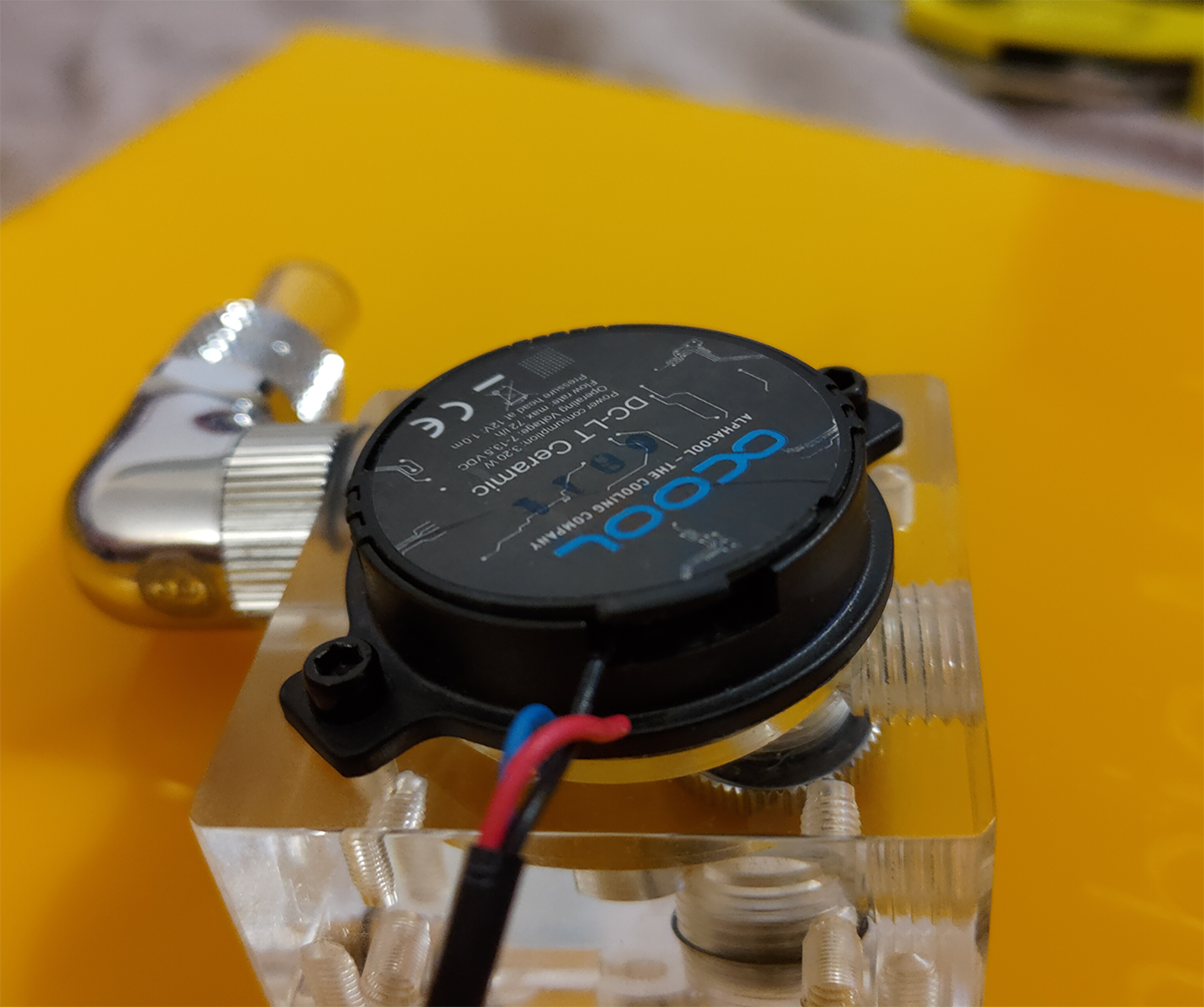

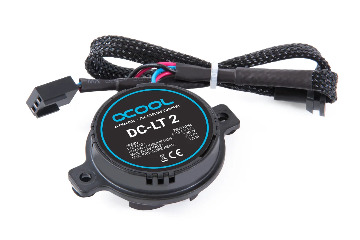

And it was all going really well until I picked up the Alphacool pump and two wires fell off.
"OK whatever, this has happened before just solder them back on".
Only it's close to impossible because not only did they put hot snot all over the solder points in some sort of desperate attempt for this not to happen but they then went ahead and plastic welded the bottom on so you can't get it off for access.

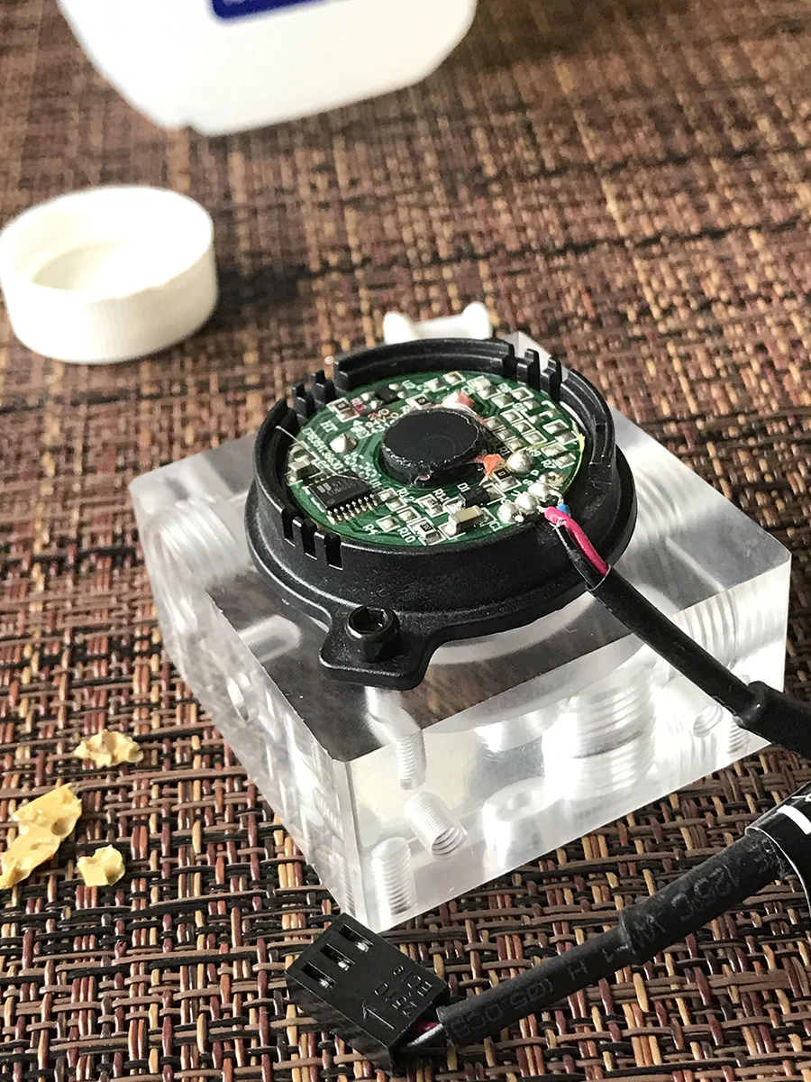

OK so it seems this is a very common problem. Most likely because the cable stopper is just floating in air and no hook to put it on on their own pump top lol. Who designs this stuff?
I always thought that was really really stupid. Why put a cable saver on there if it doesn't fit anything? like why even bother.

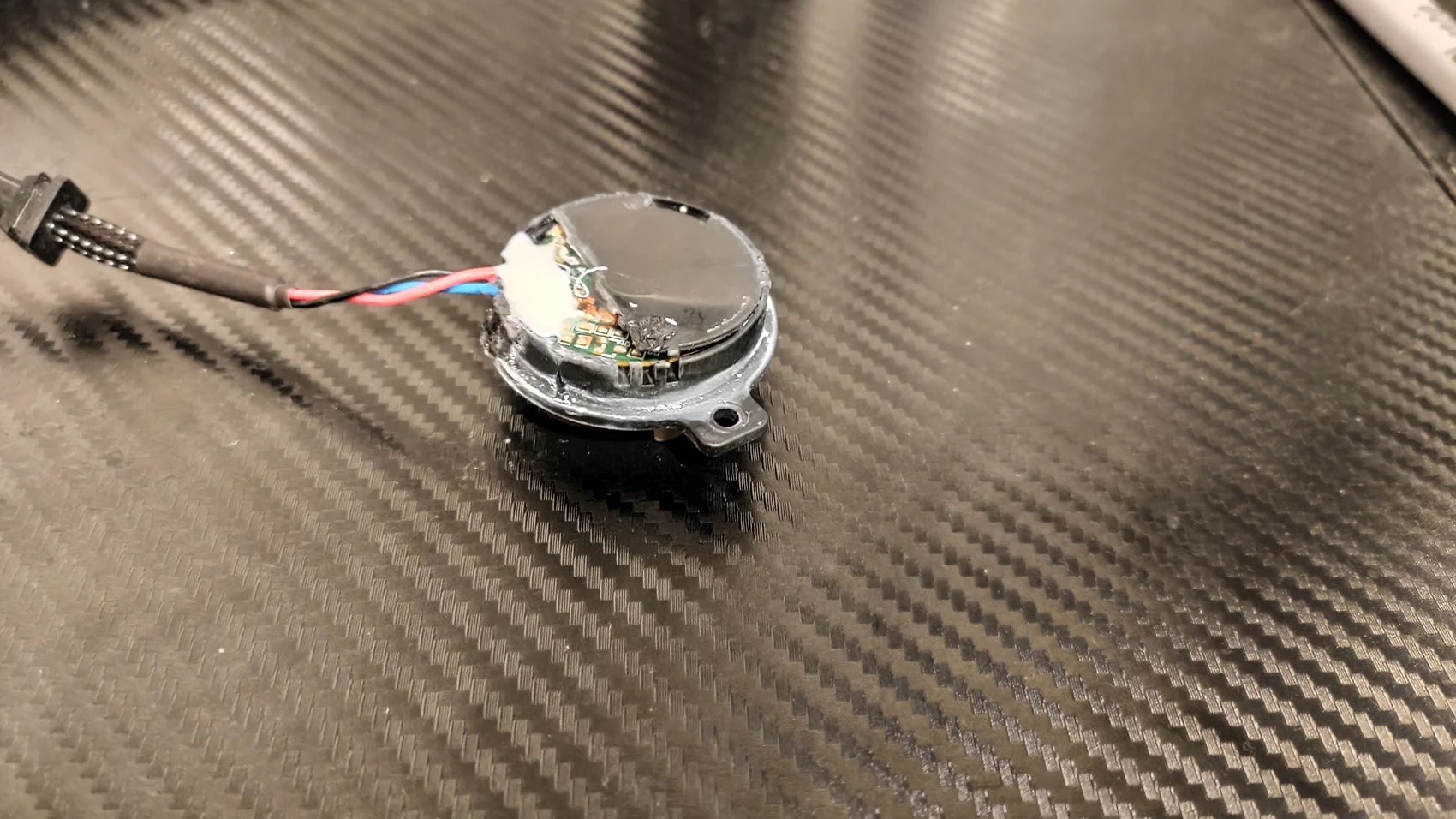

So I found this pic online.
He had to rip the entire back off the pump. Something I could not be F-ed to even attempt. I snipped it back for access, then began to try soldering it. Man, my eyes just ain't what they used to be. At all. I nearly binned it when the ground pad ripped and was literally hanging off, but hung in there and eventually got the wires on. Problem was I had to literally cast them and the PCB in superglue and activator to hold it all together.
I am not proud of this in any shape or form. It is the worst repair I have ever done, and the soldering is shameful. However, it works. So I put some liquid electrical tape over it and when that is dry tomorrow I will machine a new back for it out of white acrylic.
But if it goes again? it is game over. So I need to be even more gentle with it than I was before, because it's quite clearly crap.

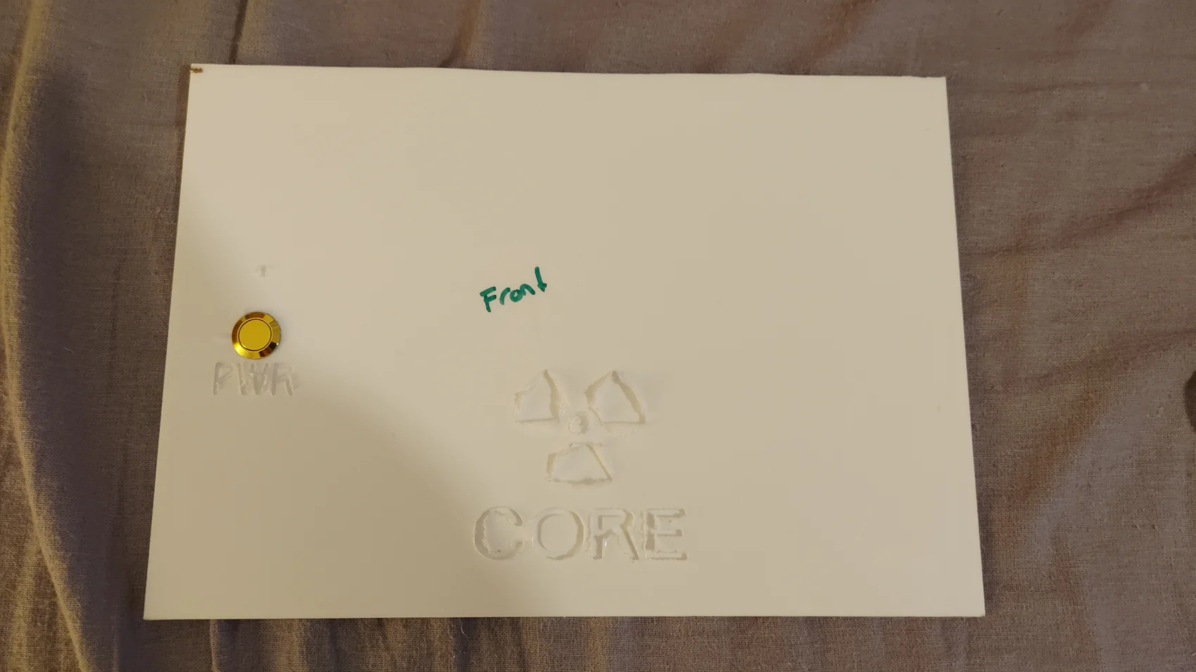

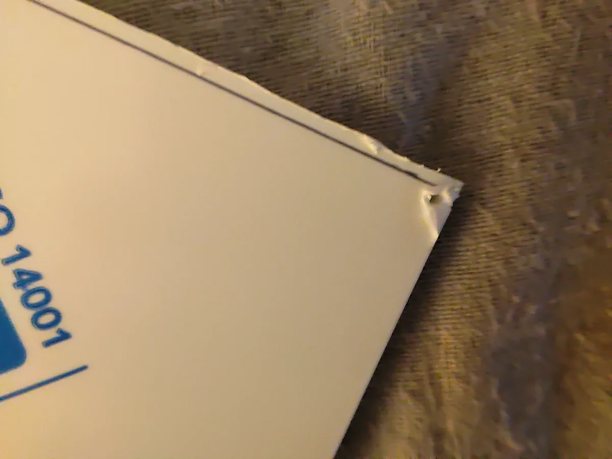

So yesterday I did some measuring and realised how badly off the top was. So I created a 1mm pocket line in Easel and used the machine to sort it. Now I can't complain too much because it seemed to work really well.

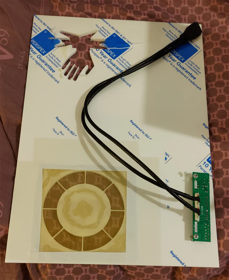

Unfortunately that was where yesterday's good points all ended. I then attempted to cut the front and this happened.
The 1mm bit jammed completely but did not snap.
IDK where my head was, but the bit ended up in the same place. Oh OK so I do know where my head was I am gutted my uncle is dying and I couldn't get my head out of that space and into this one. So I tossed it aside thinking it was done for, and I would have to buy more acrylic/make a new one. Whatever.

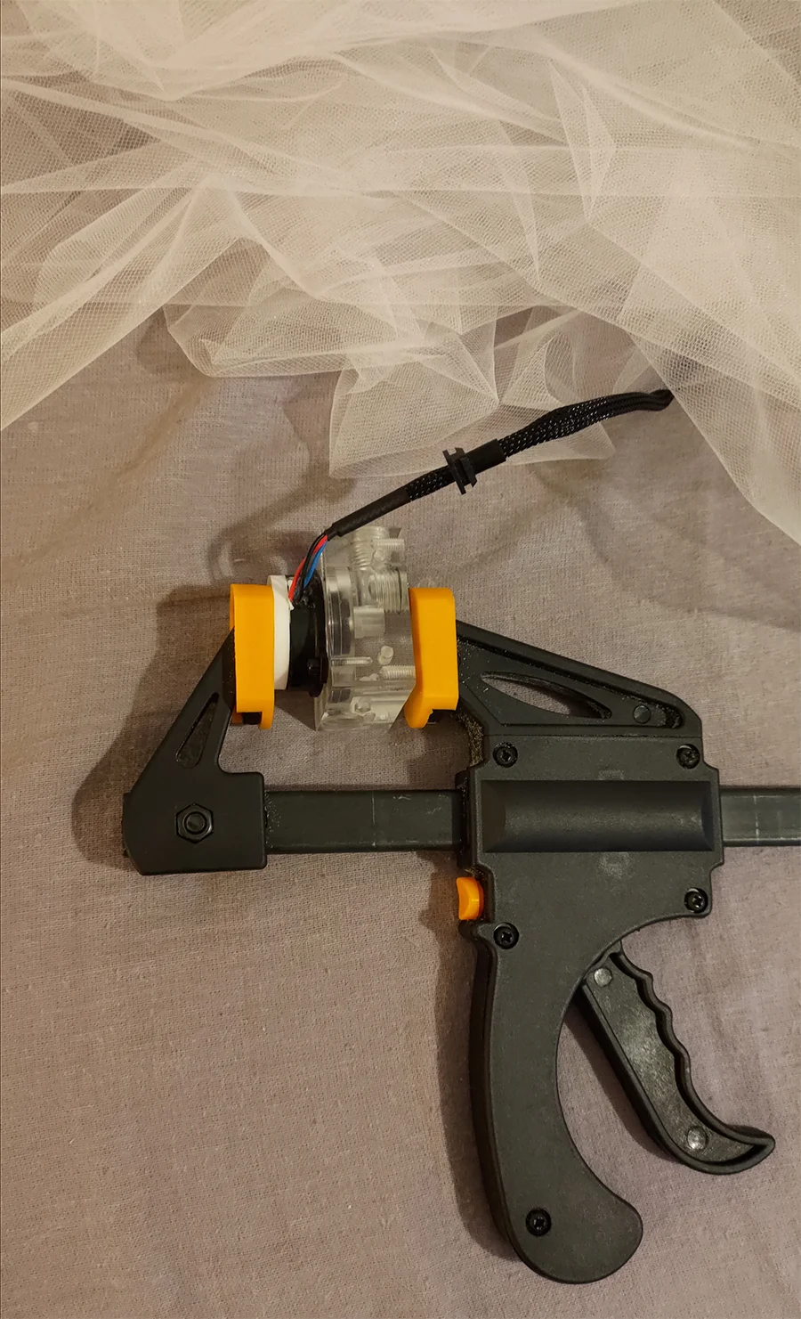

The pump is now repaired and the very slow setting glue is setting.
The mosquito netting you see there was purchased about a week back and arrived today. That will become the top filter for the case. Not that it overly needs one, as there are no fans in that part, but simply because I don't want crap falling in through the holes.

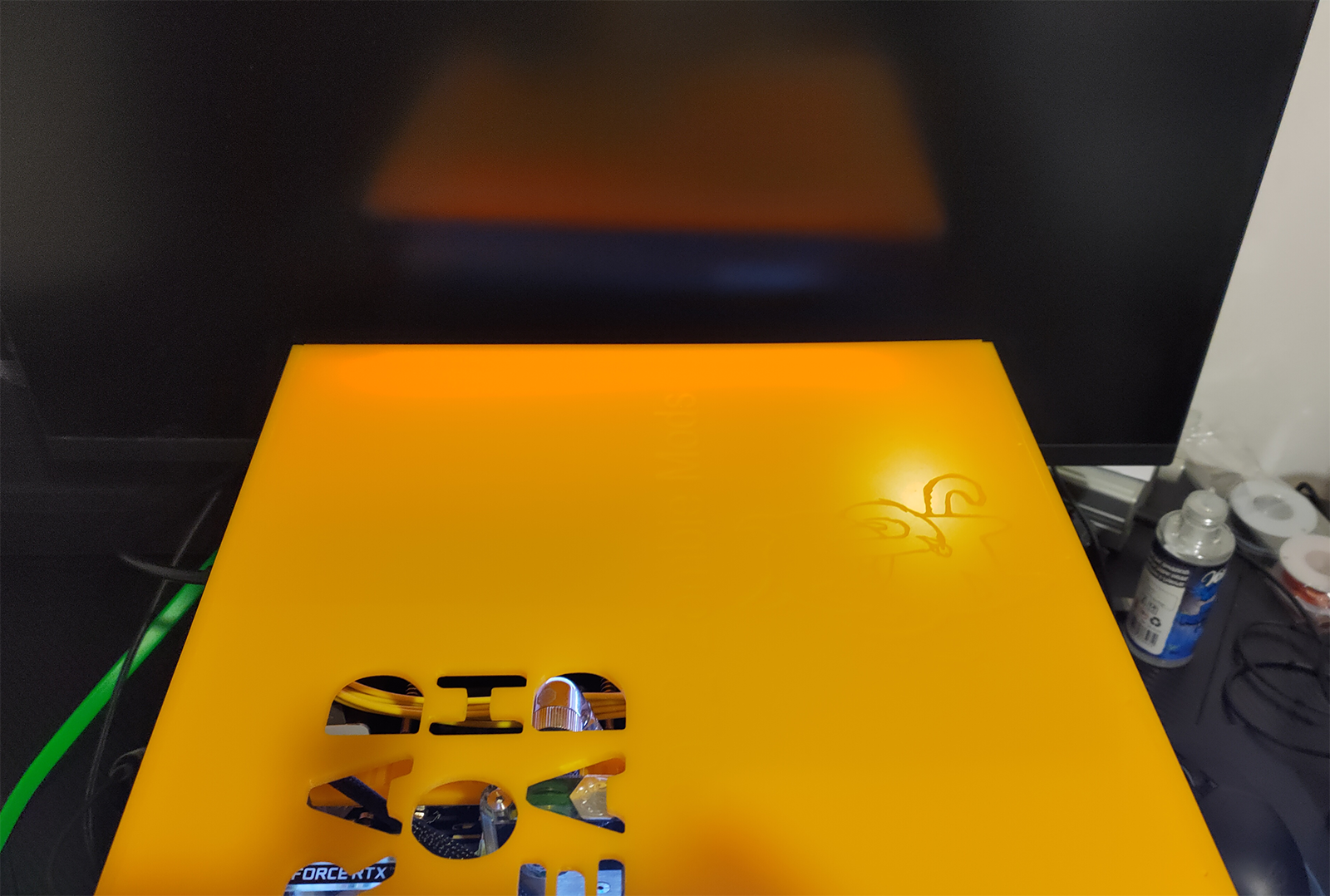

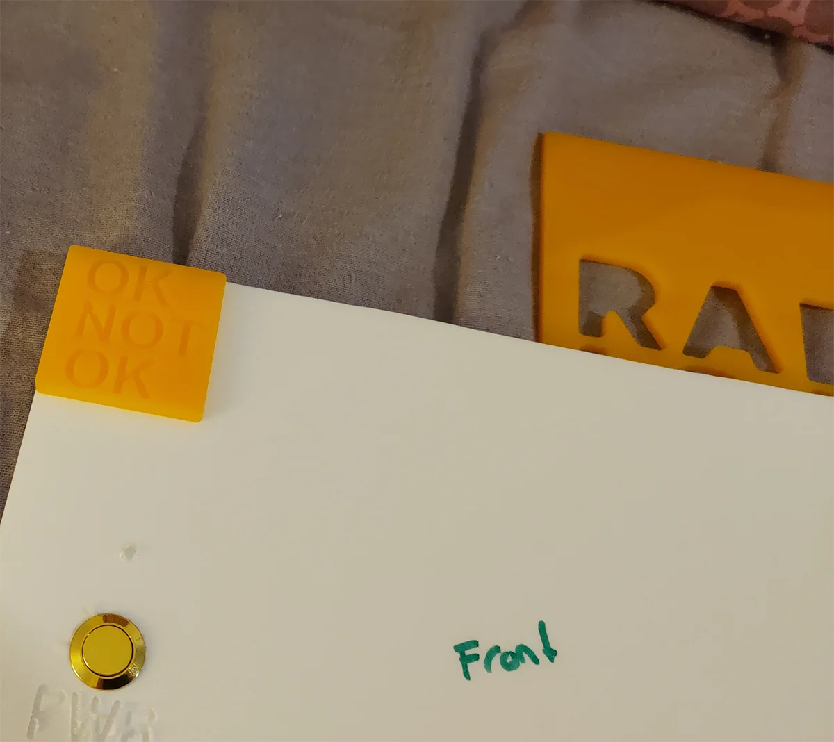

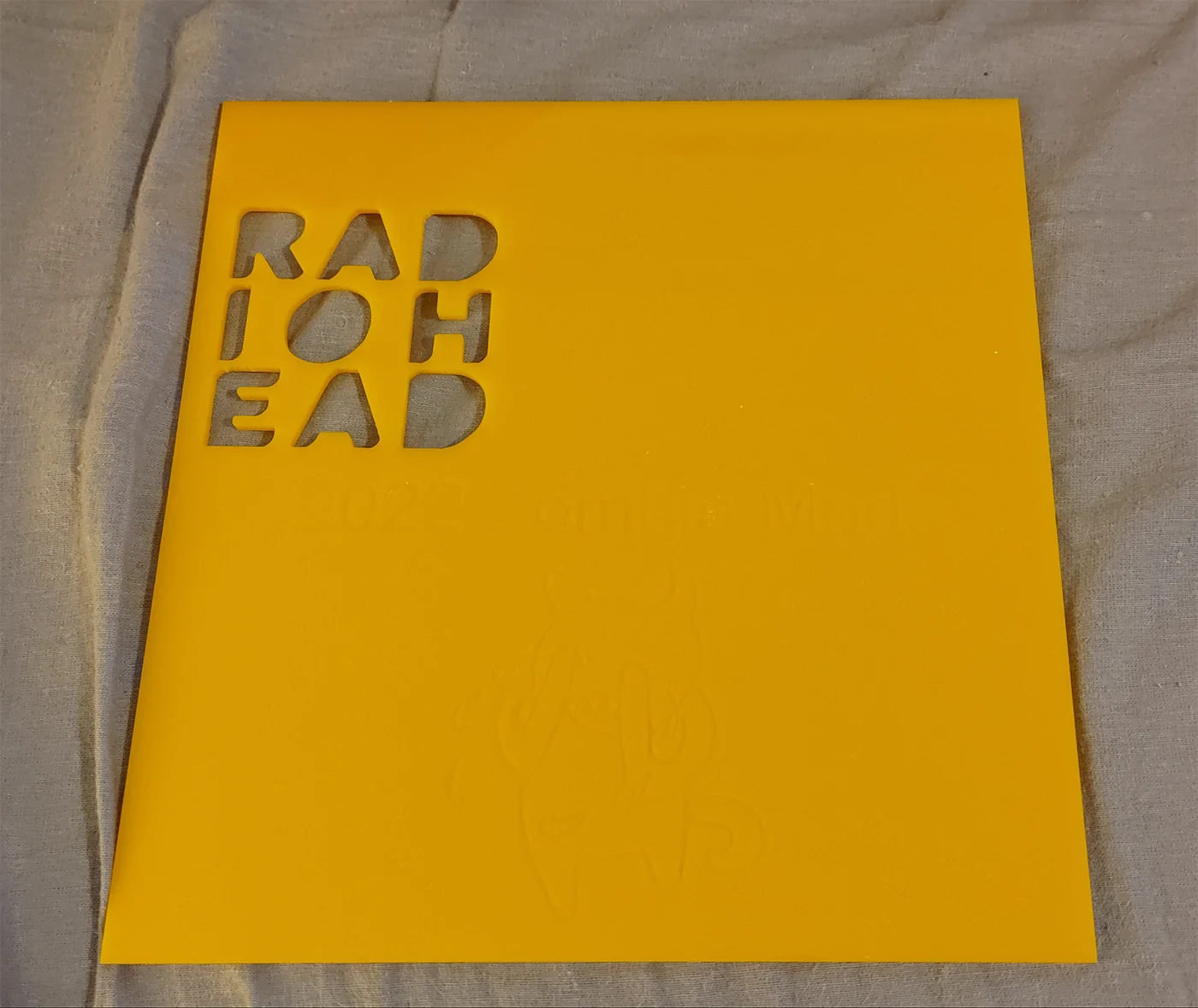

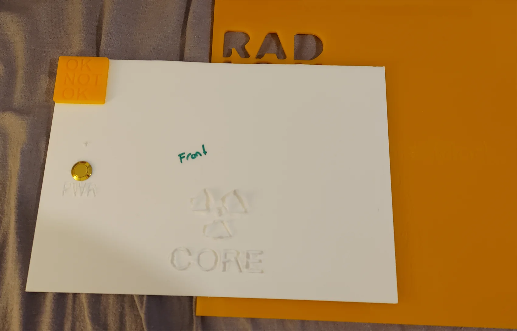

I came back in a better frame of mind, and decided to make lemonade out of yesterday's lemons. I remembered the last RH album I bought was "OK Computer" on vinyl, but remember finding out that the one you should buy is the "OKNOTOK" version, as it is three records and they are 180g vinyl.
Which just about sums up my mood right now, and looks rather pleasant.
That edge does still need to be cut, but my rotary tool is absolutely bloody awful so I will wait now until the one Gareth sent arrives. Later today I will solder up the power button and the paracord came so I will sort that and the power LED together and braid them both up in the yellow reflective.

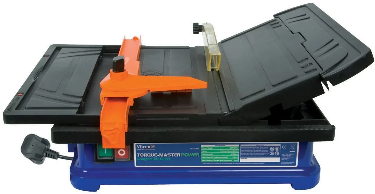

OK so I am tired of fretting over getting the pieces cut out and straight edges etc. What I need is a table saw. However, I need it on miniature scale. Then it dawned on me. Diamond coated bladed tile cutter, yes.
Which will be absolutely perfect for when I build my shed next year. Well, and for cutting out the remaining panels.

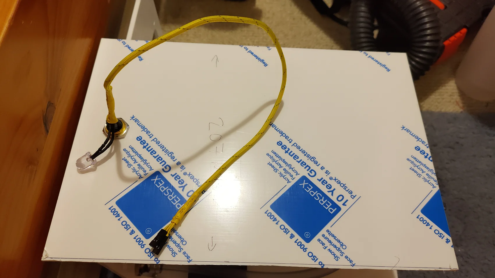

Update 32 - "Check out my ringhole...s".
Pervert. Of course I mean these ringholes.
Which are of course a really convoluted way to hold an LED.
Talking of which. Bit of fine work, some soldering and braiding and this part is done.
The loop is now complete.
But was a total sacrifice of my sanity.

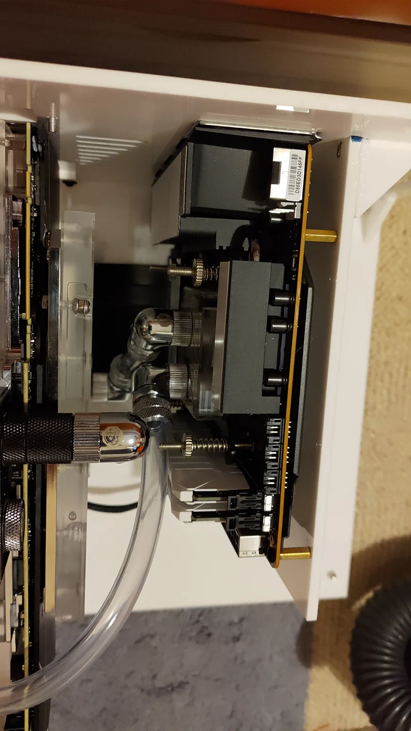

Ever tried holding a nearly 5 kilo GPU one handed whilst trying to do a loop with the other? thought not.
No, but I have tried holding nearly 2 kilo of GPU one handed whilst measuring floor clearance with the other...
...which resulted in this
