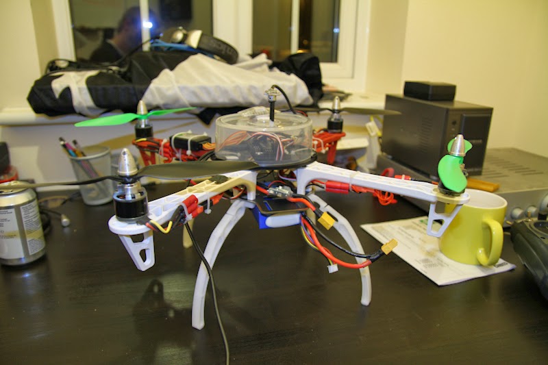

Here's a crash test just to prove it;
No damage except to my pride :-)
Looks like it's the APM in the CD spindle case.
Nice one howler, looks a tidy build. Are you using 4mm HXT bullet connectors for the ESCs?
