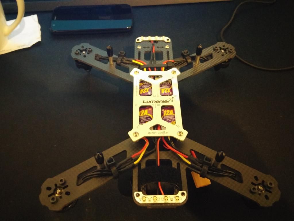

Hobby king order should be with me today. I am Looking forward to getting this built and dive into all the settings. I started mounting the ESC's and motors to the frame yesterday ready for the radio gear and flight controller so it is starting to take shape :D
That looks a ton of fun, can I ask what size battery's you guys use and flight times ?
I use 1500mah zippy compacts and get about 8/9 minutes but I'm not flying at full chat all the time
The other guy was using 1300mah nano-tech batteries and I think got around 7 minutes on them
