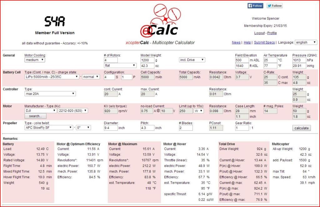

Ok, so assuming an all up weight of around 1200g including the battery, a 5000mah, 4s, 25c battery should give you between 13 and 19 minutes of flying time according to xcoptercalc.
25c should be sufficient for your needs.
I'd go Zippy or Nanotech.
I'm just making educated guesses though without a good idea of weight.
