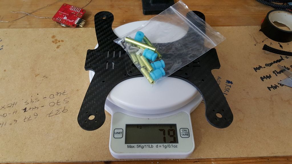

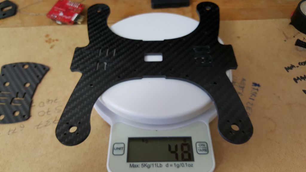

Bare frame - not sure how accurate my scales are! Finish looks pretty good, nice and matt.
with hardware
I'm fairly confident I can use the shorter supplied standoffs and still cram everything in if I remove the headers from the naze and solder the motors/rx direct to the board. Not using OSD or telemetry, so no need of other pins.

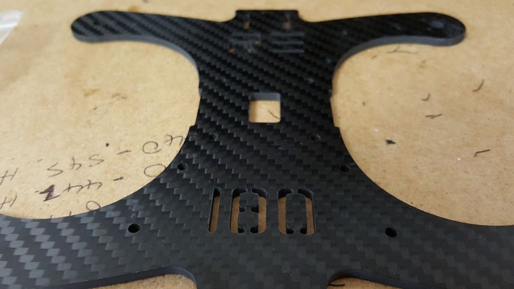

Got mail today :) Wish I picked a better frame after looking at the one I got though :(
It will be fine. And if you love the 250 then you can always grab a better/different/worse one when you have more of an idea of how/where/when you fly. e.g. if you like bonkers speed runs in open spaces then you will need a frame that can handle heavy impacts and carry larger motors and batteries. If you only fly in small spaces during your lunch hour, you could get a smaller 180mm frame. Most of the components will be transferable (unless you break them!)

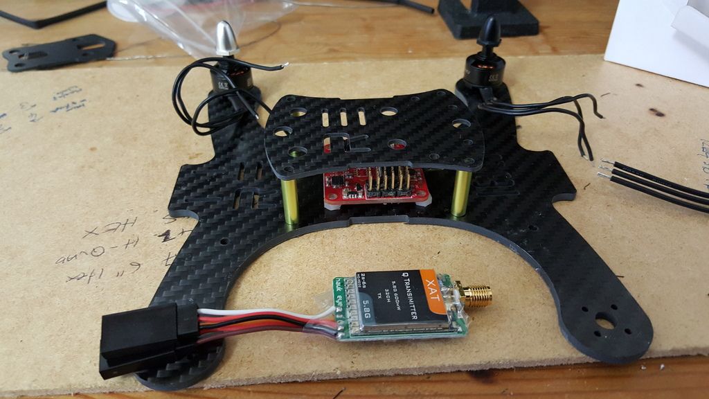

little bit more completed
Too tired to do much else, annoyingly. GF seems to have funny ideas about gardening and social contact too, which is holding things up.

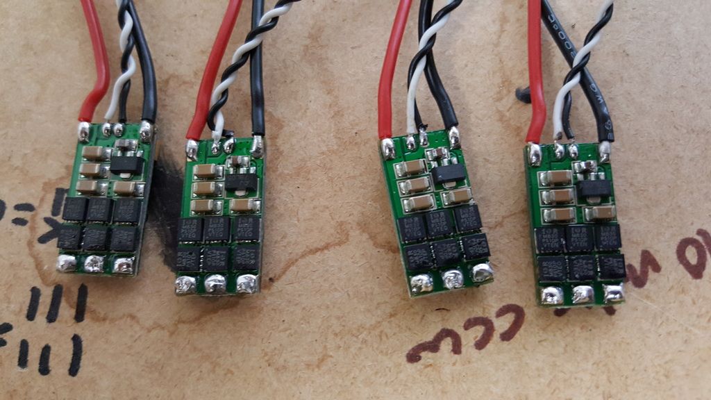

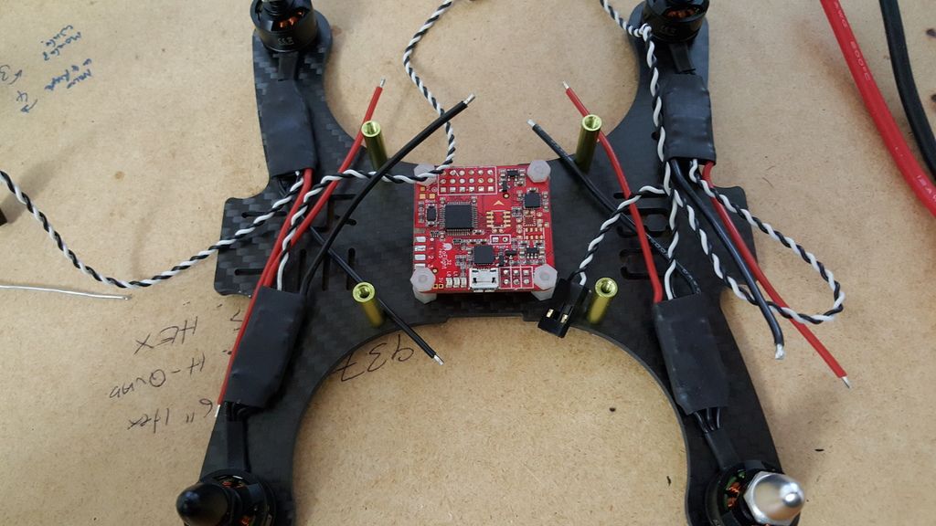

Just soldered the motor wires to the ESC's and heatshrinked them up. Also started planning out the power cables. My initial plan was to run them under the naze along with the rx, but I think it's going to be a bit tight, so I will probably lower the FC a bit and have the 5v step underneath and the rx on top. It will all fit in the shortened tower.
Why has no-one designed an integrated PDB/Naze/OSD/rx/vtx board yet? Or even 2 boards that stack via pins to give modularity/options!

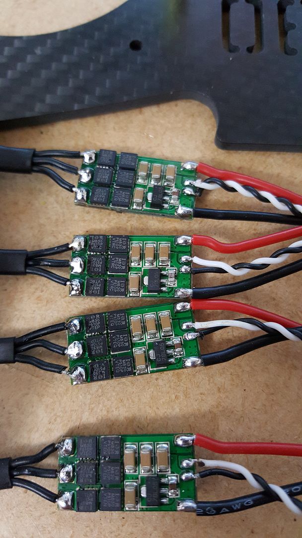

Motors soldered direct to the ESC. These are still wire, even down this close to the motor, so no problem with soldering!
And heatshrinked and installed. I'm going to heatshrink them onto the arms as well. I'm in two minds what to do about the signal/ground leads. On one hand I want to cut them to length to keep things tidy but I would also like to be able flash and fiddle with BLheli if I need to. Decisions, decisions.....

Gandhi, get that heatshrink off again and shorten the ESC signal/gnd wire at the ESC lol. That way you can keep the servo connector in place and lose the excess wire
Lol, why didn't I think of that!
I did consider soldering a couple of pins onto the ESC board so I could create all sorts of heatshrink-based hell for myself when it came to reflash/tweak settings but that is a much better solution.
This is what happens when you try do things too late at night maybe. Thank you :)
