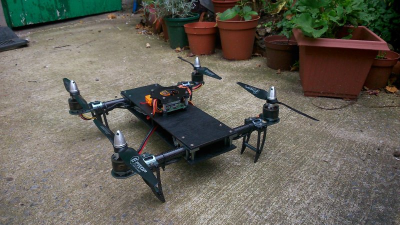

Still working on the custom Hcopter,done the power distribution,got the motors in place.

That looks great,what did you use to cut them out and whats with the feet:D
A diamond cutting wheel and a sanding drum on a rotary tool, makes a hell of a mess :p (IE wear goggles and a mask! and overalls!)
Oh and feet, my United slippers were in the wash :D

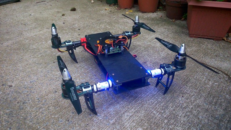

Lights installed along with velcro for battery.
Took her out this morning in 10 mph winds,heres the results:
Full out acro flying.
Propellers graupner 8x5
4s 5000 mah battery = 17 mins
3s 3700 mah battery = 11 mins
Frame weight:
Bare = 800g
3s battery = 1100g
4s battery = 1400g
She flies like a little rocket on 4s,very pleased with the flying times and she will take 9x5 props easily so hope to push for 20 minutes
