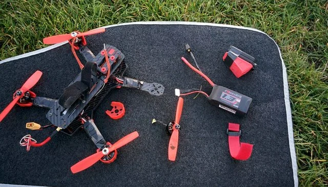

Just to give you an idea, one of my motors shook loose last night, so in turn it ripped itself off the ESC, put the quad into a spin, after it hit the floor the battery ripped one of it's cables out of the XT-60 plug...Oh and all four props are bent.
So you can see why you need spares!
