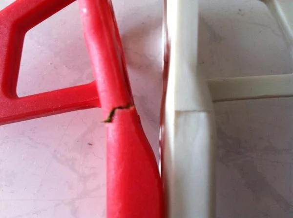

the cost the dji is not worth it as a whole new frame cost 9.79 + postage from hobby king
Yeah but the HK arms are garbage, I've broken quite a few, two from falling about 1.5m into 1m high long grass on seperate occasions. They always break where the flat motor mounting area meets the bulk of the arm as it's a weak point, the genuine DJI arms are much stronger at that point and take a lot more abuse.

This is what I mean...
Hobby King on the left and genuine DJI onthe right, there's a big difference in the amount of material and cross sectional area at the point of breakage.
