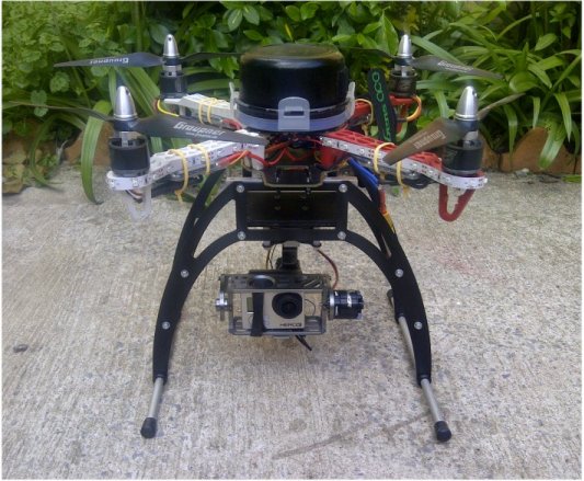

Heres my Dji 330 with brushless gimbal and quadframe landing legs and a £1 tub from the bargain shop on top

Give us your spec ie which battery, motors and props you are using
On that one:
Frame Dji 330
Motors = Ntm 1200 kv
Esc = hobbyking blue 30 amp (simonk flashed)
Props = graupner 9x5
battery = zippy compact 5000 mah 4s
Rctimer gimbal & gopro
Quadframes us landing gear
flight time = 14 mins.
Its a great little video rig.
