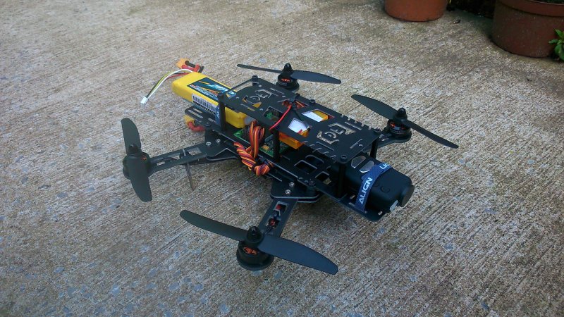

I've got some G10 sheets left over from the Tri I built so I was looking at going that way with a quad. Would a 250 size be too small for me? Not flown a quad before. Can't be no more difficult than a Tri / Heli? Has to be some plans on RCGROUPS for a decent 250 frame?
The Drq 250 is pretty nice,better price than the Blackout and Qav.
Heres mine:
Take a look at the website,its a great frame for the price compared to the others.
http://droneframes.com/shop/index.php?id_product=30&controller=product

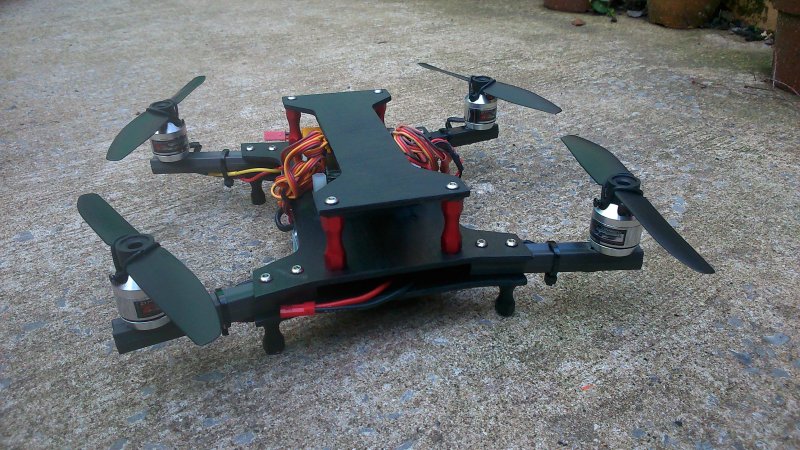

Heres my Diy 250mm frame using plywood and 10mm x 10mm carbon fibre square tubes for arms.
Designed it in libre cad,printed onto some cardboard then taped it to the plywood and used a
dremel to cut the shape out.
Liking that DIY Wooden frame pazza! Very tidy. Would be easy to forget that's just made of wood with the paint job. What motor/prop combo is that on there?

Im using these motors:Turnigy Aerodrive SK3 - 2122-2100kv Brushless Outrunner Motor
http://www.hobbyking.com/hobbyking/store/uh_viewItem.asp?idProduct=36817
There really powerfull,can carry a 3700 mah 3s battery and still hover at 50%,the battery is almost as big as the frame.
The only thing i dont like is the old rubber prop savers,but so far havent had any problems at all with them.
She flies just as good as the more expensive frames and cost around £8 to build.
