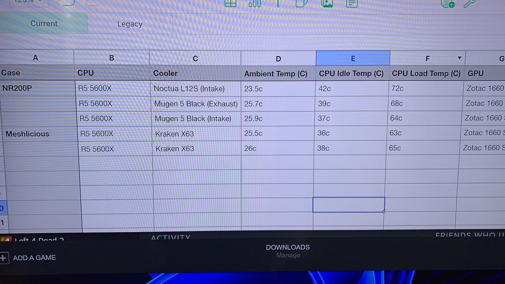

That was my old setup. Switched to the setup in my sig now. Board I had back then was a msi b450 of some form, can't recall the exact model.What motherboard are you using? And are those dimensions Height X Width or Width X Height?
