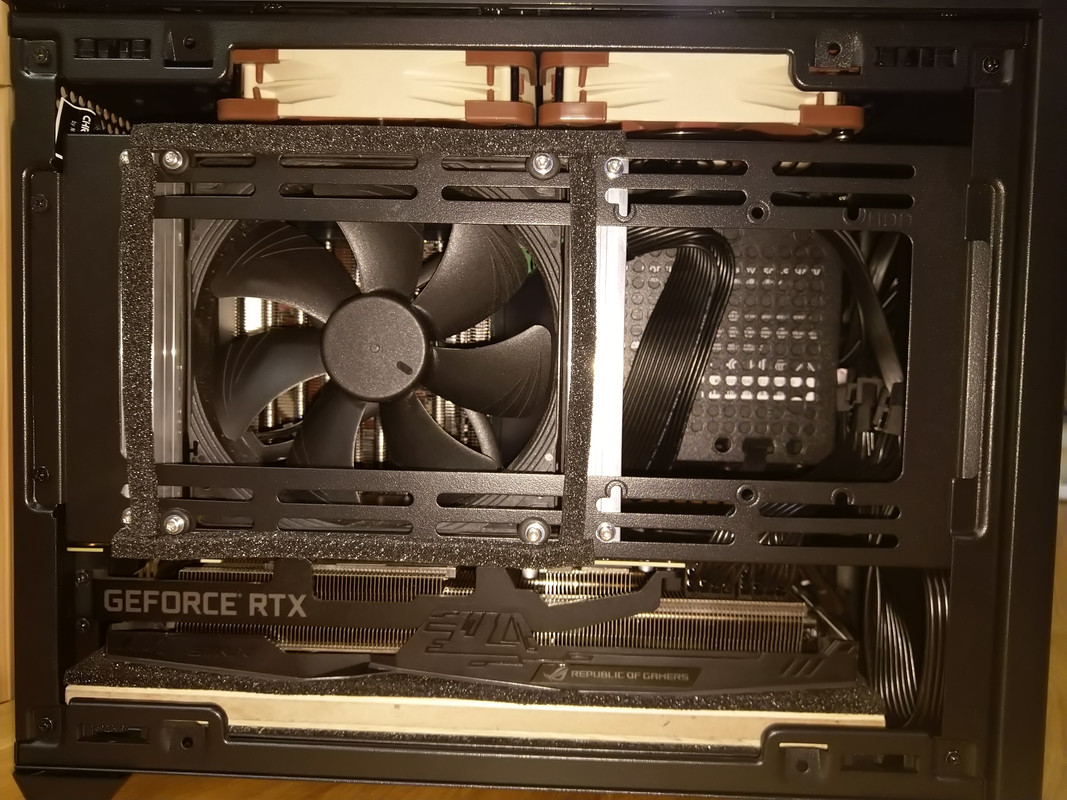

My build:
CPU: 10600k cooled with the Alpenfön black ridge using a 140mm fan and a homemade duct to step down to 120mm size of the cooler. The CPU/MOBO gets cool air directly from the outside (side of the case).
GPU: 2080ti ROG strix, resting on yet another home made "air duct" (roughly 20mm) that ensures only cool air form the bottom of the case is sucked in by the fans.
PSU: Cooler Master sff 850w v2.
I will test the temps soon, and post a picture.
10600k @ 80°C during CinebR23 (22°C ambient) with the Alpenfön BR and a 140mm Noctua fan. Not great, but the cooler has a somewhat limited cooling potensial.
The GPU (ASUS rog strix 2080ti) tops out at 61°C during stress testing with Time Spy.
G4DcGS55
The duct is made from a piece of plastic sheet, stepping down from 140 to 120mm
Changing the fan to the Arctic P14 with higher static pressure shaved off 2°C on the Cinebench R23 test.
